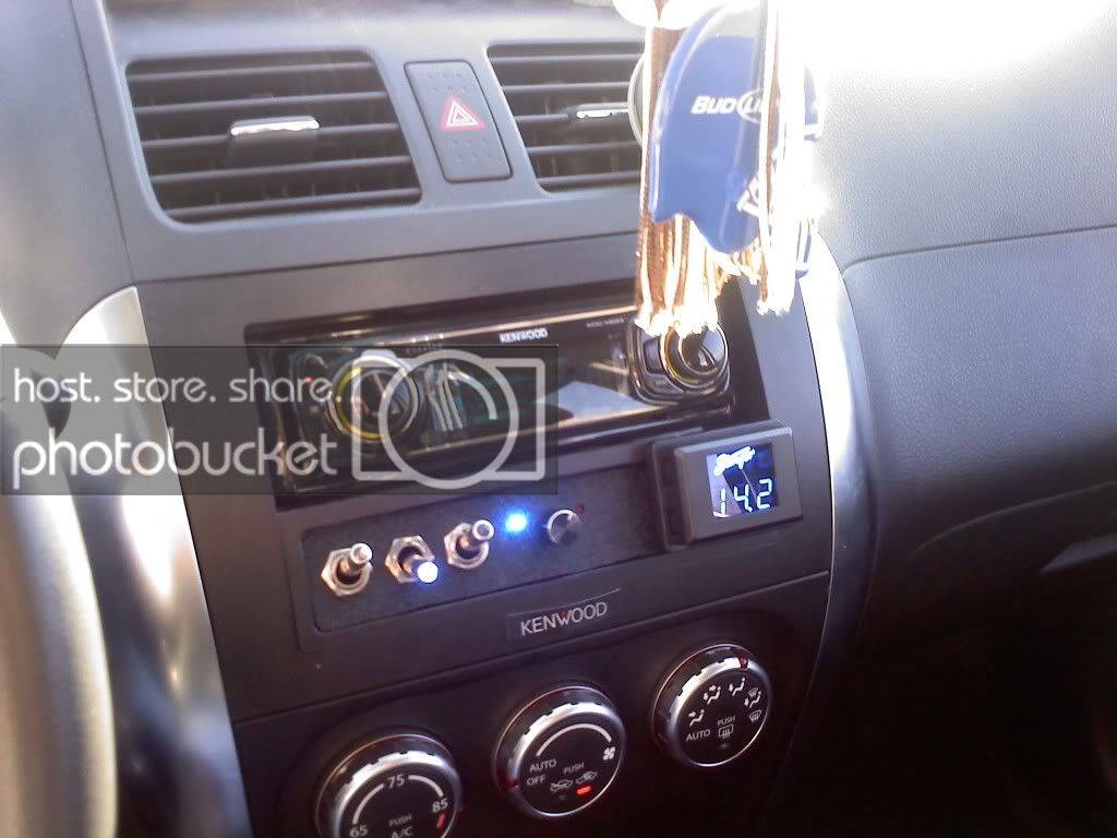

I like it. Kinda off topic...but i have an almost identical toggle bank in my dash ha. Except mine are 2 volt meters, and then fan. the mono killswitch is hidden.
