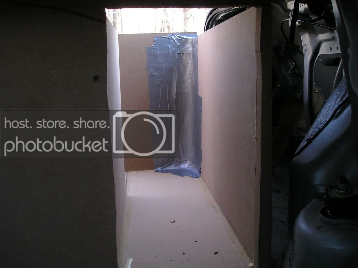

Here they are. Just need to put the top on after my sub comes in on the 24th. **** fedex held it for two days.

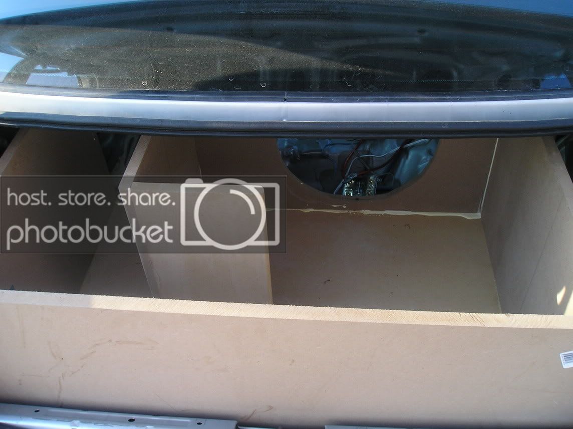

i'll be honest and say it looks like crap as well, but i know the difficulties of building a box in the trunk, thus i feel your pain.
BUT, you're joints(meaning the cuts) could have been better. An easy way to do it is prefit the box together outside of the trunk and drill all the holes you need, then when you put the pieces in the trunk all you have to do is glue the boards together and feed the screws through the pre-drilled holes.

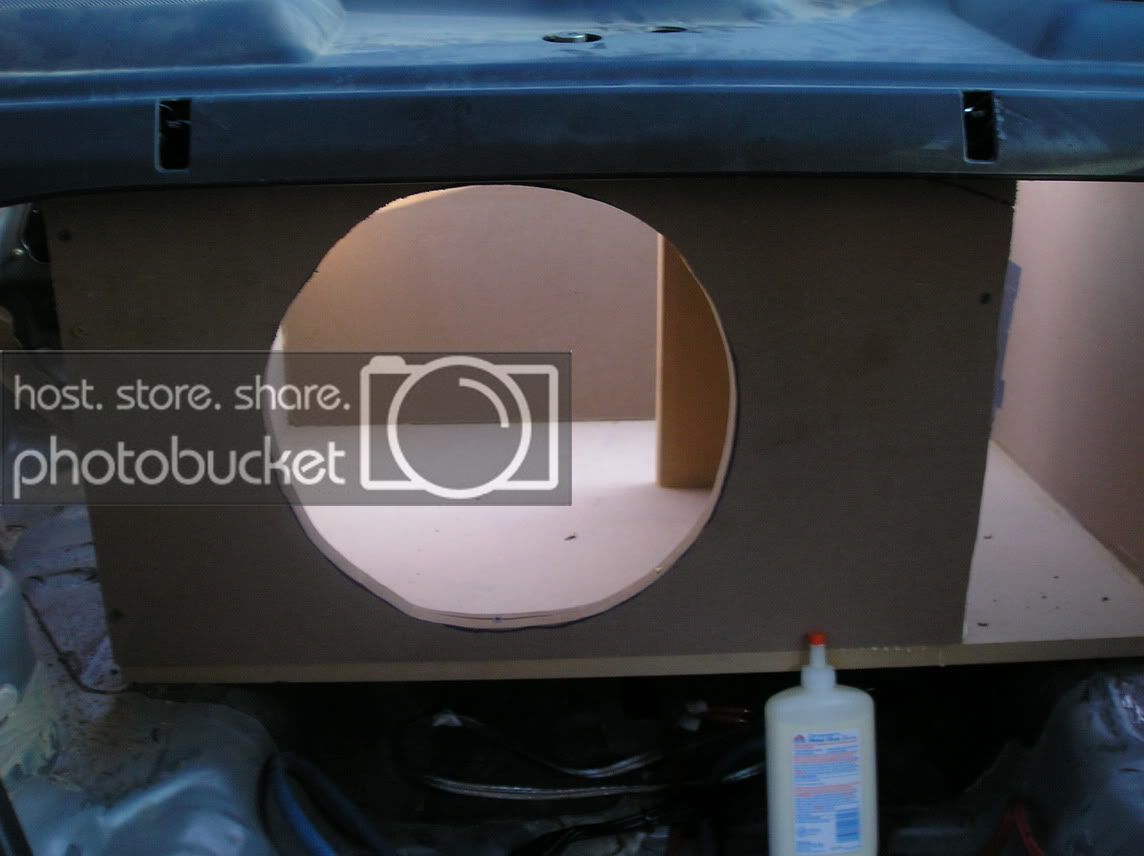

I have to finish up the front of the port....
I dont know if you understand how small a civic trunk is. The entire thing had to be assembled inside.
If you see that slash on the front baffle, thats where the **** circular saw popped outta track and almost cut me in the thigh. I dont even want to go get another piece of wood though since its on on the surface really.

Do you know what the duct tape is for? Its not there to seal it or whatever, its there to create a smoother curve, and make the air more linear.
Who looks out the cutout? I made it at 14", because I dont know how big it wil be for an MT. The tighter the better. I didnt know people could see the cutout for the sub on boxes now....
