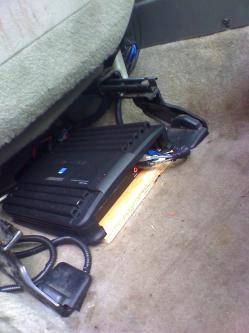

I just mounted mine to a piece of wood

Accidents happen-how about a soda being spilt/coffee/tea/water/???Candy chips/ onion rings???Ect.I dont recommend placing any amp under any front seats at all-Heat as well..that amp mounted on the wood thing??I suggest that if thats the way you are going to mount it..just place the wood under the feet of the amp,not the whole amp,and let some air circulation get around it..#1 reason right there folks that amps go bad/burn up-no air circulation/mounted flat against carpet/on a pounding sub box ruining the internals ect.You have a hudge vehicle with several places to place that 1 amp??I could understand if you were in a 2seater coupe.But I recommend another place to anyone..put that amp in the back away from everyone,and all.Take another look.My opinion to you,and highly suggest!!!
