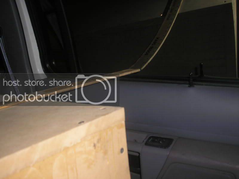

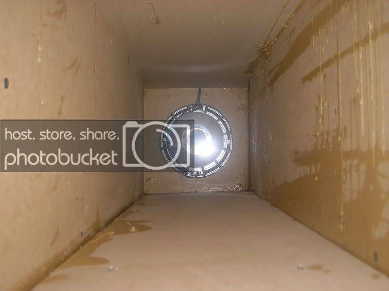

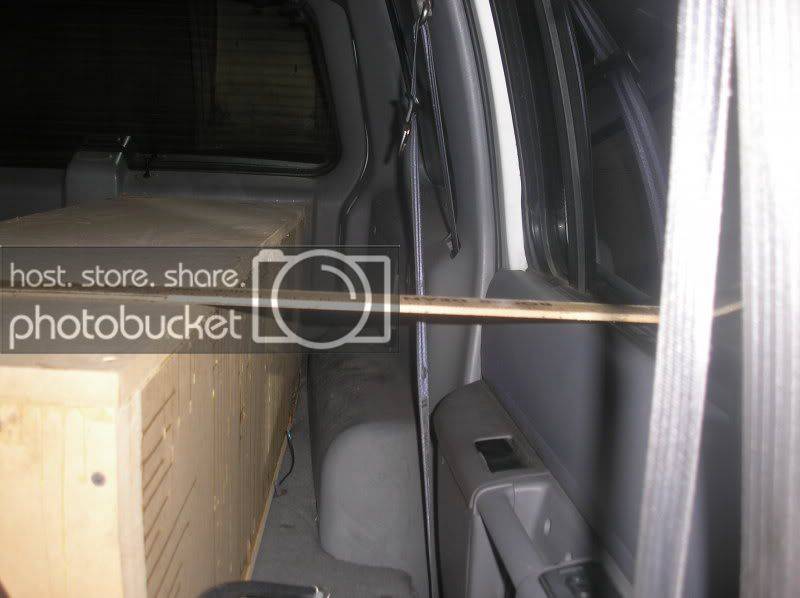

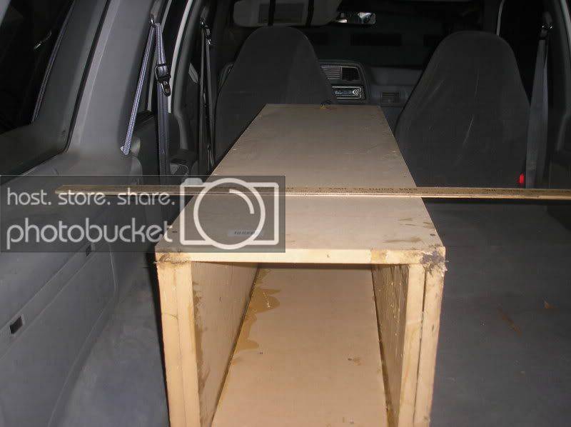

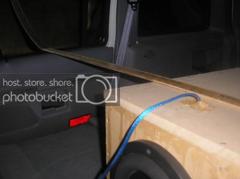

here are pics. an identical enclosure is going next to it tommorow, each speaker is a 10".
whats inside

No, it states that it can't be above the side windows either...
