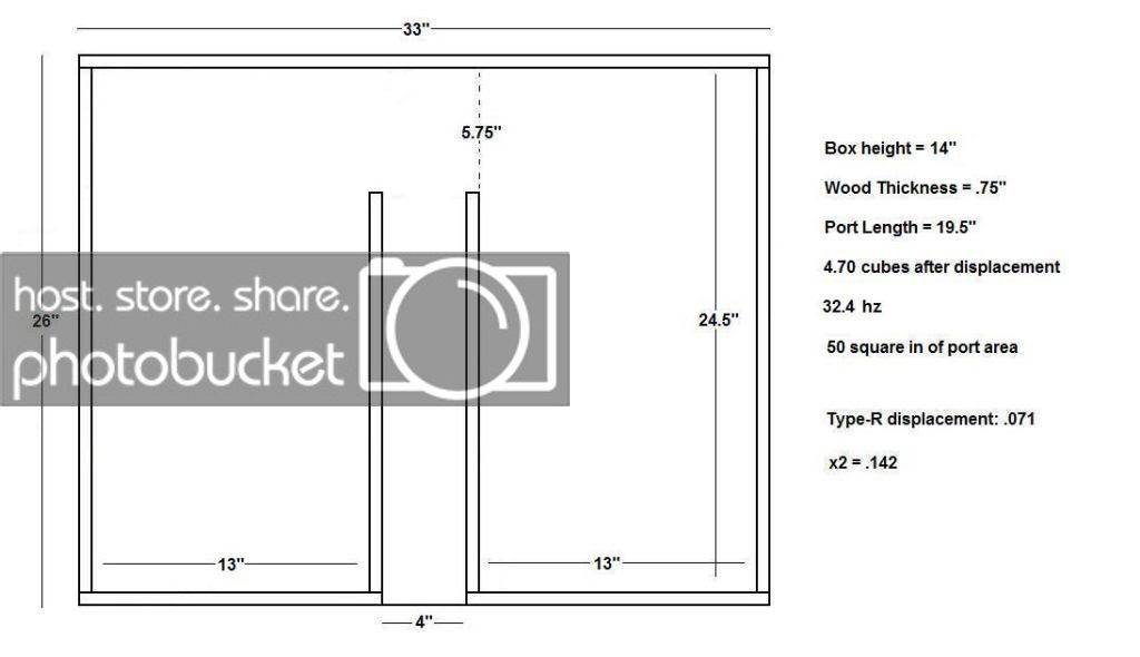

On a different forum someone told me that Alpine Type-R's don't sound good in a shared chamber box and that I should make my box 2 seperate chambers. Is this true at all?? I don't see why it would be. It makes no sense. But if it's true, i need to know.
I would make two boxes for that mustang. Ive done 2 12's in a mustang and two boxes worked out better than one, two that screw together once in the car. And type rs love big boxes. at least 2.25 each NET
I don't think that it is physically possible to get a box in there with more airspace than the one i'm gonna build.
And hey I see you're from madison. I'm from Sun Prairie
I personally like a separate chamber box because it also adds a bit more bracing than a shared space box. For what it's worth.
true, but with the port in the middle like i'm gonna do, it braces it pretty good
