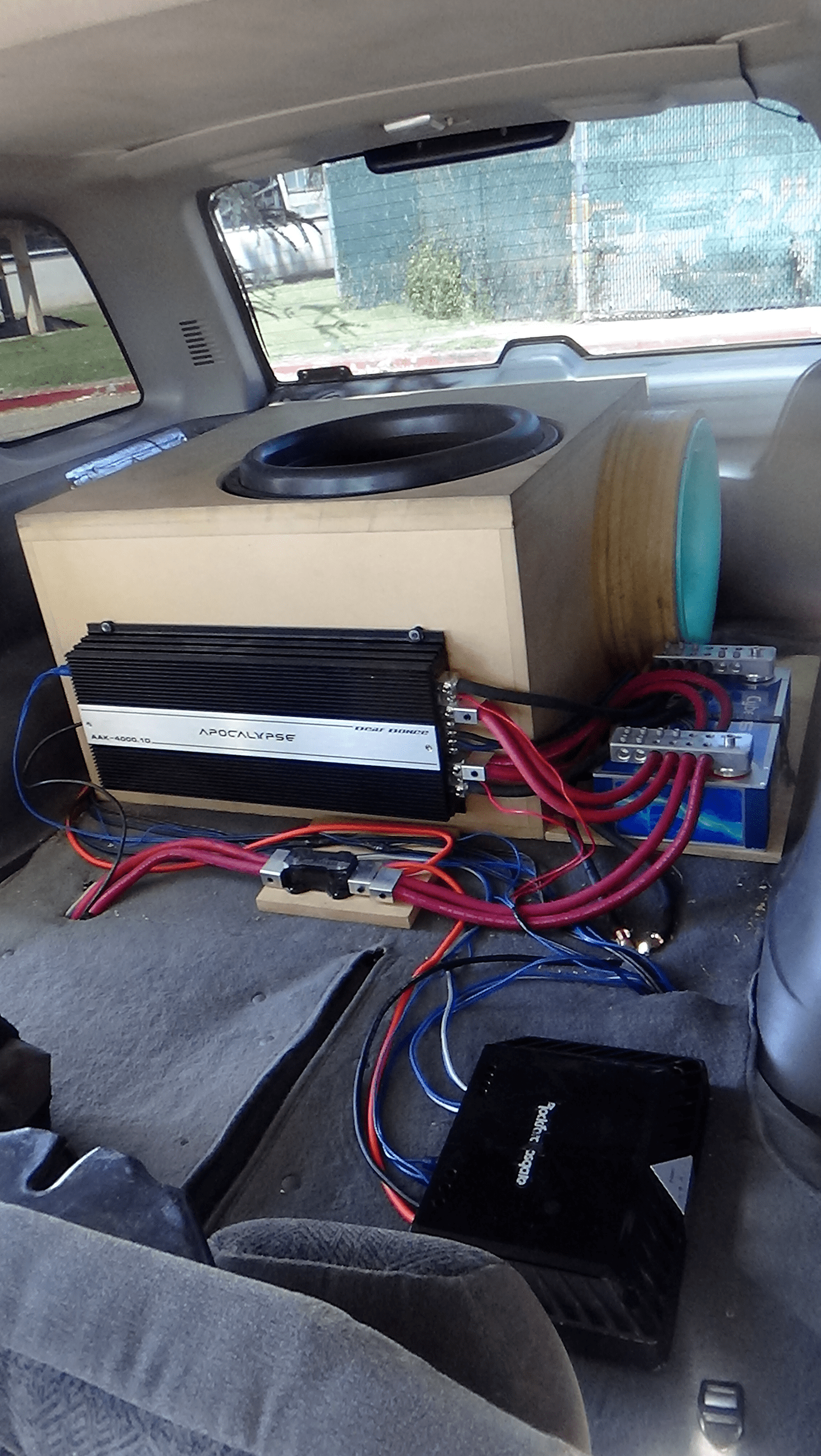

I suppose I drew some attention...
22212
Nice! Looks neat and simple, see that's why I was wondering if i should have went with the dd redline 800.....cause its the 9500 motor with 4" coils....i know id have slightly less cone area, but the box would've been half the size needed for these two 9500's
