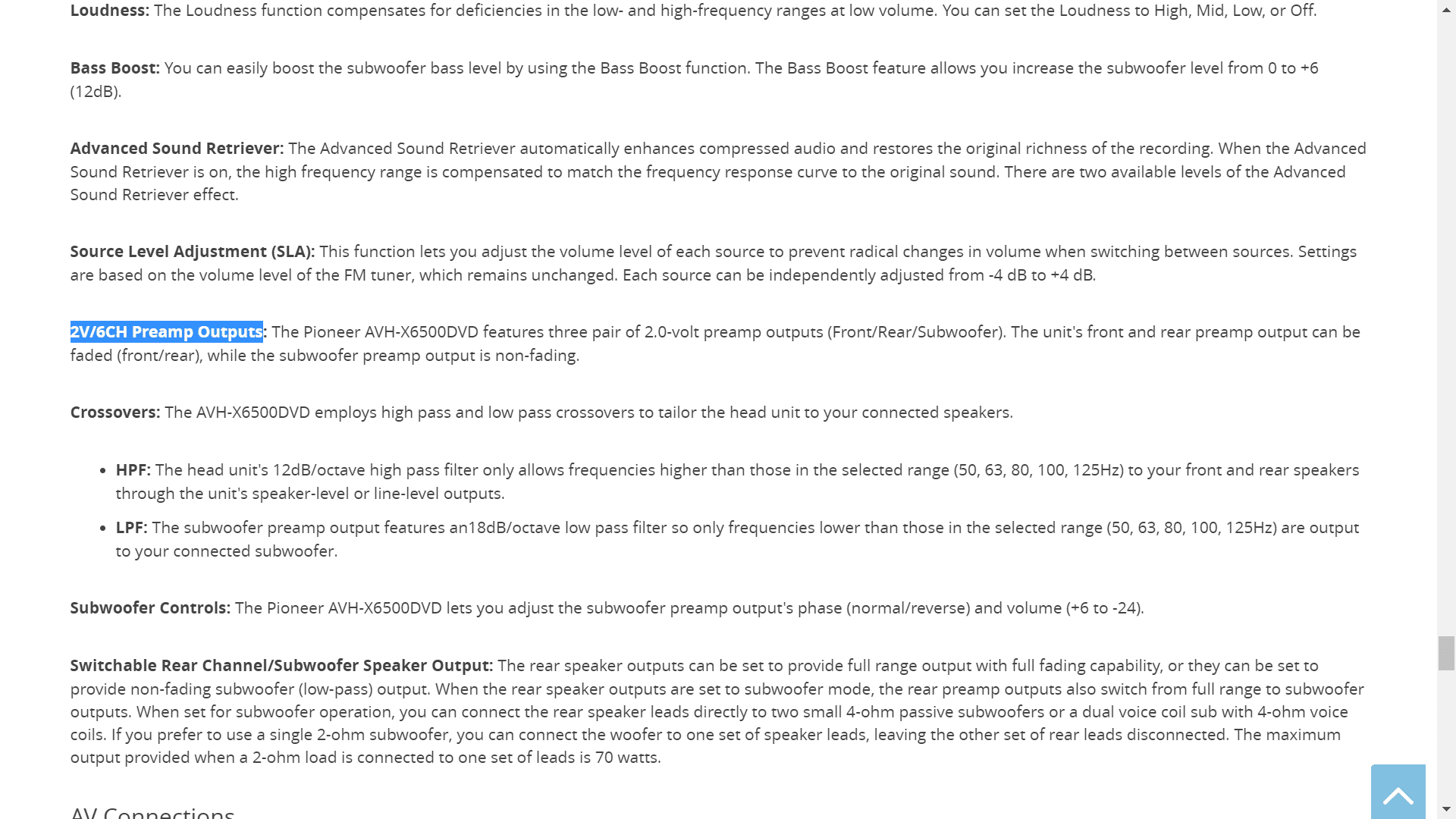

Yours is 2 volt not 4v. Sorry to burst that bubble lol. Your gains would not need to be at half if it was 4 volt

thats crazy because here on pioneer's website it says 3 4v preouts- AVH-X6500DVD - 1-DIN Multimedia DVD Receiver with 7" WVGA Touchscreen Display, MIXTRAX, and AppRadio Mode for iPhone® 4S and iPhone® 4 | Pioneer Electronics USA
yea i might be upgrading the head unit to maybe this- AVH-X7800BT - 1-DIN DVD Receiver with 7" Flip-out Display, Bluetooth®, Siri® Eyes Free, Spotify®, and AppRadio One™ | Pioneer Electronics USA
yeah some times pioneer lies about their pre-out voltages. At crutchfield they actually test out all the options and pre-out voltages and show a proper one. They claim 4 volts but the most you get is 2 volts. That was common with the older pioneers and some of the newer cheaper ones that list 2 volts dont even make it to 2 volts. There's a few specific models to avoid but most of them are decent. The 7800bt would be a massive upgrade.
yea i can see that, some sites i checked that sold the AVH-X6500DVD said 2v and some said 4v. yea that 7800 has a lot of nice features!
