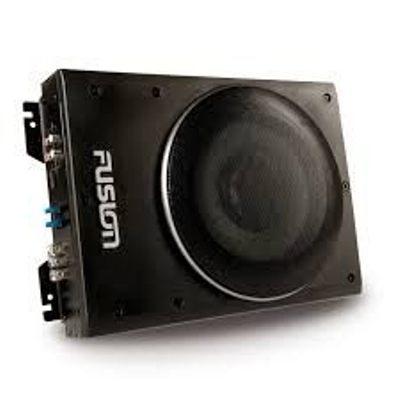

Subwoofer: Fusion CPAS1080 active 8" slim underseat subwoofer
