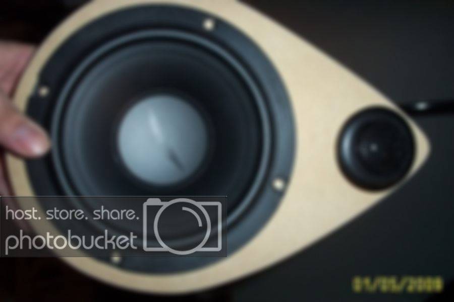

Im thinking something along the lines of this:

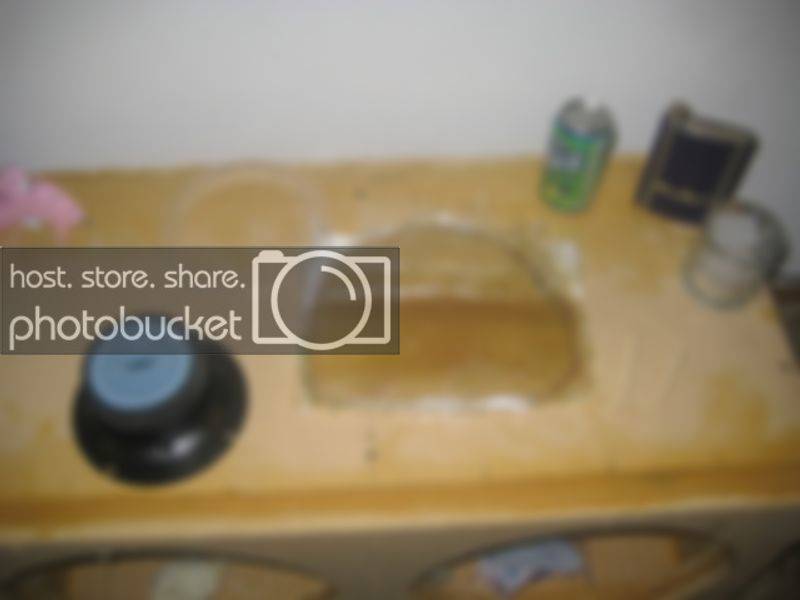

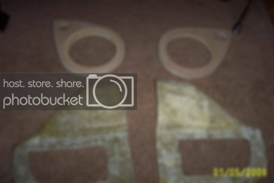

Went and got a gallon of resin, 8sqft of mat, cup's, dowel's, stir stick's, chip brushes, ect. and started [after brainstorming MANY idea's]

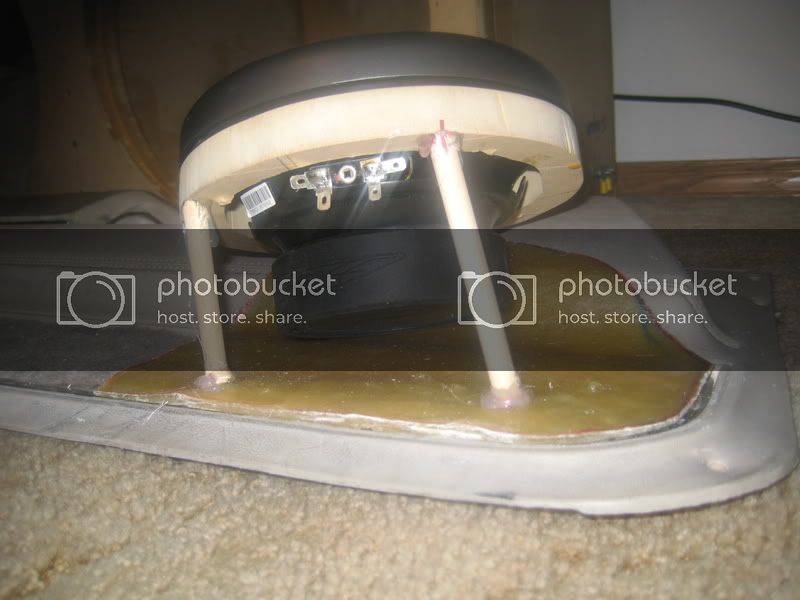

Here's what ive come up with. They will be bolted to the actual door panel, No cutting, or anything.
Here's Approx where i think my ring will sit. It's about 1" out further then the arm rest, But i may be able to get it flush. If not ill come up with something.

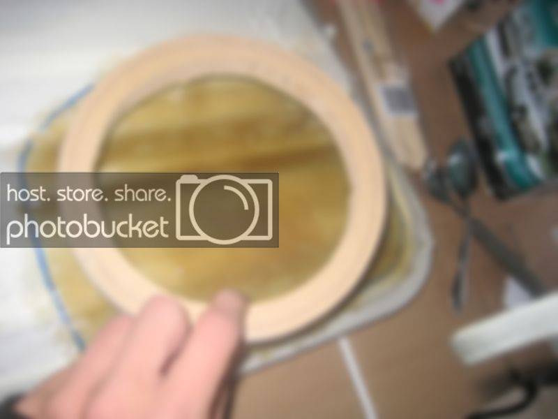

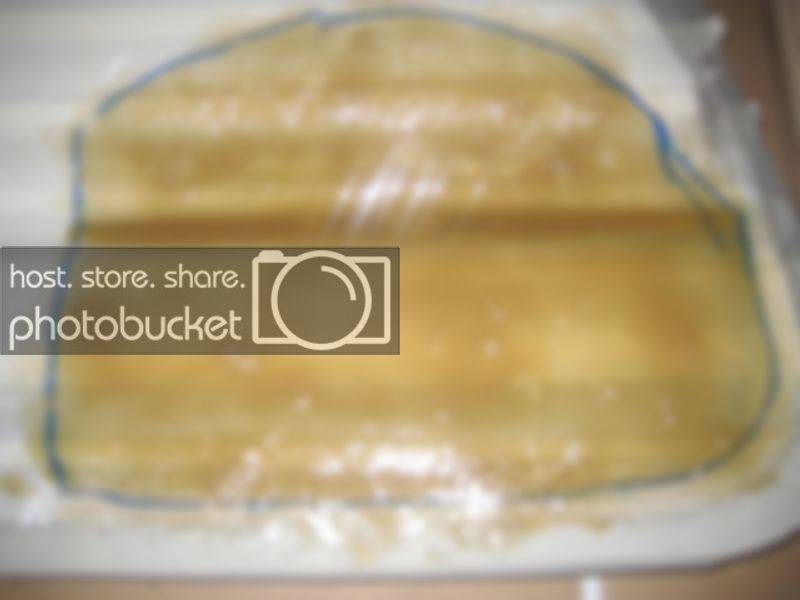

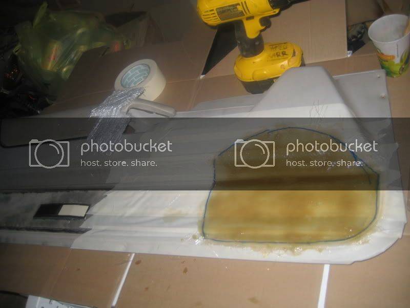

does it look too thick to you guys? I layed down a decent amount of resin, got the bubbles i seen out of it, Layed 3x3 squares, dabbed them with resin, and smoothed it as much as possible.

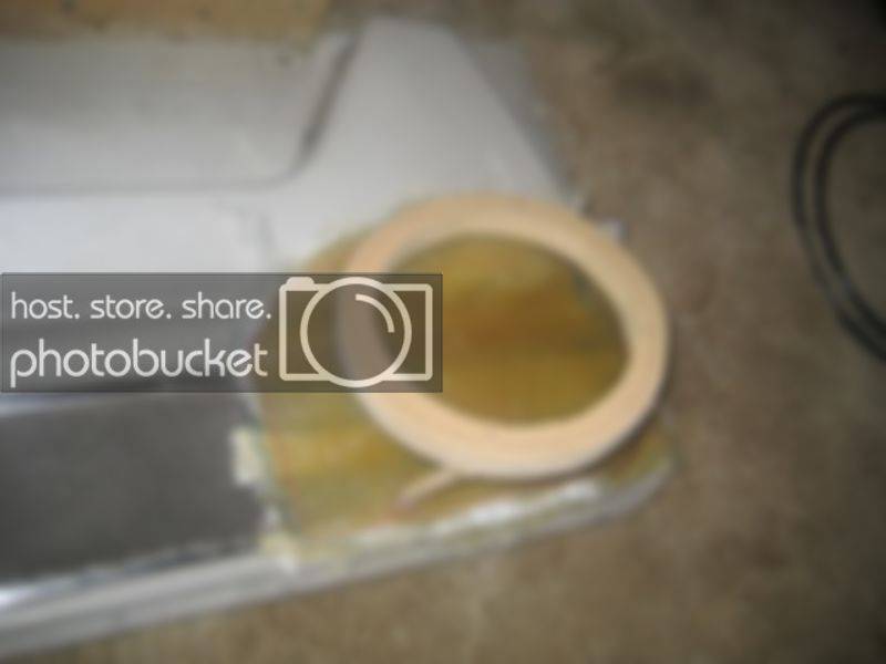

My window seals leak real bad, And im scared my mids will get wet. Plus if you look at the space available, Then the space the ring takes up, there's not too many other choices. For now i just want them in and working, lol.
Also, How many layers should my "Base" be? I just put my second layer of mat, and resin on it. Figured the stronger the better since itll be bolted to the door panel.

Then i positioned my ring, Cut the dowel's, And started glueing

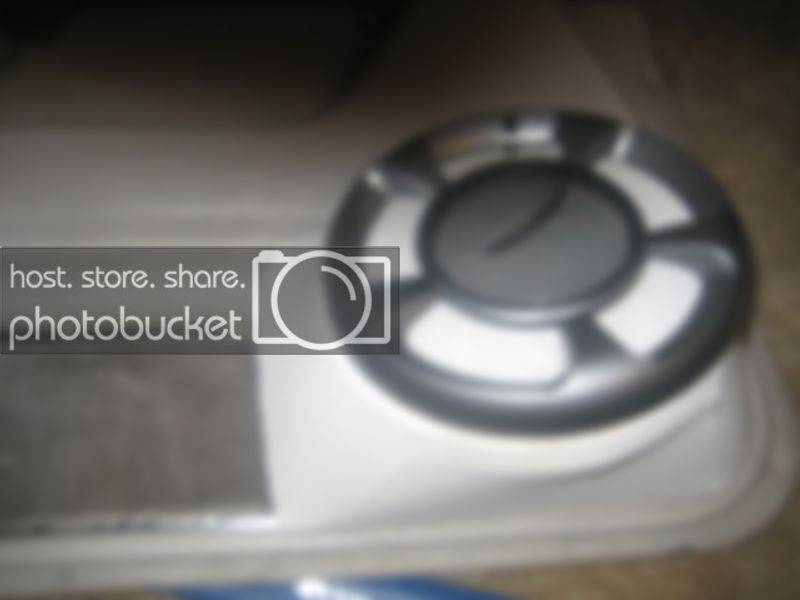

Just an idea of where they'll sit.

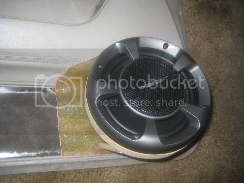

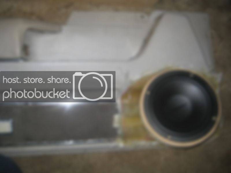

With mid

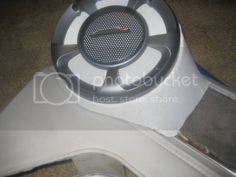

All trimmed up [i used a set of Dykes, go ahead and laugh. Couldnt run the jigsaw at 2am.] with mid and grille

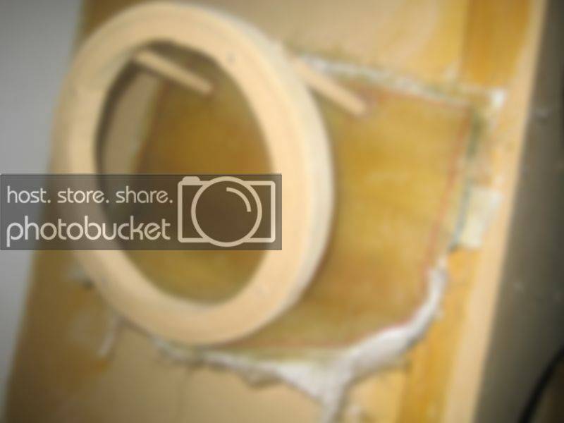

Showing clearance.
Wrapped in T Shirt, With grille. [Had two creases. I think they'll be okay.]
Same, Different angle.
ya bro that's lookin good, but it might have been a little better to go with bigger "boxes", so you get better mid response, but i think they'll be good either way. also, get a new h.u. bro, dual sucks *** =)
Traded my CDA-9885 for it. It was a bad trade on my part, But i needed an Indash screen with DVD, and multiple video out's. So it does its job for now. Ive been pondering throwing an EQ in the mix to bump up the pre-out's, But i gotta get my cash right first.
Also, i understand the whole enclosure thing, But wouldnt a whole door [Not to mention one that aint air tight] be a bit TOO much "Enclosure"? Might as well run em free-air'd.
Do you think i should put some polyfil in it to try to getbetter responce?
even with poly fill you won't get the same sound as using the door. granted a properly deadened door will sound better then one w/o any i still say using the door is gonna get you a better response. if your worried about mositure then get you a rain guard to go above the mid. one of those foam baffles cut in half would work great that way it'll cover the back of the speaker and let any water just run off of it.
