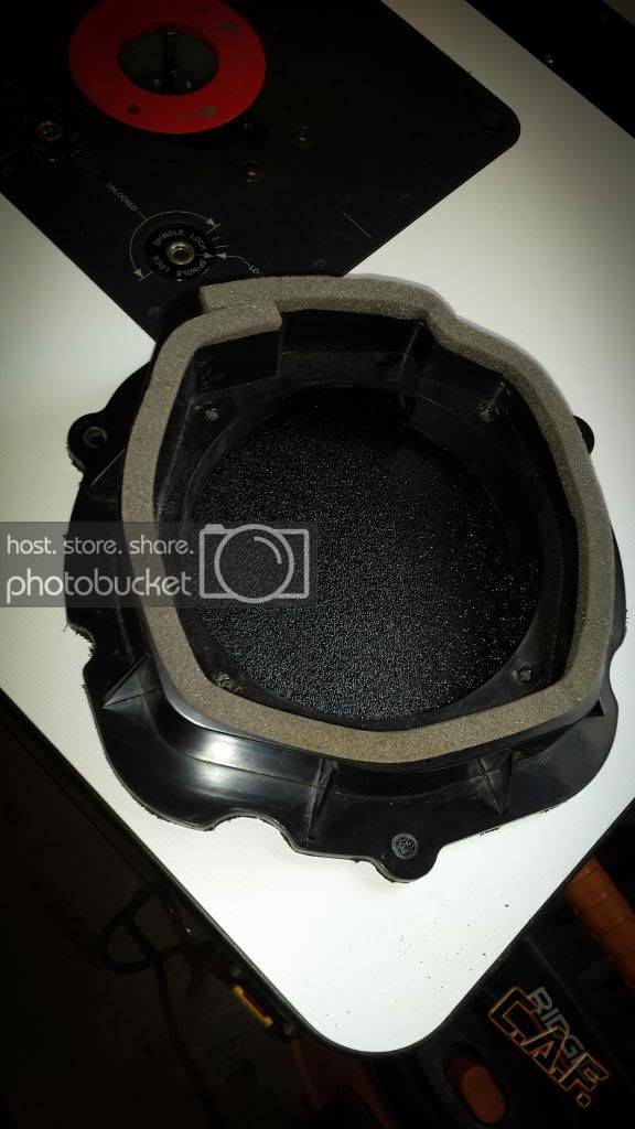

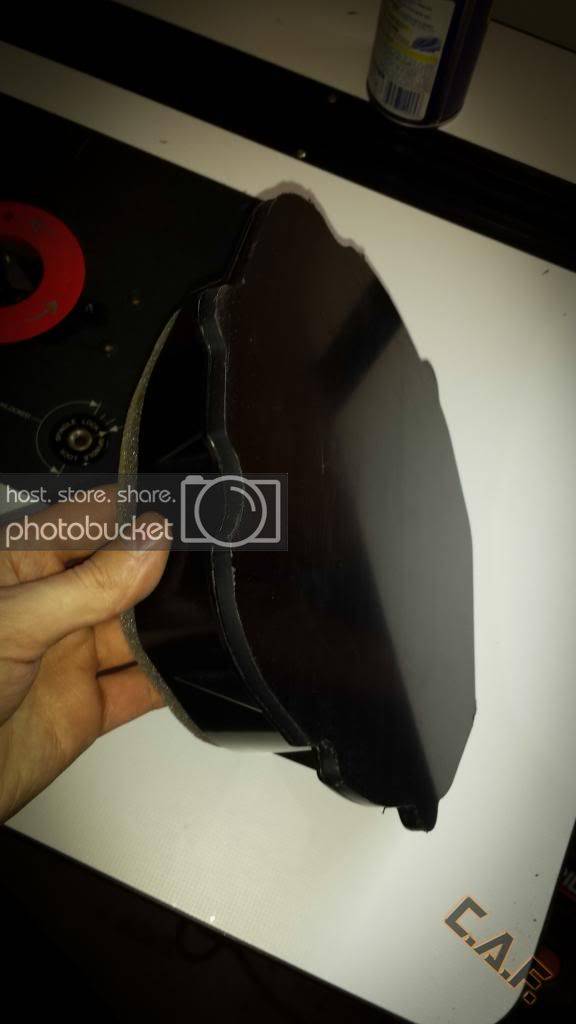

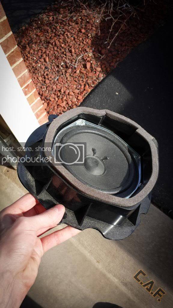

Here we have our average stock speaker bracket:
The problem with this bracket is that it is simply not large enough to house our new component speaker. But there are some good design elements of it that we want to note and include in the making of our new bracket.
First off it is made of plastic. This is good because it will never decompose like wood. It’s also very strong and stable. This is good because we don’t want to lose any acoustical energy with unnecessary flexing of the mounting baffle. We will want to make sure our new bracket is also made of composite materials.
Secondly it spaces the speakers away from the inside of the door. This is critical because it makes the speaker stay out of the way of the window mechanism within the door and also brings the speaker closer to the hole in the door panel where sound will pass through to the passenger compartment. We want to be sure we also space our speaker away from the door.
Finally there is a foam ring around the outside of the baffle. This helps to direct all of the sound from the front wave of the speaker through the grill mesh or hole in the factory door panel. If this ring is not there then the sound waves are free to bounce around within the door panel or dash which can lead to cancelation or unwanted vibrations within the panel itself. We will need to include a foam ring in order to direct the sound as desired.

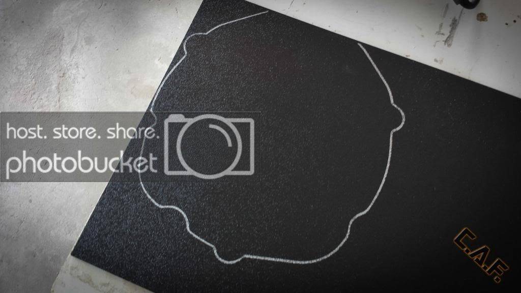

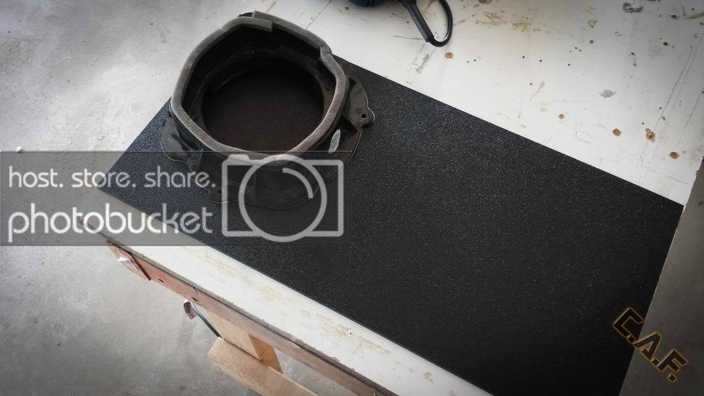

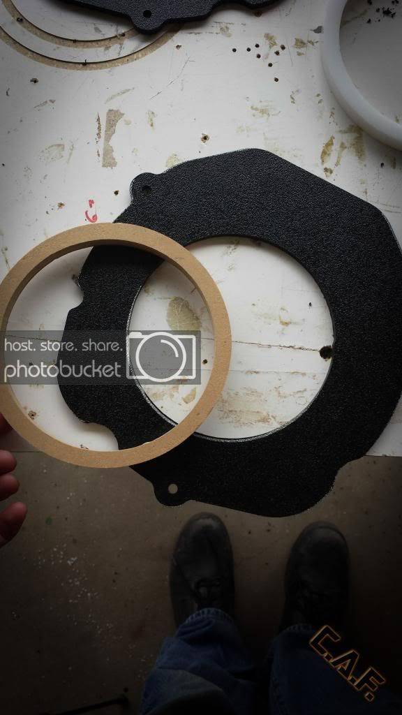

I started with tracing out the stock adapter onto a piece of .25 thick ABS.

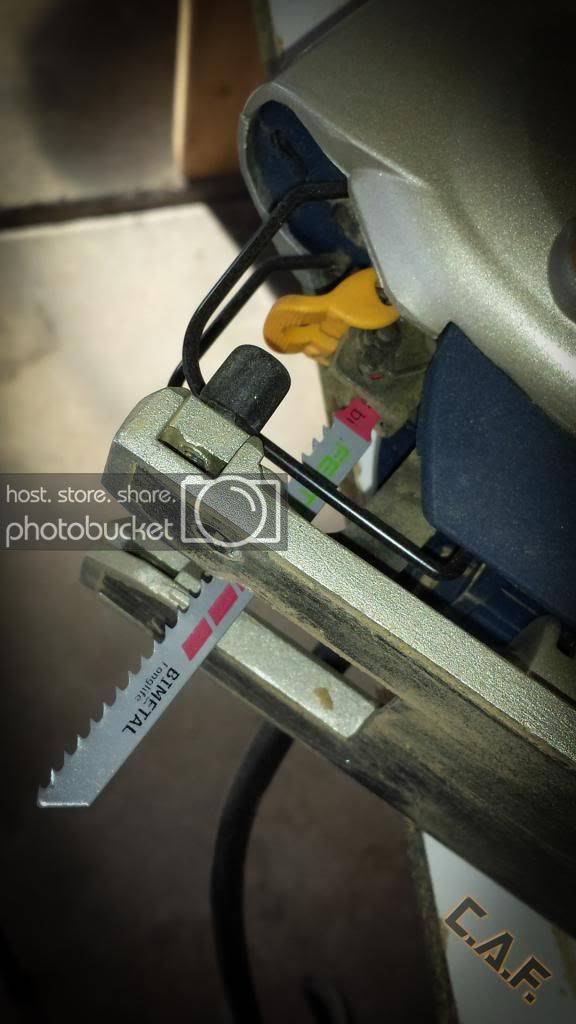

I then rough cut this piece out using a jig saw and then used my router table to copy the piece perfectly using a flush trim bit:

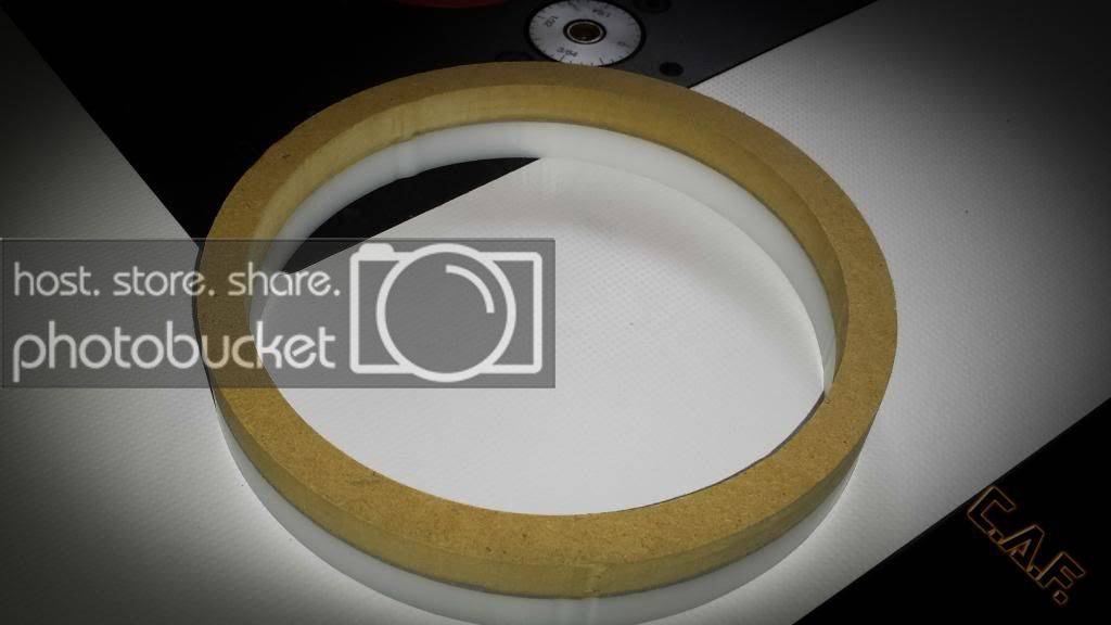

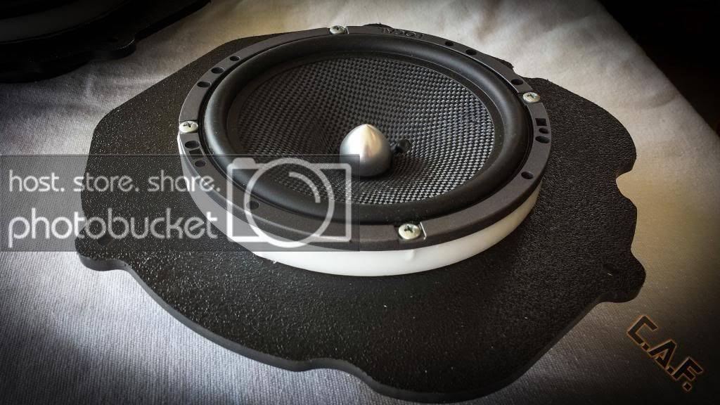

In order to space the speaker I am using .50” HDPE. I started with making a wooden circle template out of MDF, then transferred that to the HDPE, once again via the router table.
I used that same template to cut out the same inner hole on the ABS.

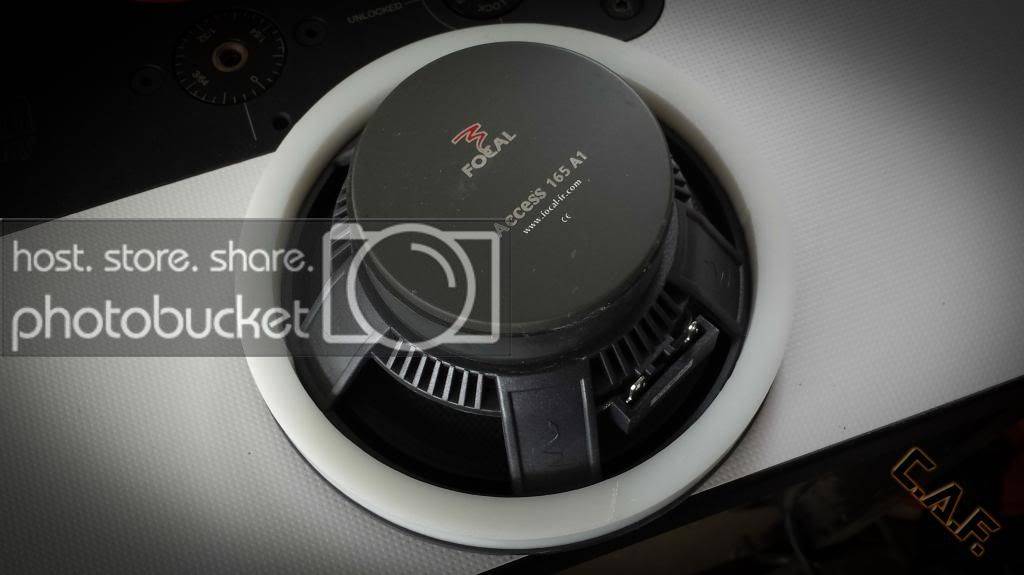

In order to assemble everything I used CA glue to glue the HDPE to the ABS, then mounting hardware to secure the speaker to the HDPE. Be sure to predrill all holes to avoid cracking.

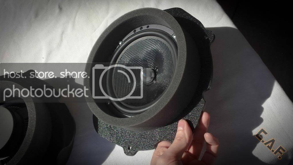

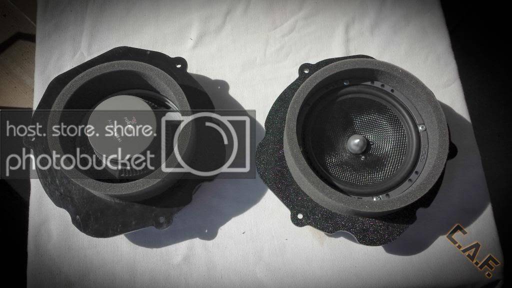

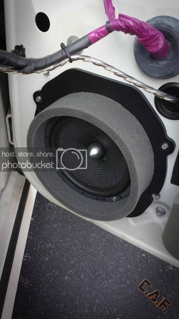

At this point we have made new adapters that not only fit our new speaker, but are made of composites and space the speaker away from the door. Now its time to add the foam rings. I found a supplier that makes the foam rings in multiple different sizes and that are pre cut with adhesive. These were super easy to apply, just peel and stick.
The foam kits also come with a piece for the back of the adapter that allow you to shield the speaker from any dripping water within the panel, and they isolate the adapter from the surface it bolts to.
Once bolted back in all you need to do is apply your factory panel and give them a listen! Do note that some applications will require modification of the foam, but in my case the foam bridged the gap between the speaker flange and the inside of the door panel perfectly.

Is that foam closed cell foam? If it isnt then water will get through it and the additional foam on the back is completely useless other than for absorbing and containing moisture.
