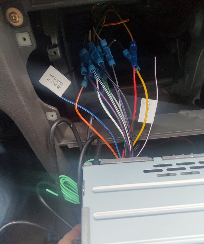

So, I connected the wiring using butt splices by referencing these two things:
subaru - https://www.surrealmirage.com/vrg3/bcstereo/
sony - https://cimg9.ibsrv.net/gimg/rennli..._118d1aaf63cda9e3b3c45406d48216d33e8d27ff.png
Left disconnected are the parking brake, reverse, and REM on the sony side and the subaru side, one Accessory +12v, Illumination (-), and Power antenna control are unused.
I connected the ground, then the power (accessory 12 and battery 12) then all the speakers to the sony harness and then plugged it into the device and turned on my cars power.
Nothing happens.
Assuming the head unit is fine (it's brand new), any idea what's going on?
35046
Have you confirmed that all the wires coming out of the dash are what you think they are? Check your radio fuse in factory fuse box.
Also you can connect that parking break wire to ground.
