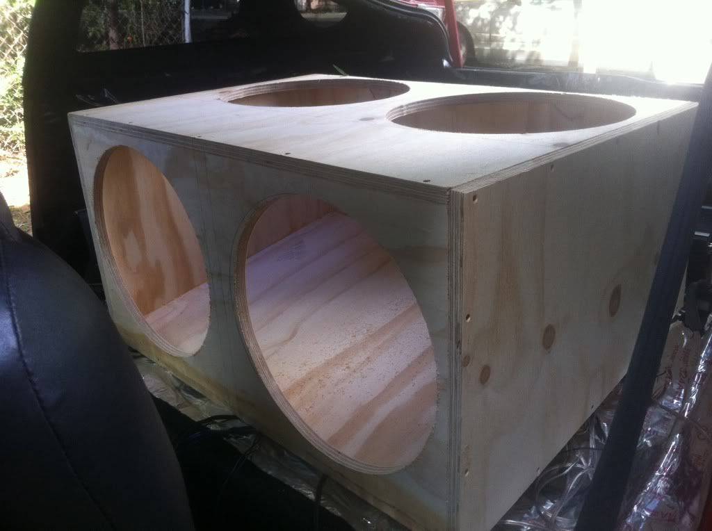

S10 (these are 18's, but you will want this style box most likely). This one did 157 on ~ 4k.
Blowthrough will put you in "super stock"
This is FOUR 15's in my CRX. And below the window line. This one did ~ 156, iirc. Box is too big for a CRX. It was worth a shot though. Lol.
