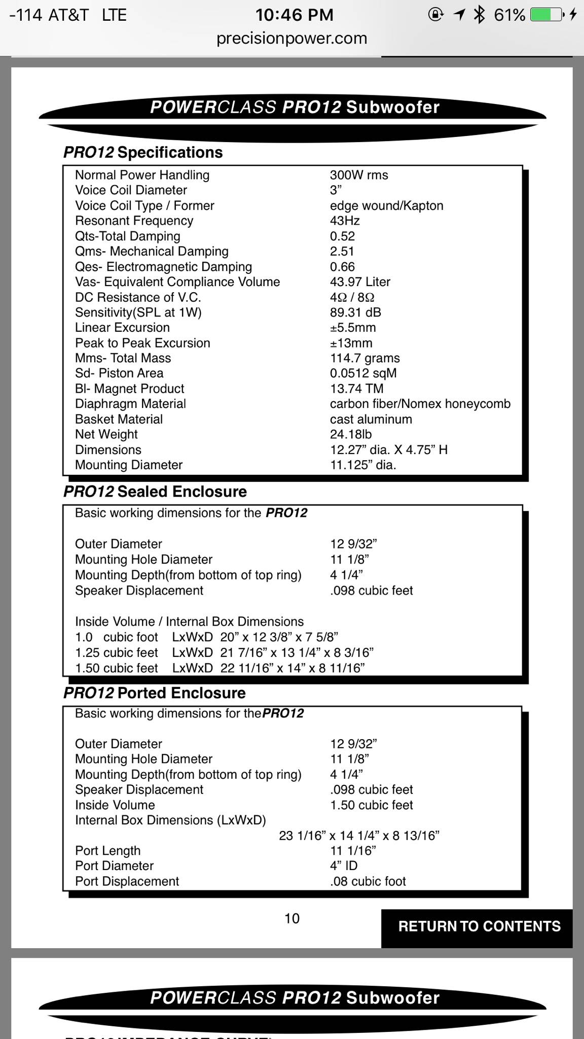

Yes that is correct, I am only running 200rms to each one. They are pretty efficient subs though and hit pretty hard with that small power. I could run a lot more to them, I have ran 800 rms to each back in the day, but these subs are old, and I was kind of wanting to take it easy on them and get something newer.
Here is there spec sheet though so you know what I am using.

wow 3" coil 300rms lol.. those only have 5.5mm excursion i guess is y low rms where as ones we are talking about have much more movement and better motors, u can do a 12 in 2cf ad box (2.5 better so 3cf or so total) but 1 12 like the 750 or gcon (better sq?) ported would be louder and deeper with 1k or so than 2 10's in smaller boxes and u won't kill your alt., wish u could hear my pos system and my ports to small mirrors look like they gonna fall off and my sub was $70... another one to consider is FI ssd 12 customized it's about $299 (if i didn't mention that yet) and we assuming u would run 1 12 at 1ohm or the 2 d4 10's at 1 ohm.. just saying get 1 bigger sub less $ maybe less power about same size box, since u worried about electrical..
