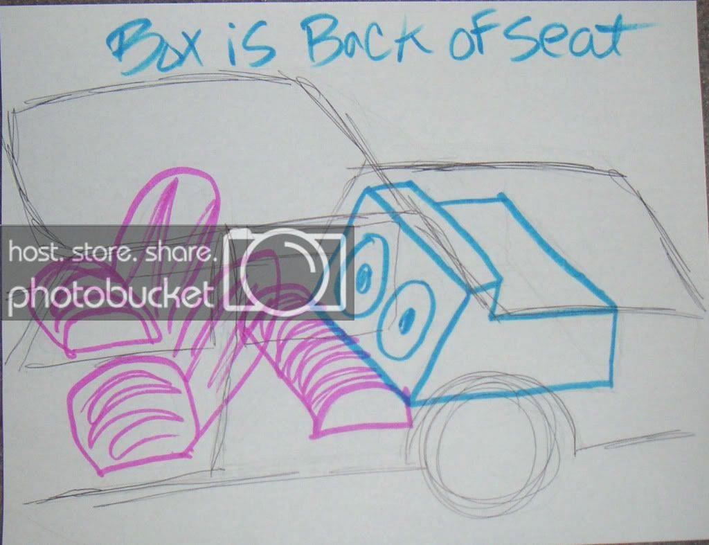

if your daring, id say re work the back seats so the sub faces in the cabbin and use the trunk space for a box, but have the sub facing the cabbin so you can actually hear it.
if I had a lincon town car like you / actually concidered getting one. - ( that or a caprice )
but I would take out the back of the seat and modify it so 2 people can still sit on either side, but have the sub totaly out facing in the cabbin, and have to custom build the box in the package tray and having the port facing up thru it firing in to the rear window glass.
sub foward in to the cabbin - port up at rear glass.
the idea in this, is you are keeping all the sound in the cabbin of the car.
no reason to have a loud trunk and a not soo loud cabbin of the car.
should still leave you with plenty of room in the trunk for batterys and amps - along with a big ol box for the sub - wether its a 15" or a 18" wich will want from 4.5 to 8.0 cubes depending on aplication.

build this. it will be loud
