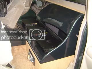

heres the system.... it slams!//content.invisioncic.com/y282845/emoticons/eek.gif.771b7a90cf45cabdc554ff1121c21c4a.gif
amp:pioneer 380w
sub: alpine type r 12
box: 2 cf@ 32hz built by me
