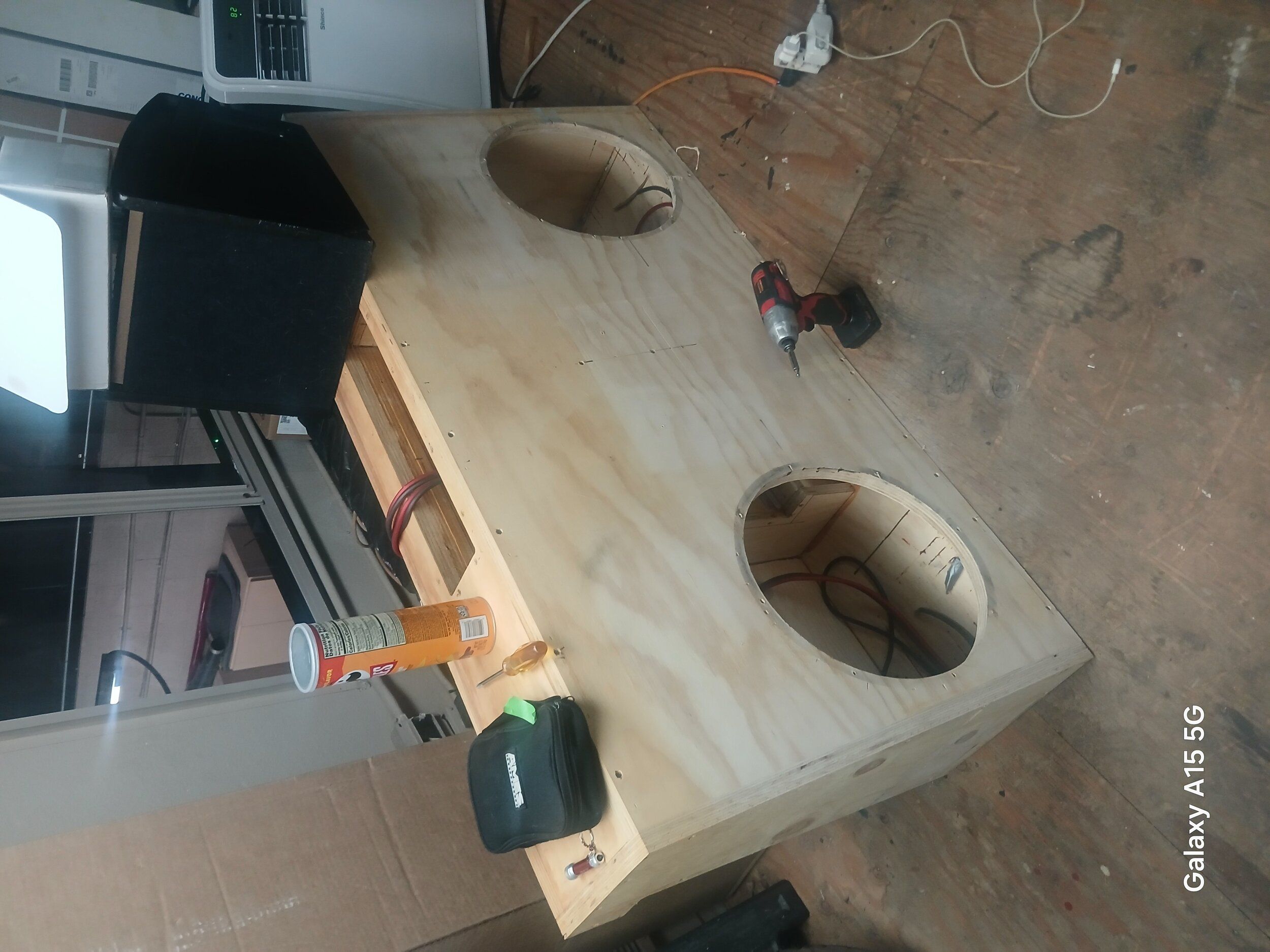

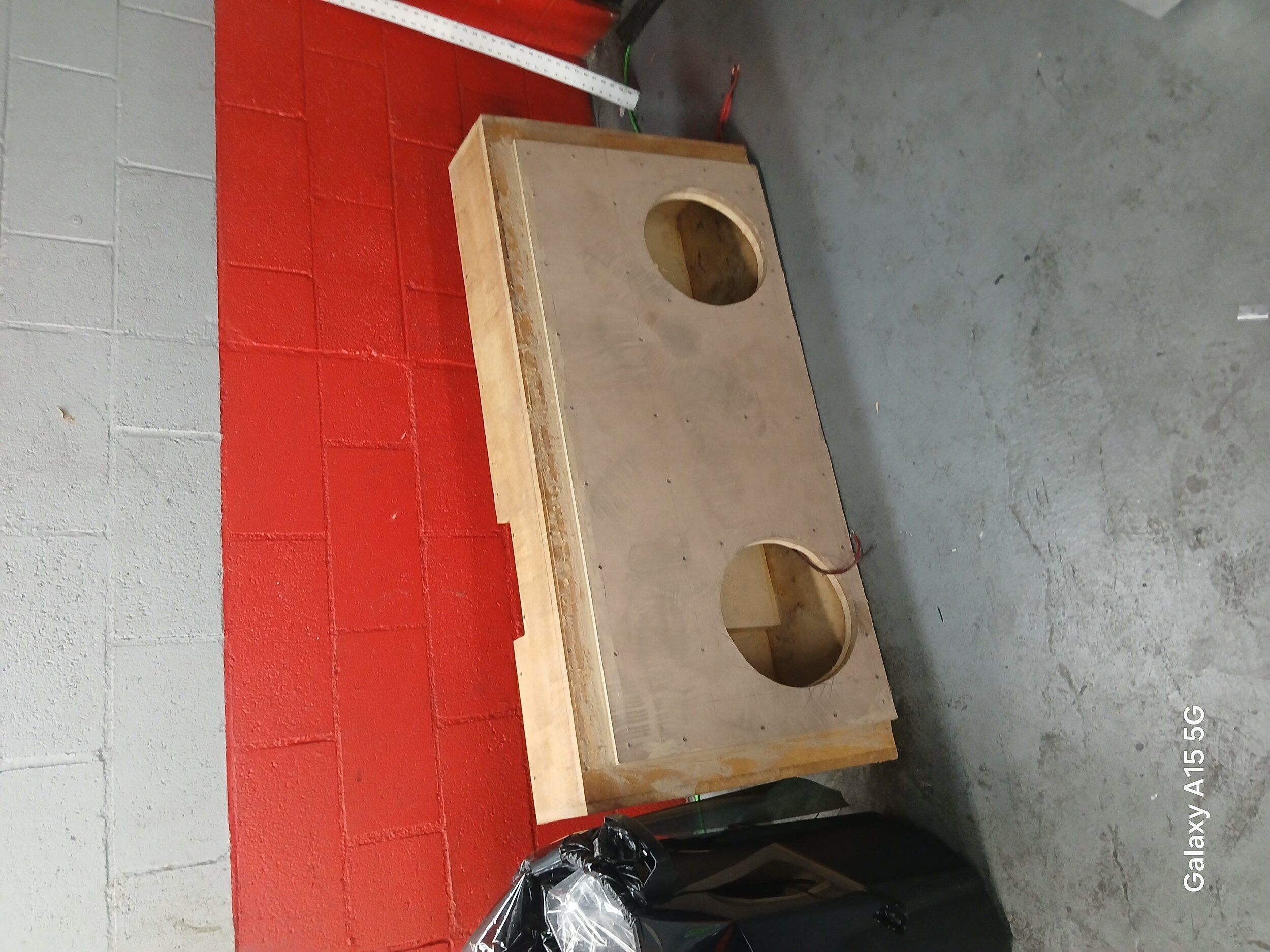

I wanted to get a 150 in the cab. I should've just got a bigger amp. I tried two Sundown U 15 V2's but the box was too small. Then I took my box builder's original advice and got two 12's. I have an extra box now. It's 4.65 cubes net tuned to 35 hz. I made about a $700 mistake. I actually had to buy my 4 - 8" box back for $200. I eventually want to get two AB HD12's. I should've listened. This is the 2 - 15" box. I'm sorry that the picture is sideways.

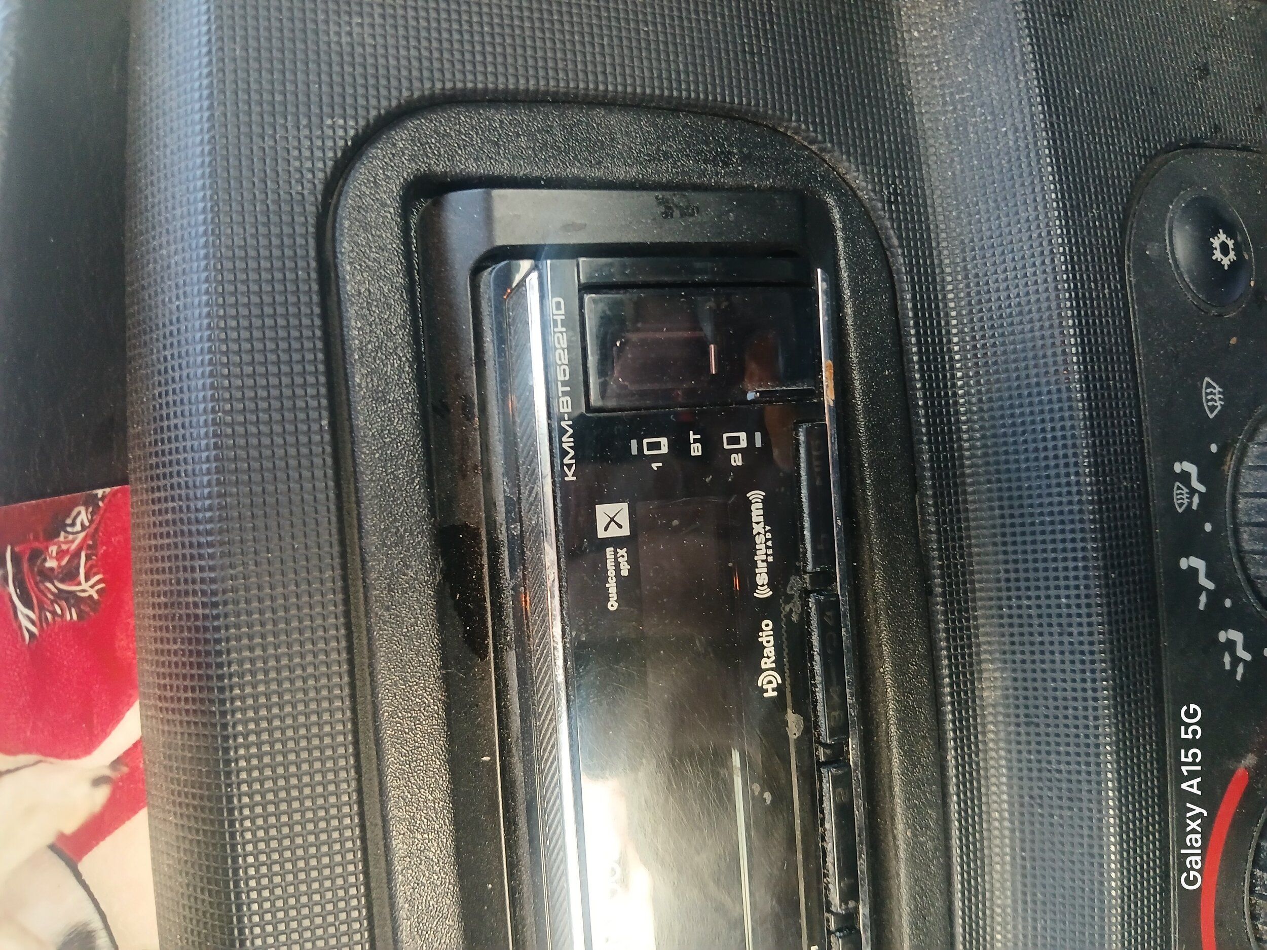

I think I'm losing my headunit.

My Kenwood headunit. One turned up bass note and she turns off. I can only play low volume. I lost my noggin a long time ago. The last time I weighed 139 was 7th grade. I was 152 in 8th grade. I was around 205 last Summer and 235 in 2019.

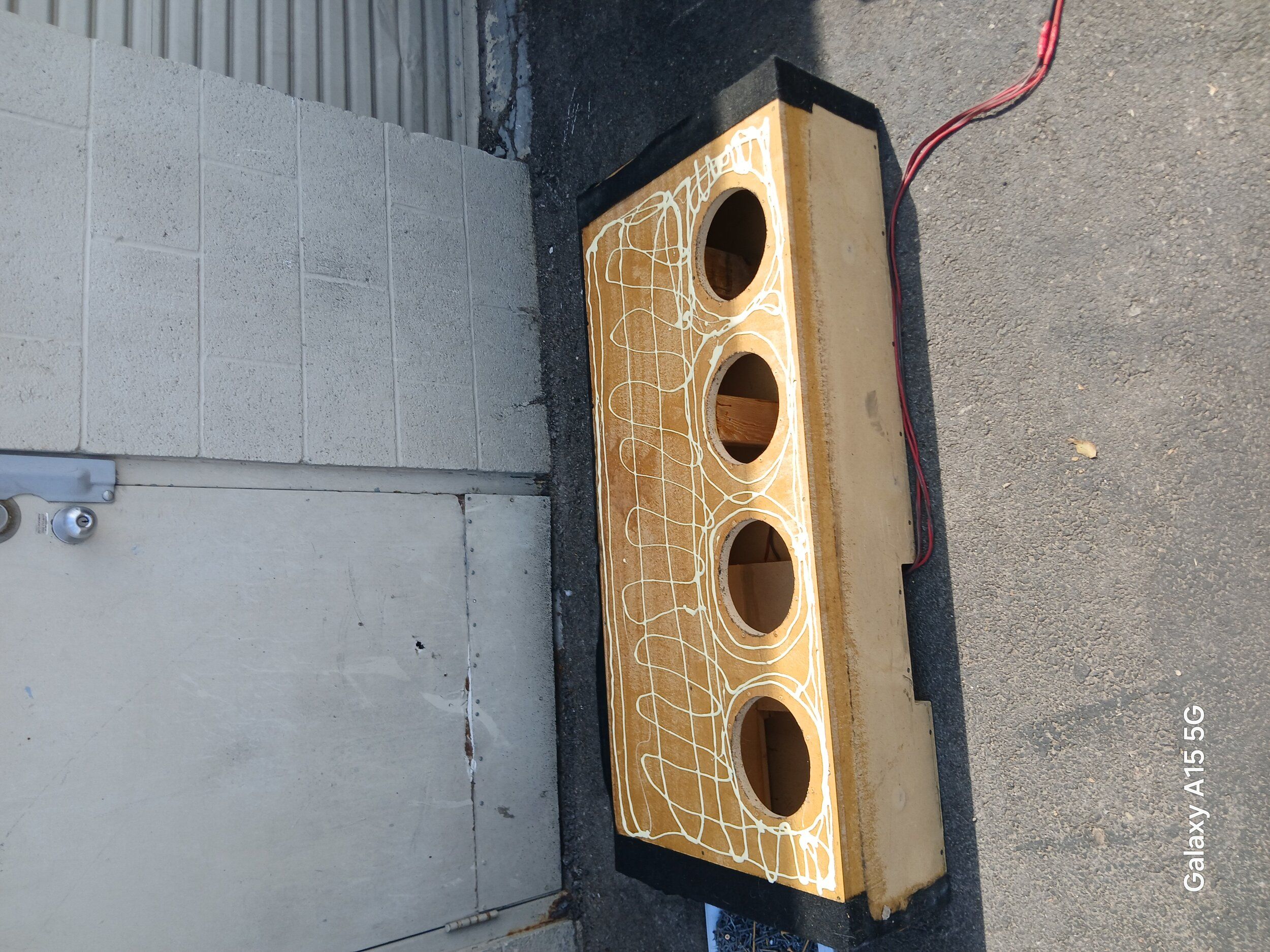

Wow. Nice build bobby. Weren't you working on some boat project few months ago? On some other network or website I guess, I saw this. The setup for the 4 small speakers is the one I'm interested in. The inputs, negative to negative, positive to positive, all parallel connections. Outputs negative and positives at each end of the speakers. Did you try this out yet or still setting things up? Making it work and seeing enough watts or electric gets to each speaker is the part. Great looking speakers. In Las Vegas, very hot time this time of the year. I know they're popular hobby goers in Las Vegas.
Have you tried to raise the volume with the amps off? I would assume bad speakers would cause this kind of issue, but you are using RCAs so that rules out that assumption. Only external culprit left would be bass vibrating a connection somewhere.
The screen starts to trip out and looks like a bunch of different colored lines. A while ago a car wash ripped the antenna out of my truck and now I can only bluetooth music from my phone. It did it a couple of times before the antenna mishap. The pressure might have finally got to it. I'm curious what the two 12's would do on a meter.

My 4 - 8's were wired to one ohm on a SIA3500. They were loud and low in my standard cab. They peaked @ 31 hz.
