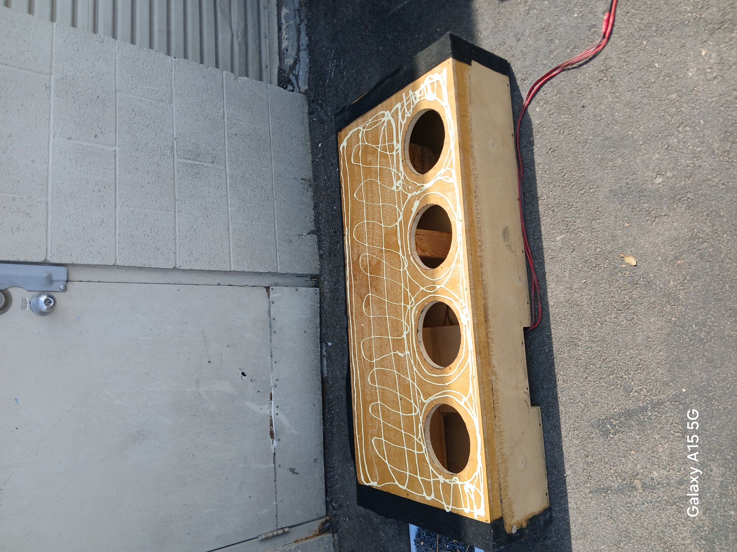

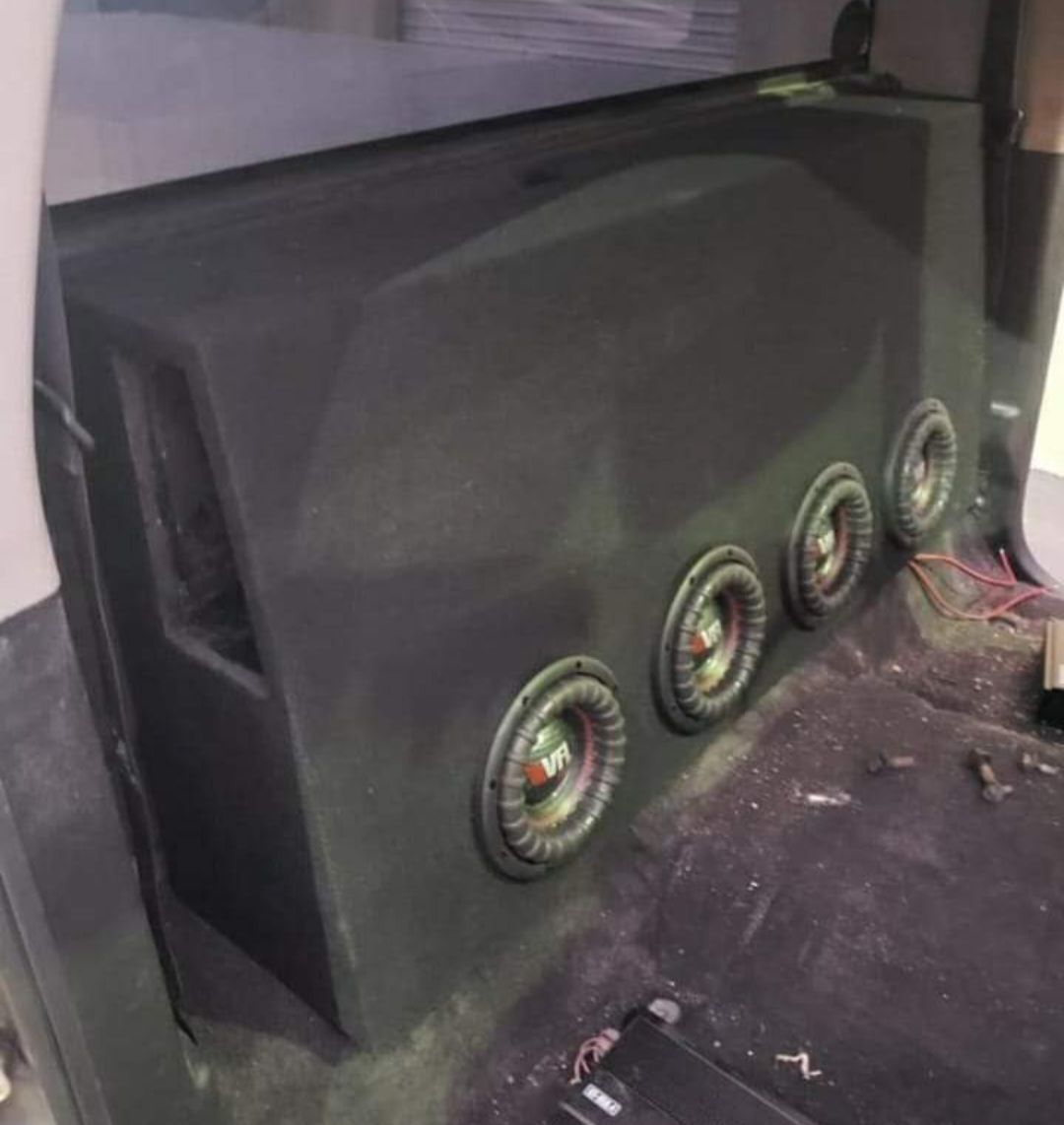

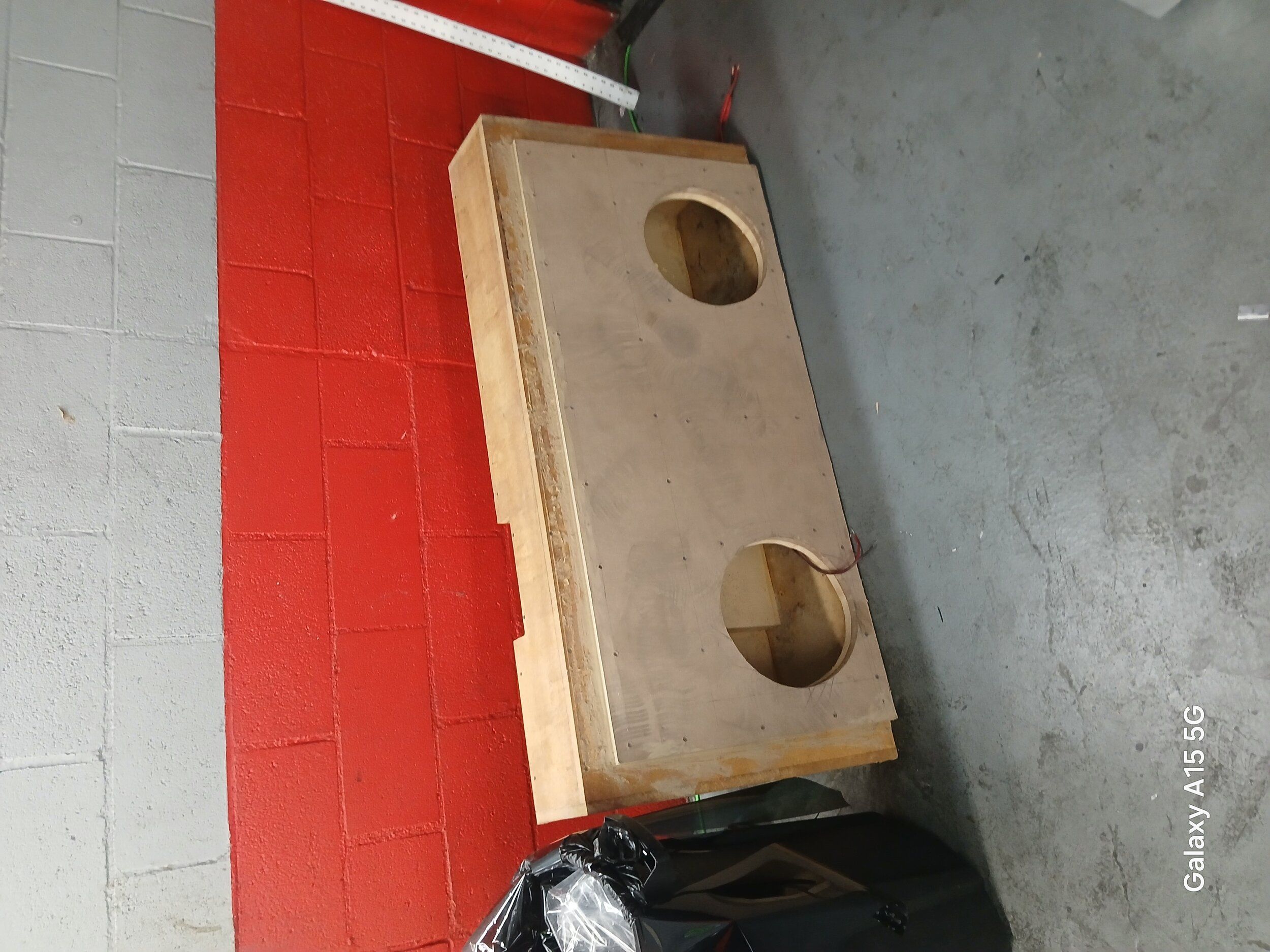

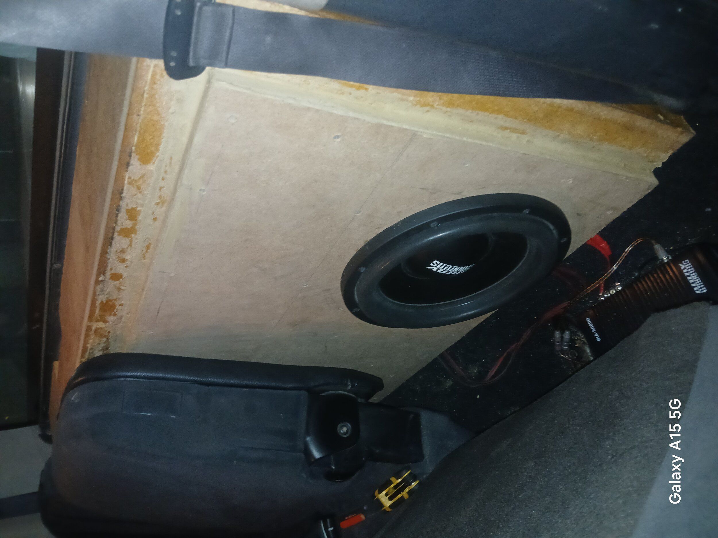

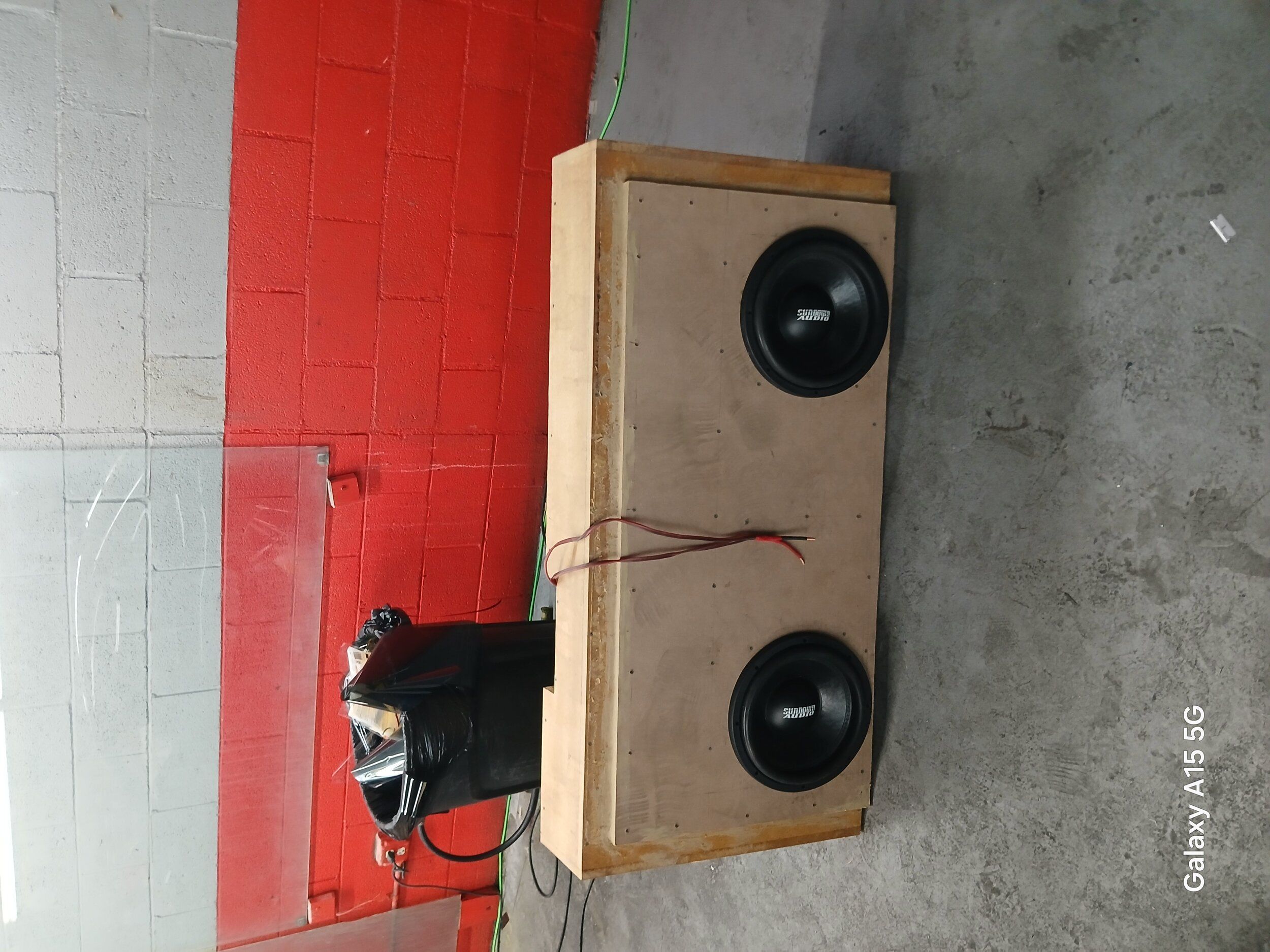

I changed up my truck build. I switched from 4 - 8's to two 12's in the same box (new baffle). The box is 3.7 cubes net after port and subs tuned to 34 hz. The new subs are Sundown SA Classic 12's on a Sundown SIA5000 wired to 4 ohms (2,750 watts).

What is the difference in sound between the two set-ups?
I haven't metered the 12's yet. I'm still tuning the sub amp. I think the 12's are louder. I know it's only 12.5% more cone area but it seems like it's louder to me. They still get plenty low. I always check the lows with the 28 hz. rebassed version of Enter Sandman. The 28 hz. drop gives me an idea of what there doing comparable to the 8's. One thing I've noticed is that my voltage barely moves anymore. Is that because I'm wired to four ohms now? I might add a third SA 12 and wire them to 1.33 ohms. Is 1.23 cubes net enough for the SA 12's? I'm crossed over @ 70 hz. on my headunit right now. I haven't heard these 12's bottom out once on the Enter Sandman song. The 8's would bottom out on that song on a soft clip. I can't really get the 12's to a clipping point. They won't clip with the bass knob all the way up. What does that mean? Should I turn the gain up? I'm sorry this is so long. I know we are on a daily pitch count in here.
That means those particular subs are way more efficient than the 4 8s. Great info! It may also be because those subs are designed for small enclosures and you put them in almost double their specified volume.
This is surprising being that they are in an oversized enclosure. Then again, they are Sundown and niched towards SPL.
Only if you went sealed. I modified a box for my nephew for 2 SA-10s. It was 1 cubic foot sealed for both subs. Still have not heard them bumping after almost a year but he said they sound awesome.

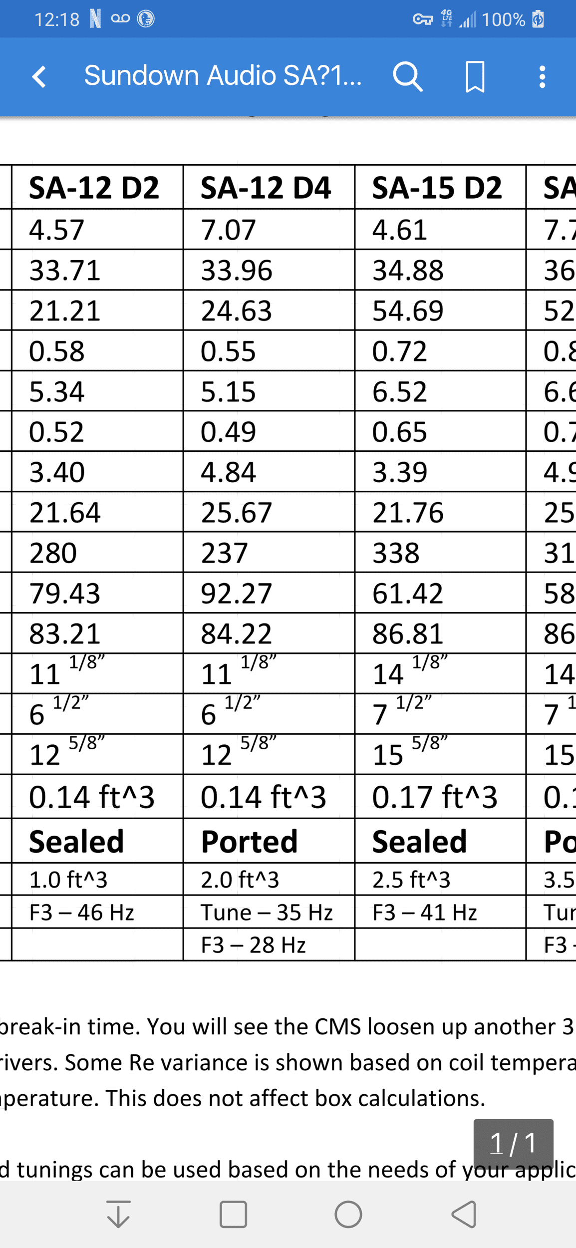

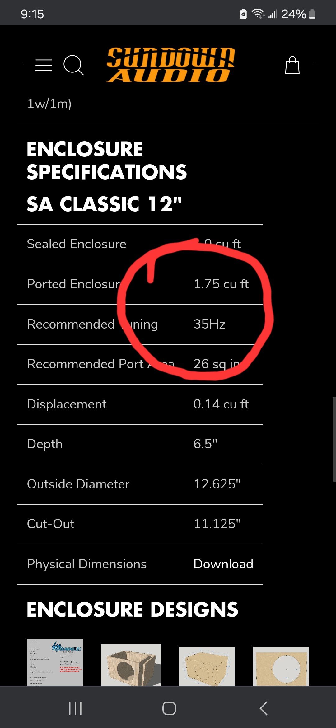

Sundown calls for 1.75 cubes for each 12" sub. That adds up to 3.5 cubes. My box is approximately 3.7 cubes. They also call for 26 square inches of port per sub which equals 52". My box has 43¾" square inches of port. They suggest a tuning of 35 hz. and I'm pretty sure that my box is tuned to 34 hz. I'm happy with them so far. I guess 12.5% more cone area makes a difference. The power has actually dropped from 3,500 watts @ 1 ohm to 2,750 watts @ 4 ohms. I wish I could meter it. My 8's were pretty sick.
I read the specs wrong. I was focused on the sealed side. Then according to the current specs, you are right on the money. I do know Sundown did a new run of the Classic, which would explain the new specs. Being that your port is smaller than specs, it controls excursion more than the larger area specs. Maybe a 3rd one will ruin the magic.

I think they even suggest that for the newer models but I’ve seen people mainly go 2 cf 32-35 hz.
I rebaffled my 4 - 8" box for the two Sundown 12's. They are the black bottoms. I'm about 1.85 cubes each.
