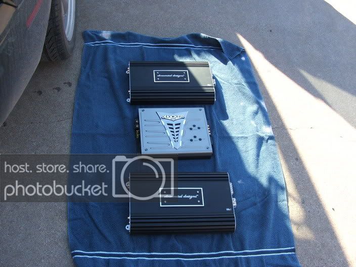

Power is no problem as I already have a couple of NINe.1's. Big 3 has been done. Power at the amp shows a steady 14.69 volts.

question...how are you gonna put 3 subs on 2 amps? will the nine.1's strap?
edit: Good voltage, btw.
I think nine1s are strappable, not sure though //content.invisioncic.com/y282845/emoticons/crap.gif.7f4dd41e3e9b23fbd170a1ee6f65cecc.gif.

Yeah the nine.1's will strap. Rated power for a strapped pair is 2500rms at 12.5v.
I was told by one of the tech guys at eD that one 9.1 at 14.4v and 1ohm will do close to 1700.

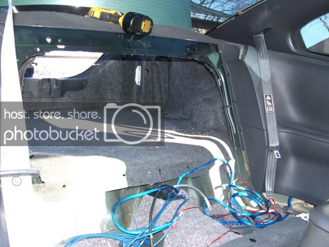

I would like to run two good 12's ported but it would definately take the whole trunk. Trying to steer away from that. But it looks more and more like I may have to.
If I did ported I could do about 2 cubes each for 12's, or 1 15 in 4 cubes...
I do plan on walling the trunk and making some sort of a "pressure box".
ben and ed isn't the most honest company. //content.invisioncic.com/y282845/emoticons/fyi.gif.9f1f679348da7204ce960cfc74bca8e0.gif the highest i've seen that amp bench at 14.4 volts is ~1500 watts rms
//content.invisioncic.com/y282845/emoticons/eyebrow.gif.fe2c18d8720fe8c7eaed347b21ea05a5.gif Eh, not bad power though. I'm still very pleased with these amps.
i didn't say it was bad, just that ben and ed are inflating the power capabilities //content.invisioncic.com/y282845/emoticons/wink.gif.608e3ea05f1a9f98611af0861652f8fb.gif
Yeah I gotcha. Thanks for the heads up. 300 watts over rated power is pretty nice. I guess 1500 is "close" to 1700. lol
nine.1's ARE strappable.
Stackable - TWICE the power. The NINe.1 is stackable without the use of a external module. Stacking 2 NINe.1's is a easy way to get 2500+ watts @2ohm Mono.
