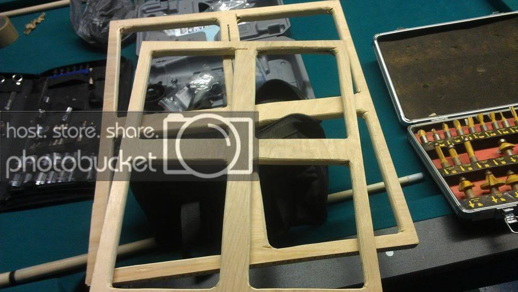

just some basic windown bracing..

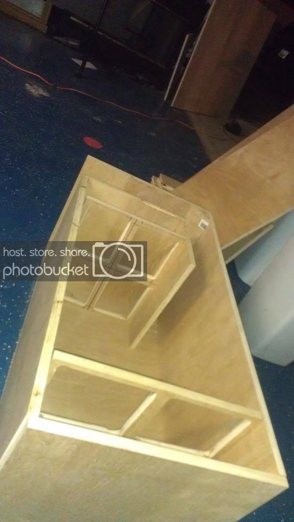

just a dry test fit... also 45'd the port wall..

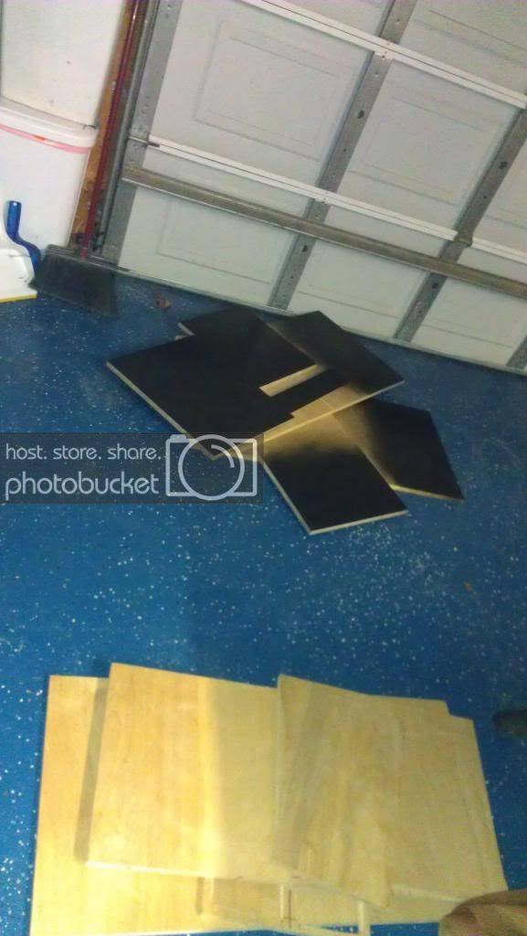

took the time to paint everything before assembly tonight, will turn out much better then just spraying and praying into the port after its built..
