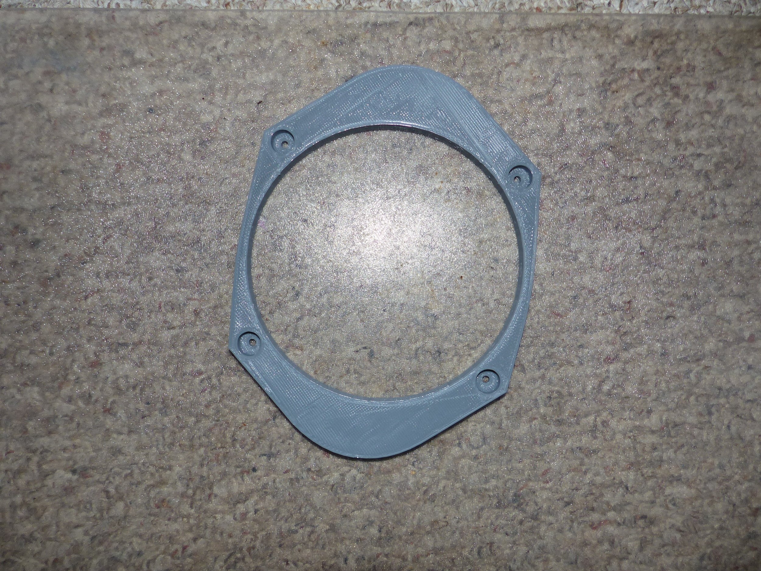

I 3D printed my 6x8 to 6.5 adapters for my Escape. Cost about .60 to make each x4=$2.40 and a couple of hours while I was doing someone...err...something, else. ;)
