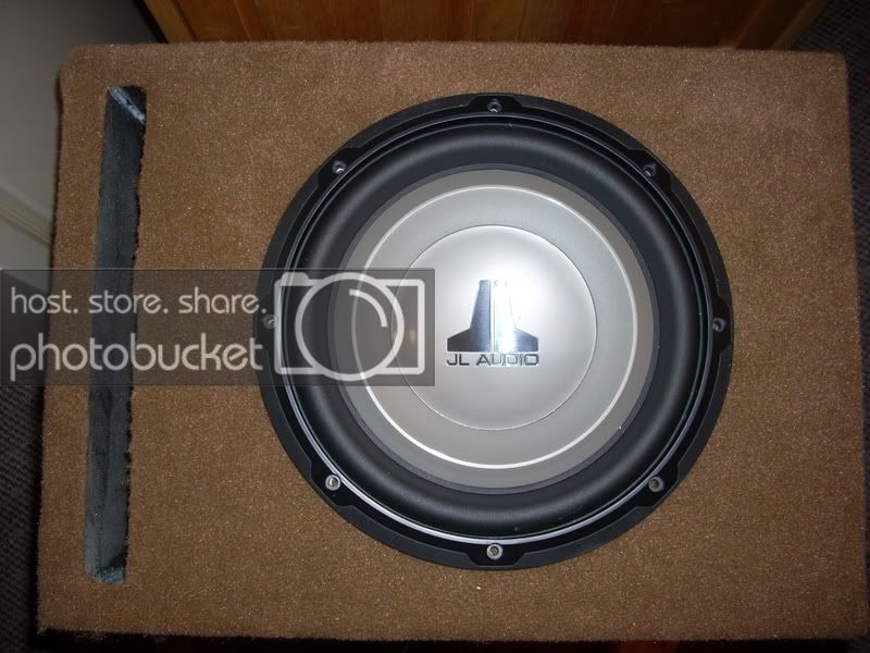

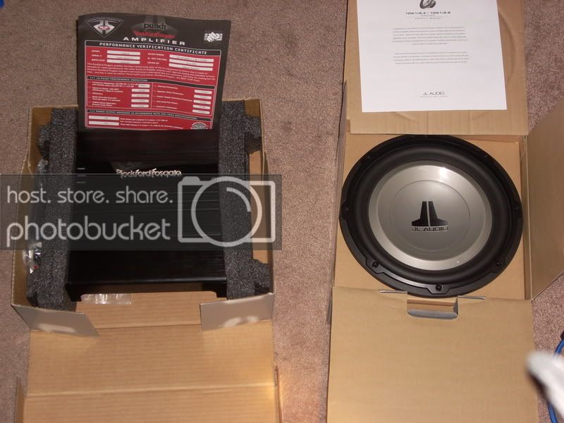

Rockford Fosgate P325.2 and JL 10w1v2.4. Got these for Christmas hopefully i will get them installed by the end of the week.

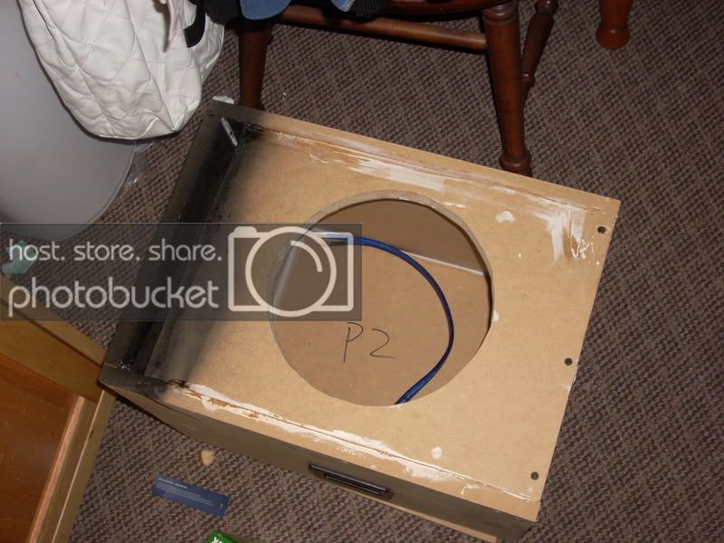

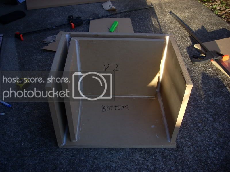

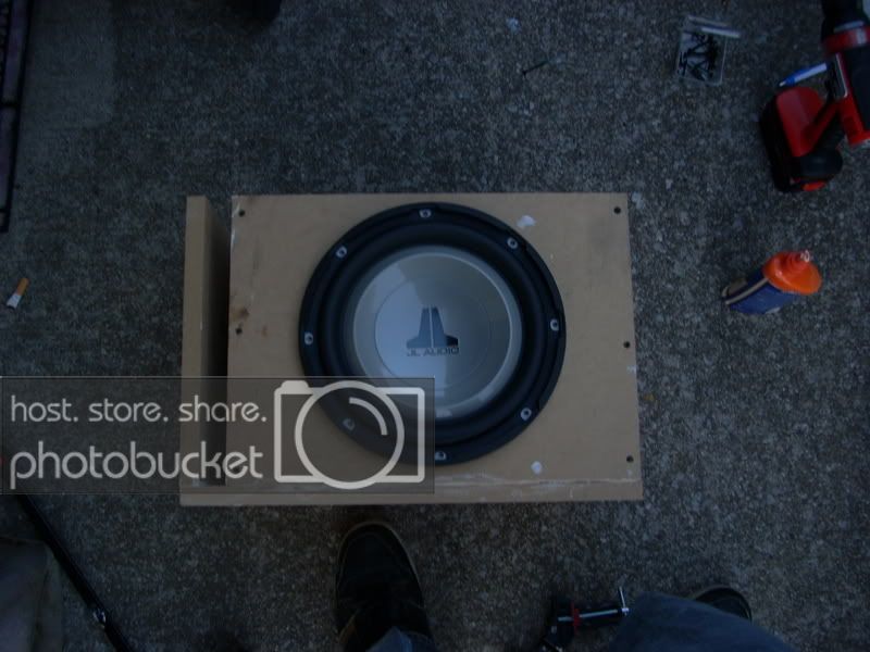

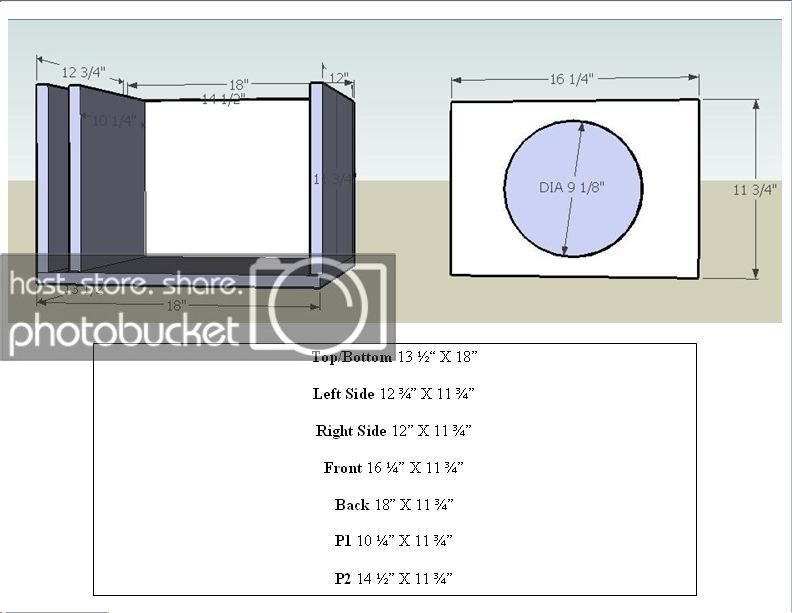

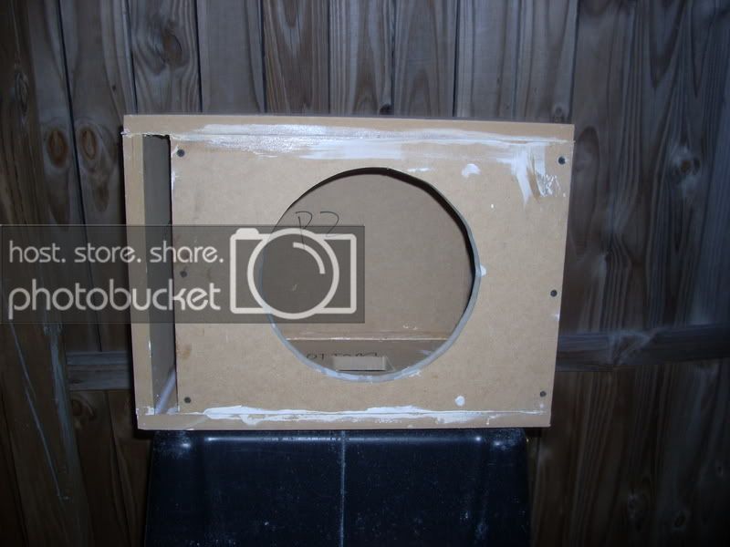

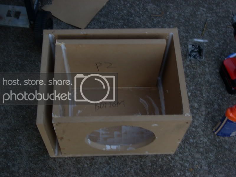

Box design using the JL specs that came with the sub 1 cubic feet tuned to 31.0 Hz
Comments suggestions?

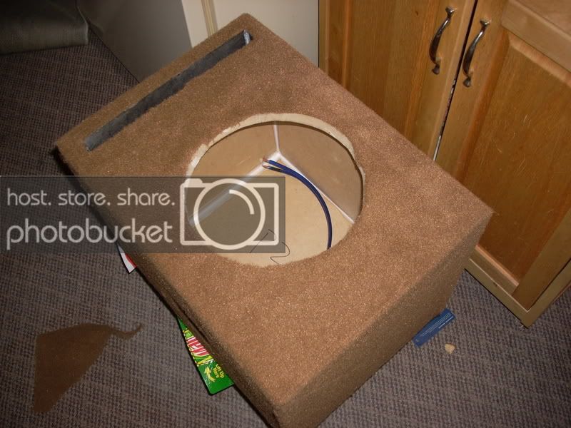

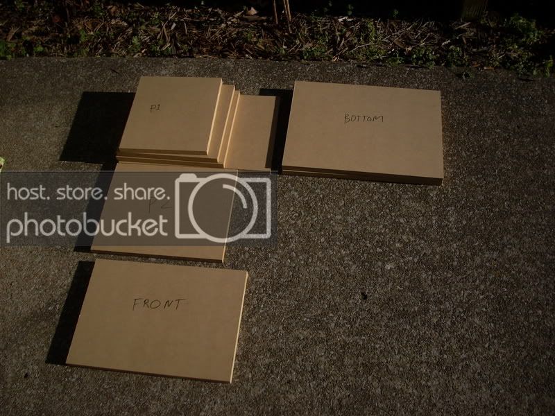

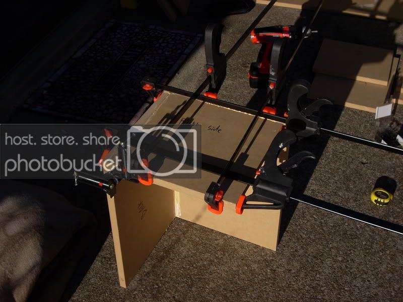

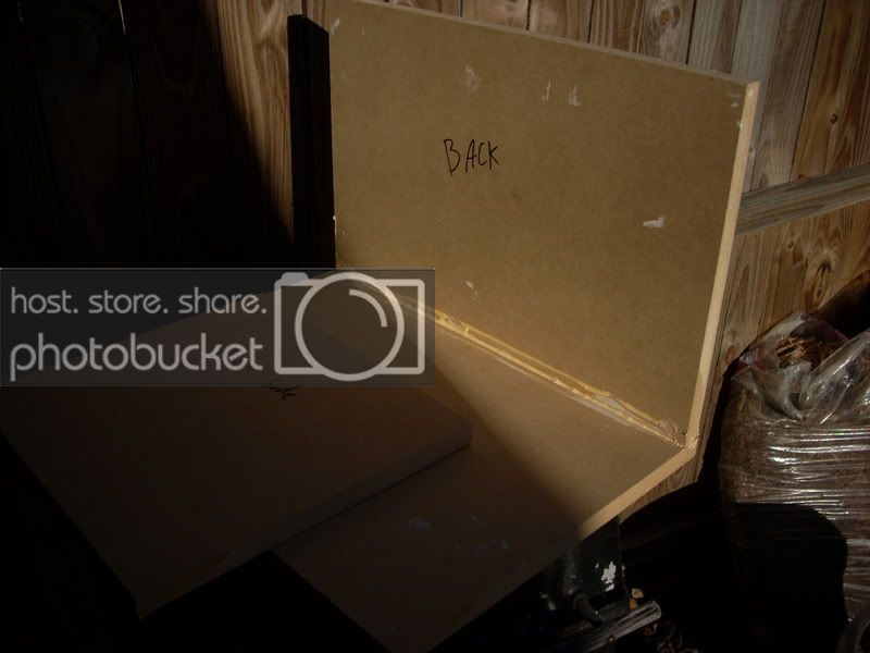

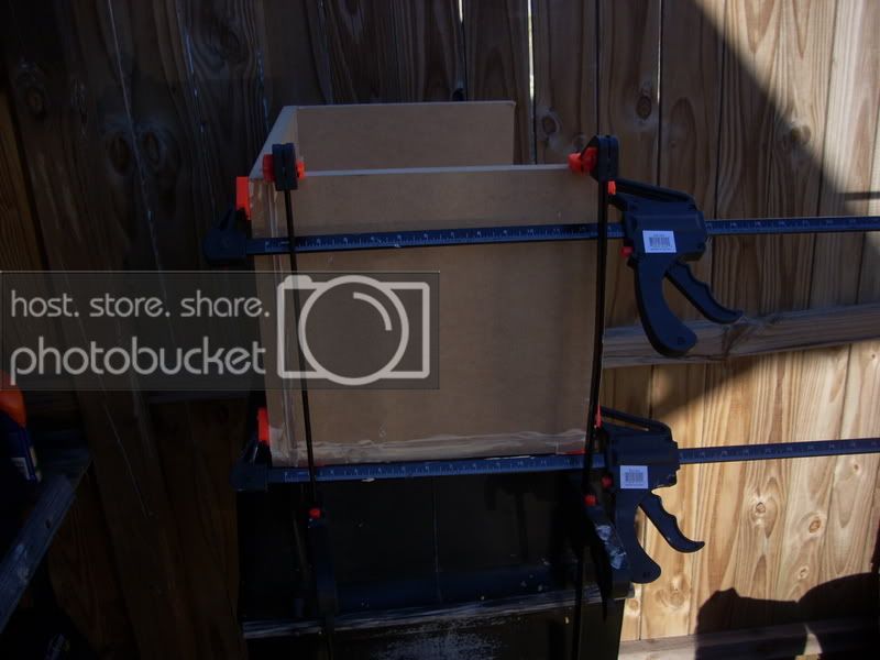

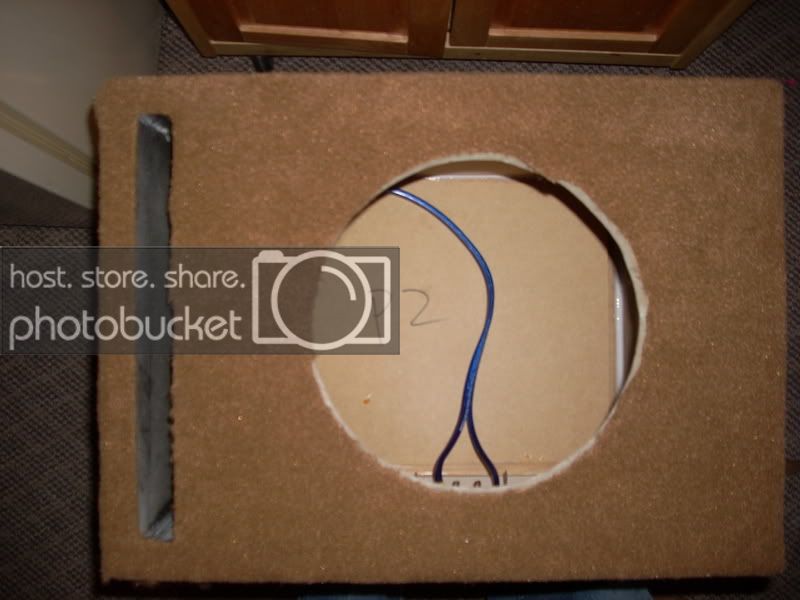

Made some progress today got the box done!//content.invisioncic.com/y282845/emoticons/biggrin.gif.d71a5d36fcbab170f2364c9f2e3946cb.gif now all i have to do is carpet it tomorrow.

Its actually not as hard as I thought it would be this is the first box I've ever built. I have done a lot of research on box building and I have carpentry skills from working in construction. My best advice is to just jump right in and go for it. That's the best way to learn.

i forget who's build log it was, but,someone else just did a box for a jl sub and said their specs are on the small side. i'm sure it'll sound good though and if not, more experience building boxes coming up-lol.
Does the Port seem narrow? Im sure its like 1" but just curious
Looking good though //content.invisioncic.com/y282845/emoticons/smile.gif.1ebc41e1811405b213edfc4622c41e27.gif
Yea its a 1" port it is kinda narrow but that's what the JL specs called for.

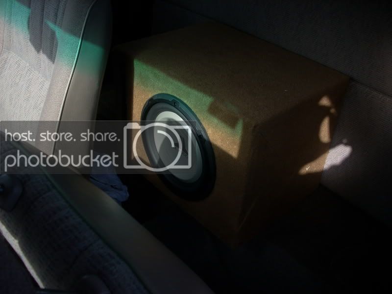

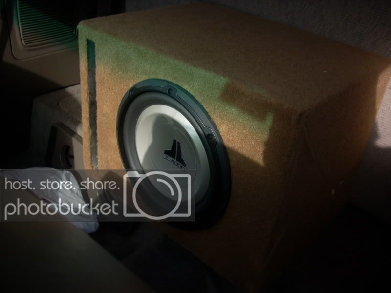

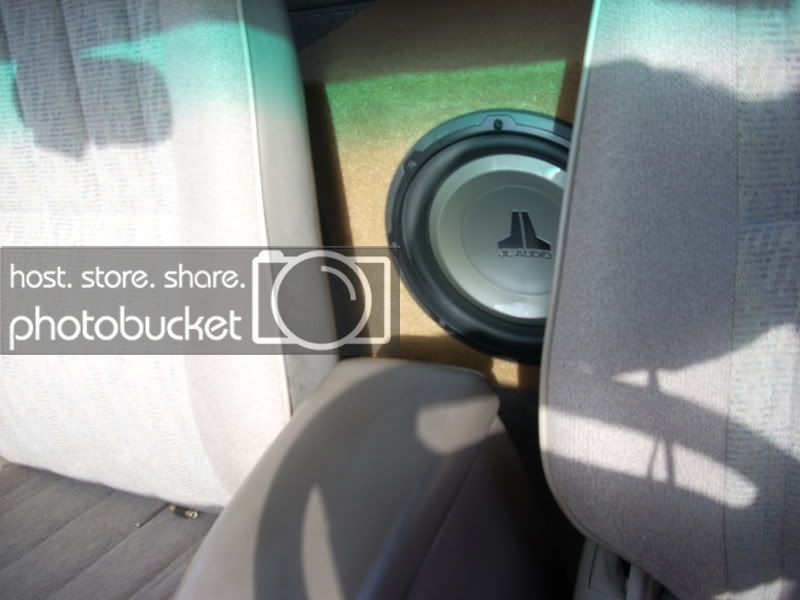

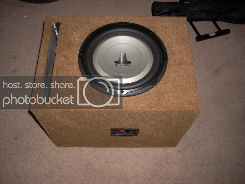

Update!!! Got it carpeted this morning. Added some pics to show what its gonna look like inside the truck.
