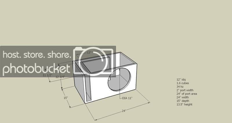

Enclosure: 1.6 cu ft (net) tuned to 35....plans

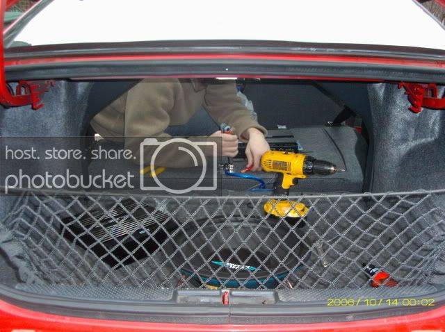

Running wire for amps

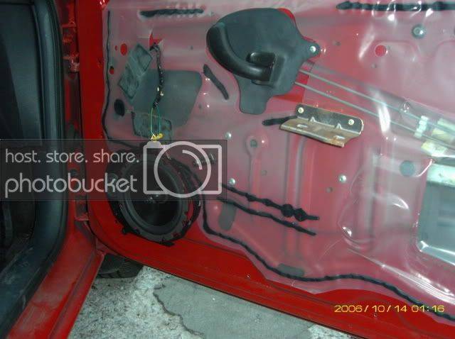

CDT's installed in door

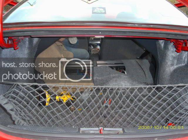

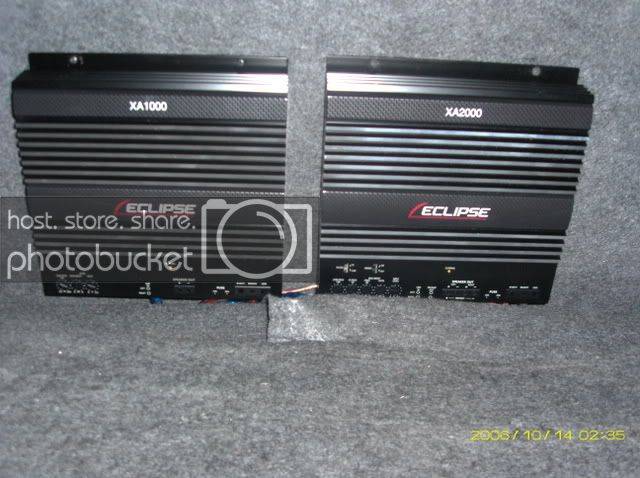

Matching Amps Mounted:cool:

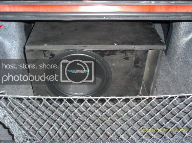

Sub being mounted
Sub In//content.invisioncic.com/y282845/emoticons/smile.gif.1ebc41e1811405b213edfc4622c41e27.gif
Carpet that box & deaden those doors! Other than that it looks pretty clean.//content.invisioncic.com/y282845/emoticons/thumbsup.gif.3287b36ca96645a13a43aff531f37f02.gif

X2 on deadening the doors. Would make a world of a difference.

eh.. i am not a huge fan of the speaker wire coming out of the port.. it is not very professional looking, or clean at all.. drill a hole and use some silicone or a cup terminal or something.. i also dont think i agree with mounting the amps directly to the seat backs.. a lot of times that plastic or fiberboard doesnt hold very well after some time
but i like the equipment... and commend the effort.. but next time.. take a little more time so u wont have to fix it later.. cuz frankly.. yer gonna have to fix that install down the road

it's still screwed to the seat back.
i do understand what you're saying though.
i have my 120a2 on the back of my rear seat. but the part its mounted to it around 1/4" of plastic and i do not see that failing any time soon.
personally i dont see that being a problem either. much easier to adjust/tune your amps when all you have to do is fold the seats down. i agree there are much better places to put them or even build an amp rack with minimal effort. but again , i dont see it as a big problem at all.
not a bad install minus the lack of deadener..
but with the added support it disperses the weight from the screws holding the amp to the seatback to the wood or metal support.. making for a more reliable mounting solution
kinda like laying down on ice rather than standing.. same structure, but weight more evenly distributed
