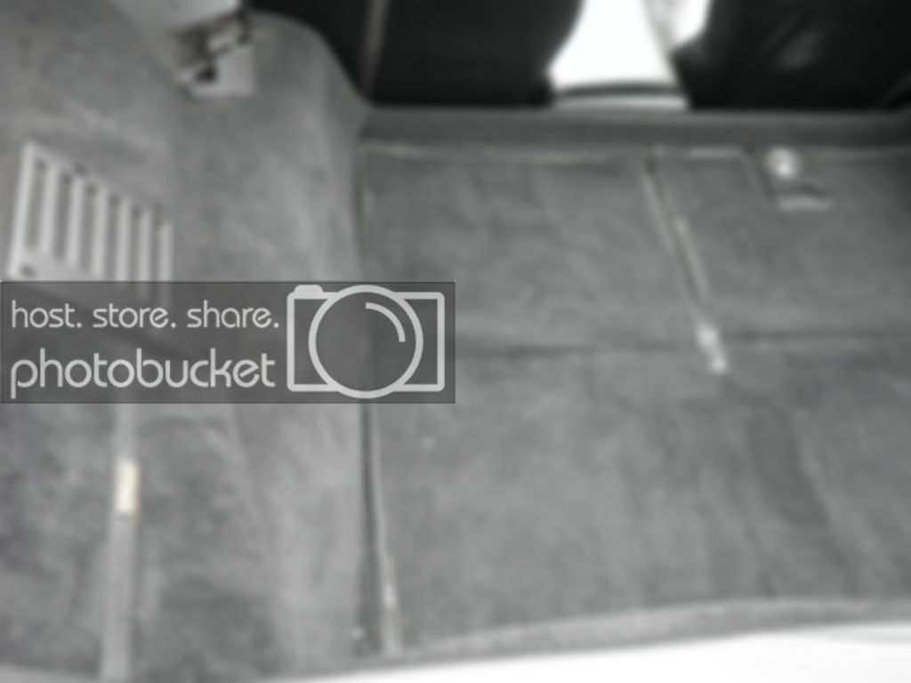

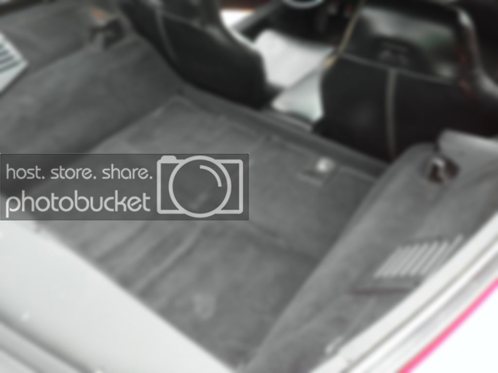

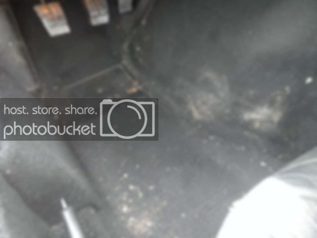

Some pics of the area where the top,sub and amps will need to go.

You can see the front speaker box to the left in front of the E-brake handle. The 95 doesn't have speakers in the doors. Also the front of the car and door have been matted, I have the SD matting to do the rear, but was waiting till I started the system install, so I only had to take it apart once.
Please excuse the dirty carpet.LOL I have a dirt driveway.

That's fine man I've seen worse of 30 years of installing so I can keep you in that $1500 range pretty easy. You still need a big 3 kit. Rcas and speaker wire as far as wires go tho
