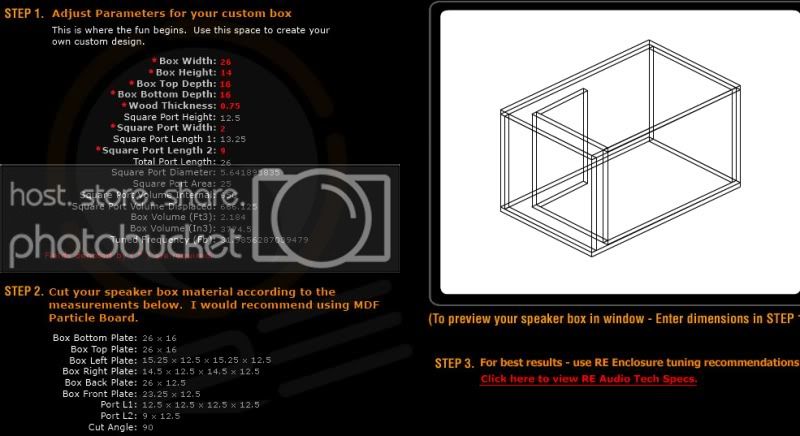

how does this look? 2 cubes, 29" of port
and is .75" mdf the norm? or would it be ok to go down to .5" mdf with smaller subs?
.75" would be wanted. And small bracing even could be used for this application.
2-2.5 cubes should be fine.
That looks better for port area. But you only have 12.5x2=25. Could go 12.5x2.25 and simply adjust length/airspace (displacement) accordingly.
