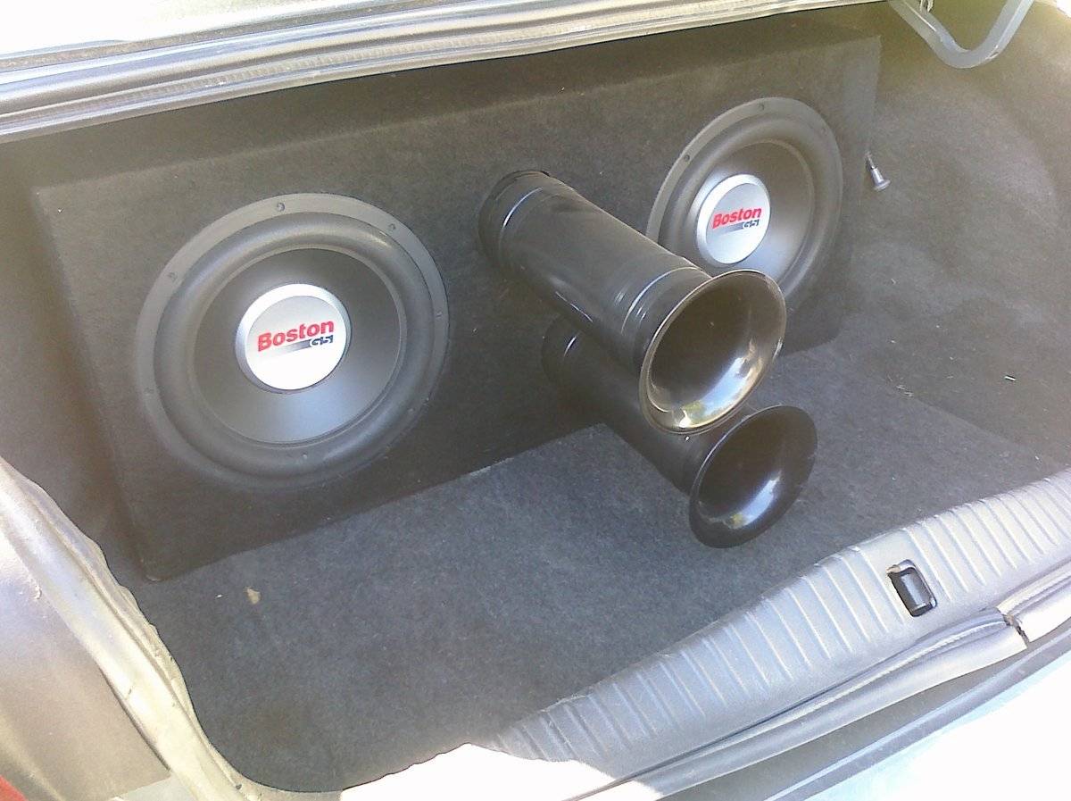

**** revrider youre a posting fool. Copy that, heres another one for you. I couldnt get ahold of anyspeaker wire today, and of course i wanted it to work today, so I grabed some 20 gauge and doubled it up, as in two wires to each place. Its not copper, its steel me thinks. Seems to work and they dont heat up, but am i losing anything besides looking like a ghetto *** fool? ALSO the diaghrams for the subs i have (wire at 4 omhs) show the connections from one sub to the other right on the sub itself. I just wired to both of the straight from the amp. Maybe i picture will help. Does this change anything?

**** revrider youre a posting fool. Copy that, heres another one for you. I couldnt get ahold of anyspeaker wire today, and of course i wanted it to work today, so I grabed some 20 gauge and doubled it up, as in two wires to each place. Its not copper, its steel me thinks. Seems to work and they dont heat up, but am i losing anything besides looking like a ghetto *** fool? ALSO the diaghrams for the subs i have (wire at 4 omhs) show the connections from one sub to the other right on the sub itself. I just wired to both of the straight from the amp. Maybe i picture will help. Does this change anything?View attachment 5218
