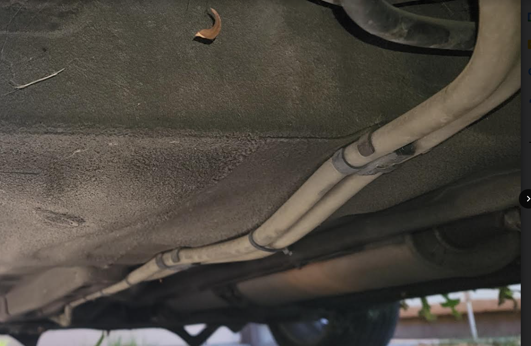

I know the owner of a loca shop here in town, he knows I know my $hit. Even then, when I go to his shop to have them do certain things, they won;t do all of it. I bent over and purchased the big three plus labor so they would install it. They won't if it isn't stuff they carry, I get it and understand that part too.
So, when i pointed out that I had purchased 2/0 gauge tinned OFC copper marine grade cable fro the +/- grounds, they were cool with running it from the engine compartment, under the car to the rear of the hatch because they only had 1/0 and 4/0, no 2/0 to sell me. I also paid for the dash kit that allows everything to work with the original factory settings on the steering wheel too, it's the least (or most) I could do - and frankly worth the extra $$, too much time for me to do it.
Therein lies the rub. How much can you do and what if anything will they do (of that which you can't or won't) for a price. I don't mind paying them to do the work, but 20-40% mark-up (common but not to bad here) for the equipment is just too much. If you can get the infrastructure done, then some of the stuff like speakers, sound deadening, amps, especially LABOR everything shy of tuning the system, would save you a ton of $$.
