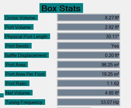

What are your enclosure specs? I am thinking 5.0ft3 Net with a 38" long 100in2 port. I want to be able to hair trick a little and still get up on the meter.
What size sub?
2x NSV4 12s. My max dimensions are 39W, 14H, 32D. 5cf net, 96.25in2 port tuned to 33hz seems like the best balance. Port velocity ends up peaking at 18.5m/s.
Something like this:
You don't need that much port area. Those subs do move quite a bit of air, but I think you will lose some bandwidth and not really gain much from that much port area.
28448
Does this seem better? I just want highest SPL between 28-38. Thanks for the advice btw. I am just worried about port velocity being too high.
