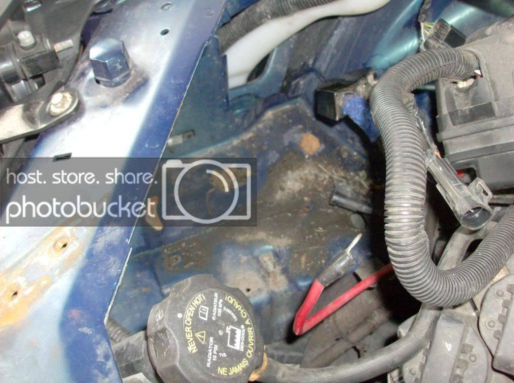

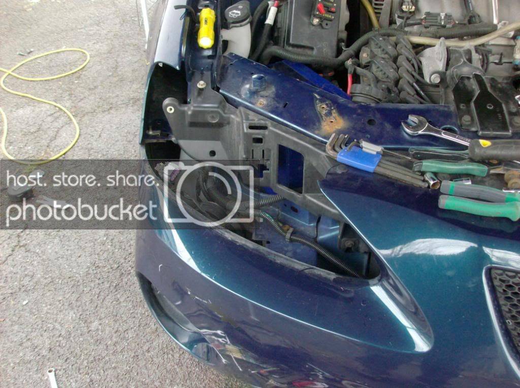

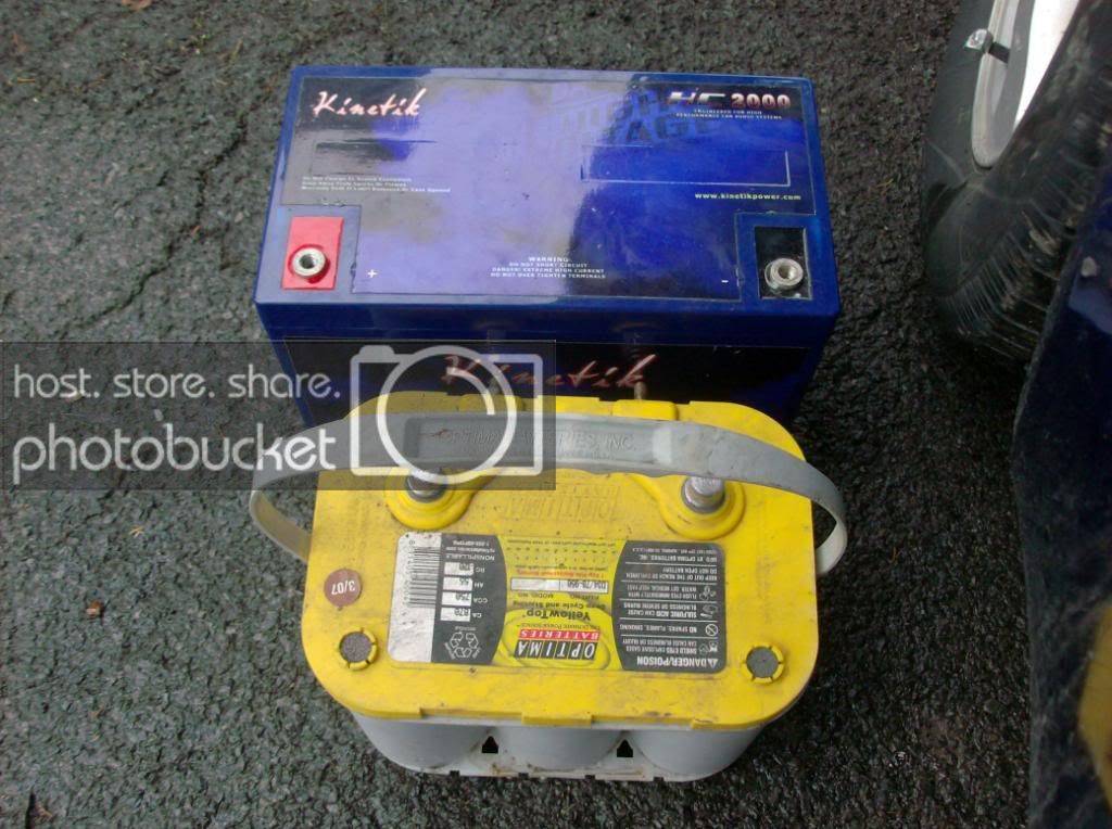

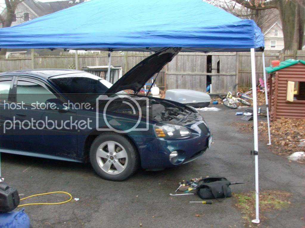

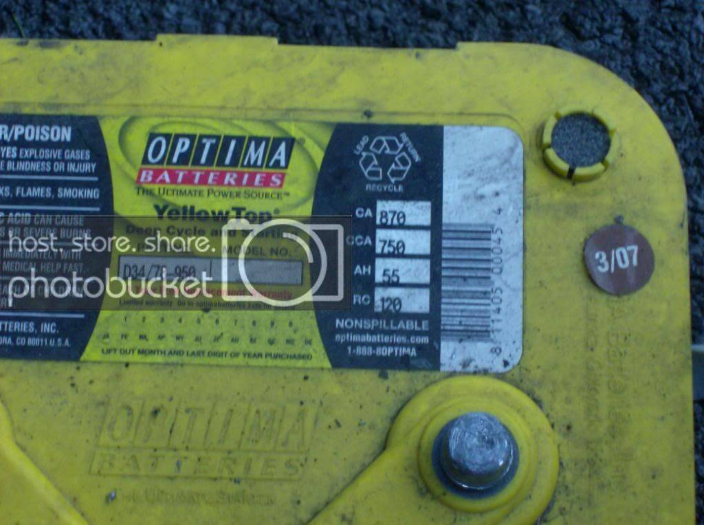

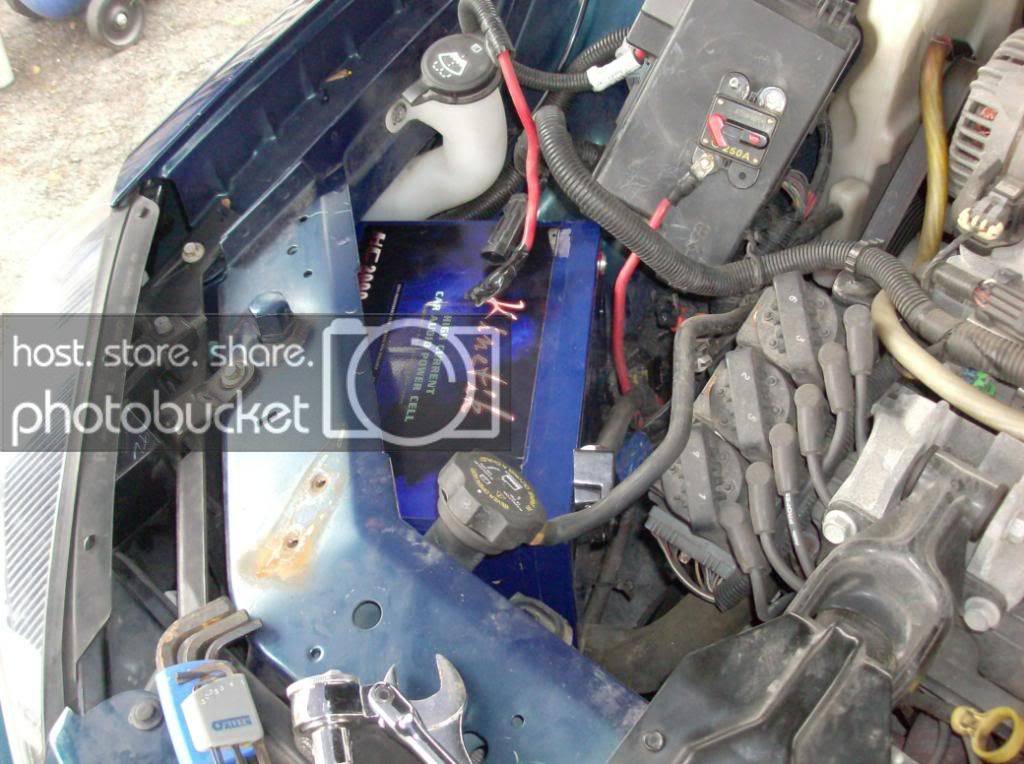

Finally took out the Yellow Top and went through hell getting this **** Kinetik 2000 in.

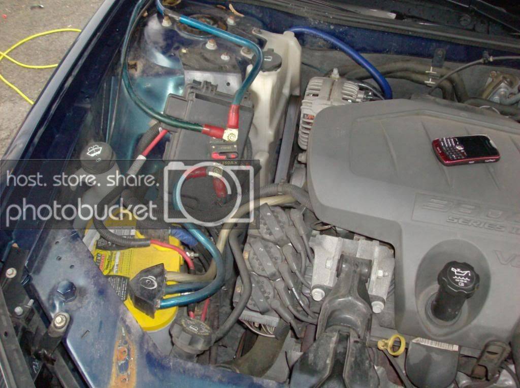

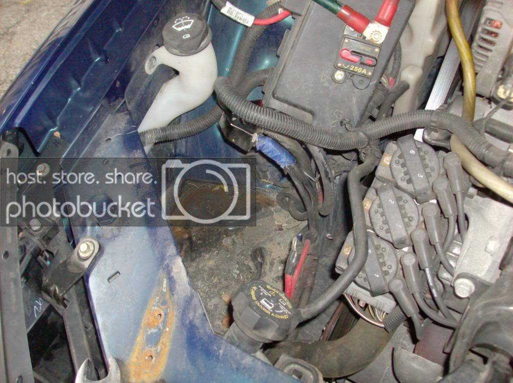

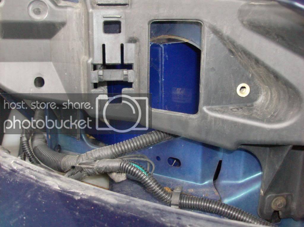

For those with an 04 or newer GP a 2000 does not fit without modifications. Battery tray has to come out(Gotta find new way to secure it, I used gas tank metal strap), gotta trim the overflow tip down off the radiator to fit batt underneath it. Gotta pull headlight to help make it easier to secure batt. And of course all the **** wires,hoses etc...
It was a long day but its done
At the end of the day I can run 90% volume musically at .5 nominal and stay above 14v at the amp. With absolutely no sign of clipping //content.invisioncic.com/y282845/emoticons/wink.gif.608e3ea05f1a9f98611af0861652f8fb.gif
What do you have for a batt bank?
5 Kinetik 2400's and 1 kinetik 2000 3 runs of 0:D
