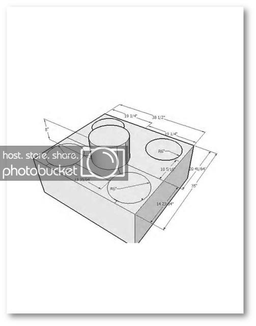

this is my plan
SmokeyDog
going to put a new top on my box this is what i came up with what do you think
12'' round port 8 out 5..03in
box is 38.5 w
35 deep
15 high
tuned 38hz
I think external ports are ugly as hell...
me too but i have to work with the space i got dont really care what it looks like
