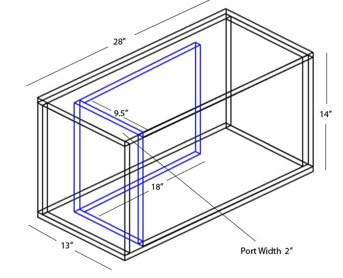

This box design seem ok for a couple 10" Dayton RS HO's?
doox00
This box design appear to be okay for a 2 10" Dayton RS HO's? Has 2" wide square port, according to the app I used it should be tuned to 32.8 and 1.73 volume before speaker displacement.
Can you put two in the box sharing the same space or should they be sealed from each other with each their own port?
thanks all
I don't have time to model it tonight. But it seems fine at a glance.
On the second thought, I would add a brace from the front, between the subs, to the port. These are the two weakest parts of the box.
