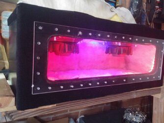

Posted this in the wrong section the first time.
Long story short, enclosure is .85 cu ft.  Subs say 1 cu foot minimum and 1.25 for optimal.  they are NVX NSW122v2 12".  I cant seem to find a spec for how much air they displace.
I know the effects of running subs in smaller enclosure but im wondering if this box is simply too small for these subs.  even with some poly.
Displace air? I'm betting you mean sub displacement?
Not seeing it either....but you're def choking the sub a little bit by giving it less airspace than the requirement needed.

Yeah your way to small, which will lead to very disappointing output. Displacement will be about .10
