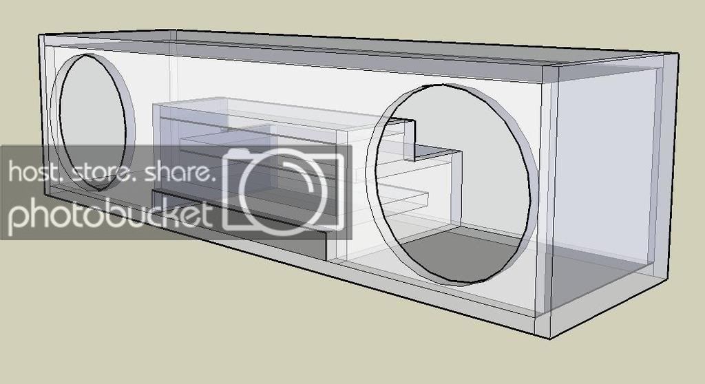

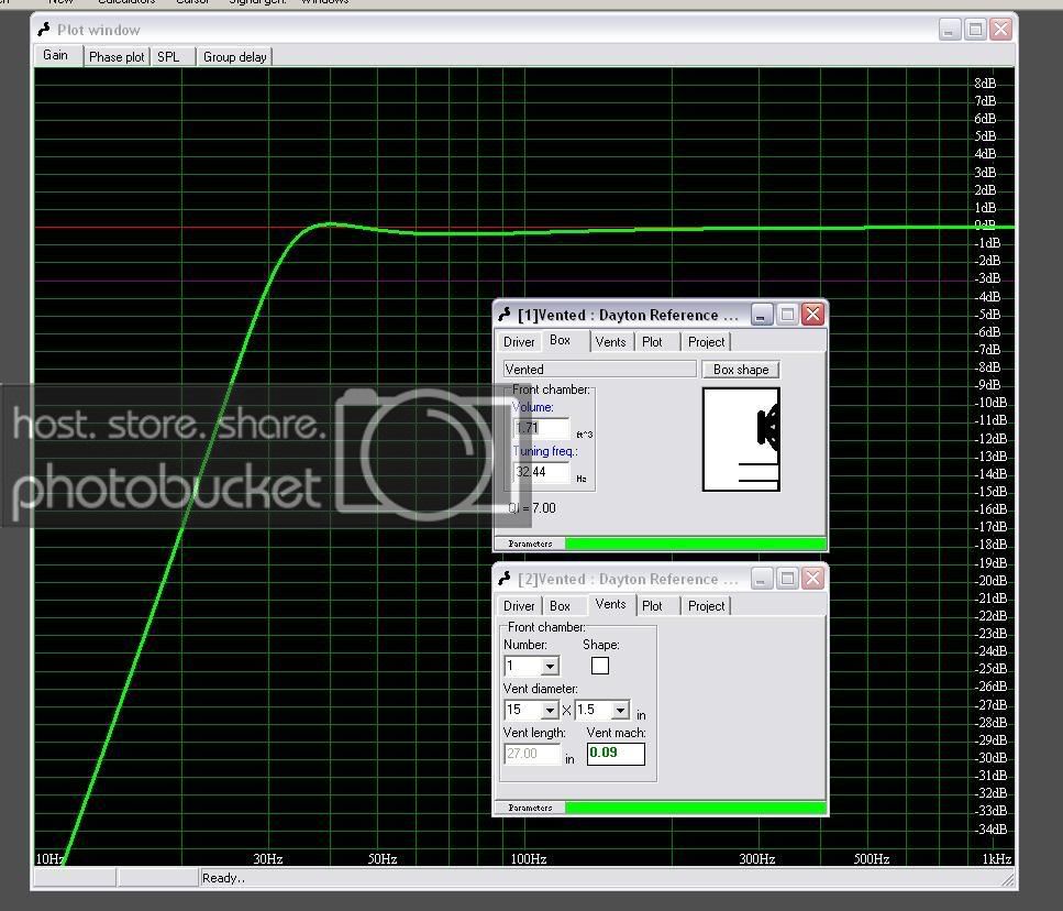

eff you fegz. (i dont care about dB's for those that havent got the hint) //content.invisioncic.com/y282845/emoticons/laugh.gif.48439b2acf2cfca21620f01e7f77d1e4.gif ok you lol'd. now serious'd. im about to start a new enclosure for some dayton ho 10s, given the winisd plot i had nik1818 do for me over at icix and the design, do you guys see any problems with the port design?i plan to roundover all the edges on the port to reduce port noise. thoughts? i want this thing to be most SQ oriented as possible, if its sacrificing to output ill go sealed, but according to playin with winisd by my dealings, and others... the ho's excel in a ported enclosure... just never seen one with a port quite like this.
I see no reason why that would not work.
