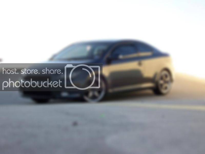

ok folks, thanks for all the help/advice/info(made a new username). ive finally purchased most of my equipment and have found a little time to start taking out the old stuff to start on the new. its going in my 2007 scion tC (pix of the victim below). equipment will be as follows: thoughts? suggestions?

some pix of the culprit...

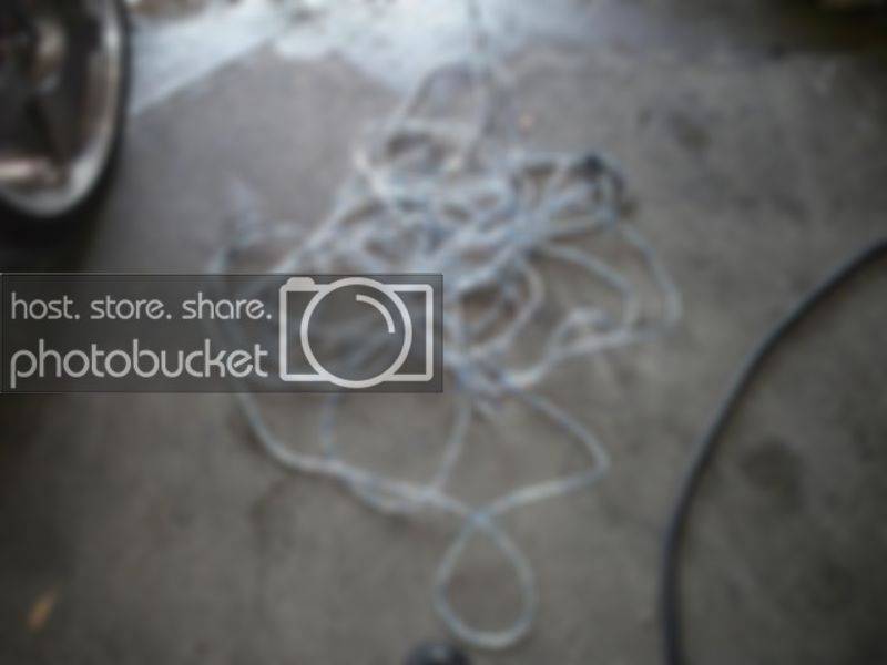

some pix of what i got started with...

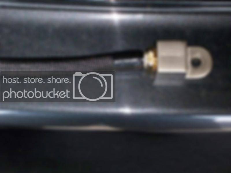

got bored and added a lil techflex to the main ground (no heatshrink yet)

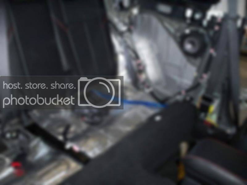

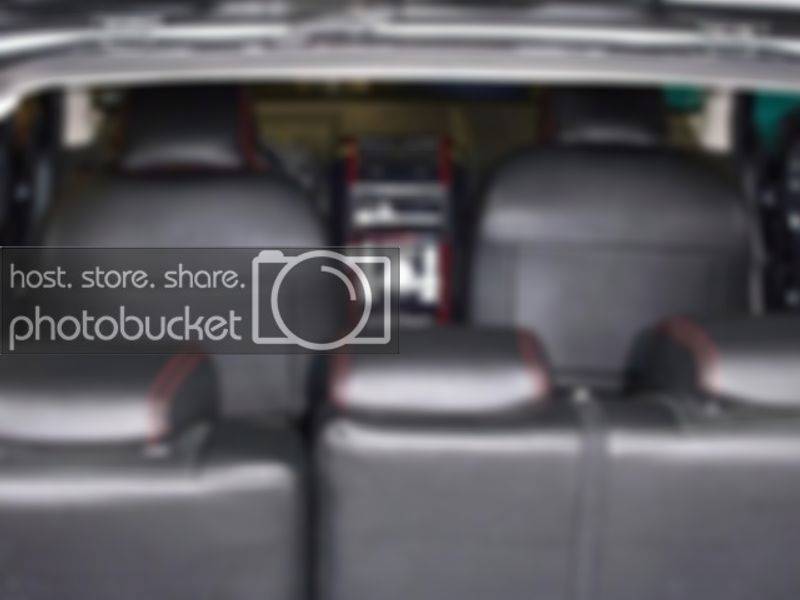

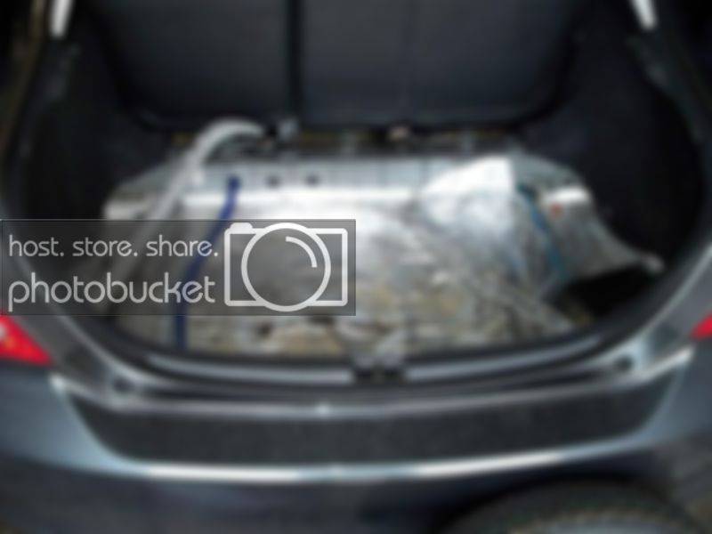

got this crap out

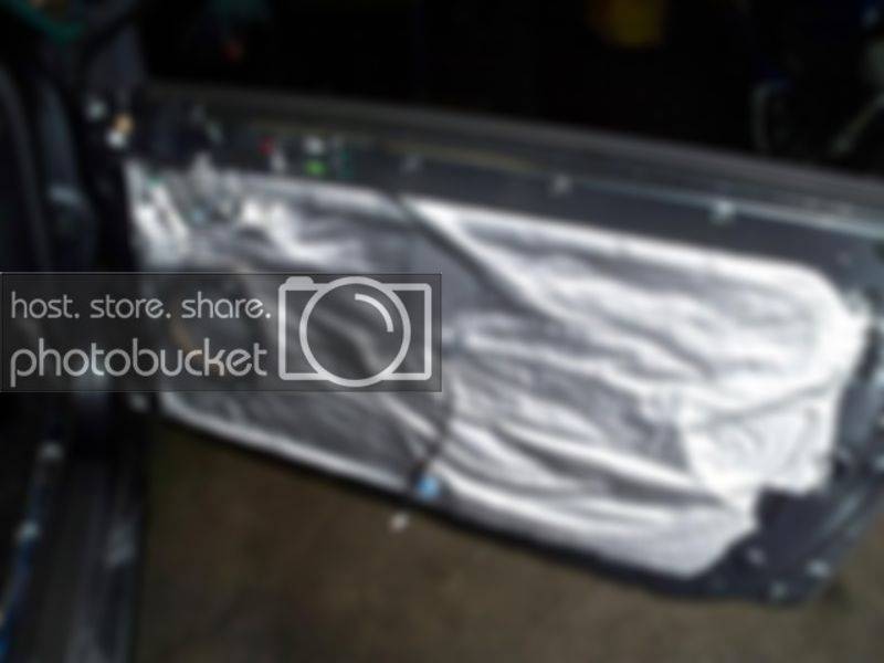

some deadening

are those rota p45's btw?
you sir, know your wheels. rota p45f in bronze... however, the center caps provided wont fit over my front hubs, so i have to get some raised ones... i just dont feel like spending the $50 for em //content.invisioncic.com/y282845/emoticons/eek.gif.771b7a90cf45cabdc554ff1121c21c4a.gif i love the way they look on my color, got a deal on em @ $750 shipped
btw 18x8s
