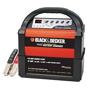

I got one of these a while ago...just a re-badged Vector, which is who Kinetik used to OEM their charges back in the day.
Amazon.com: Black & Decker VEC1093DBD Smart Battery 40/20/10/4 Amp Battery Charger: Automotive
schumacher electric is a legit engineering/manufacturing company who makes battery chargers (here in IL). they aren't rebadging B&D crap.
this:
is not a rebadge of this (your link)
the specs are totally different, let alone the B&D doesn't support 6V batteries with fully automatic (not manual) charging, or the charge rate differences.
i agree B&D purchased Vector MFG. But SE is a different company with different (IMO superior) products.

I was commenting on the B&D that I have, which is essentially the same as a Vector. I was making no comparison to the Schumacher charger you linked to. I actually bought one of the large Schumacher chargers, one of the automatic units that has wheels...seems to work alright.
Also, can you give me some reasons as to why you feel Schumacher chargers are better than Vector ones?

Ah, sorry for the misunderstanding.
Once a company is acquired, it is open to change, change such as cheapening the guts to make the acquisition more profitable. You'd have to open up a pre-B&D and a post-B&D to verify. I consider B&D to be below average. Maybe I'm wrong and since 2006 B&D hasnt made changes to Vector MFG, but I doubt it. The economy hit affected everyone.
It is akin to car audio company acquisitions. Buy the name to use it to make money, not to provide the same quality product.
