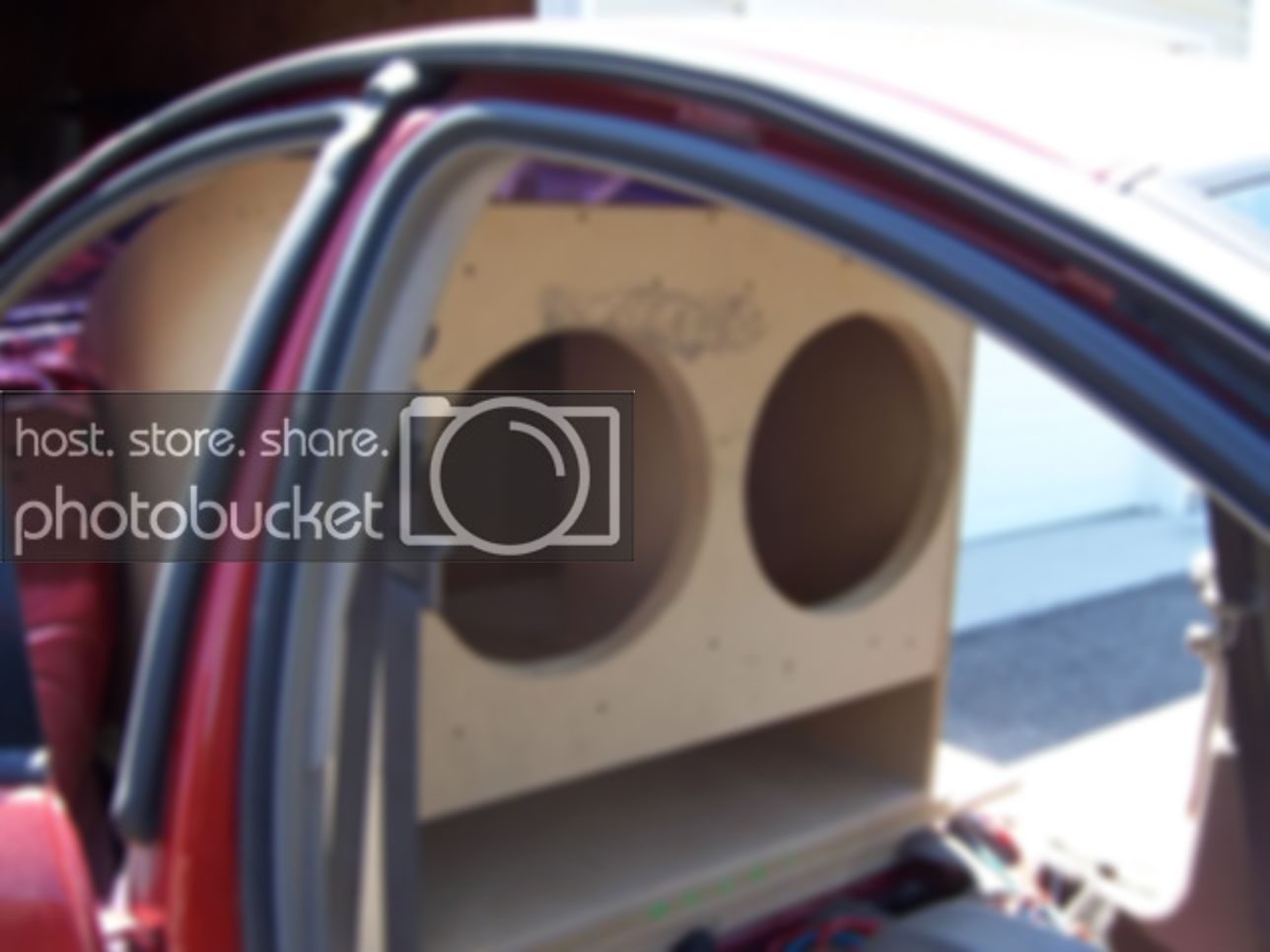

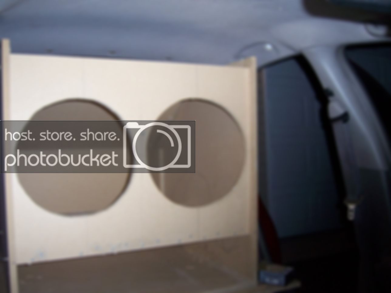

the front baffle.
Its double baffled, and i broke my jigsaw trying to make it. Awesome nonetheless

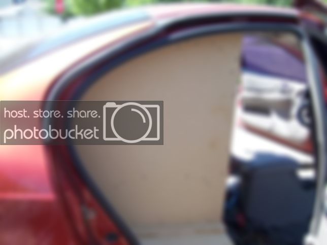

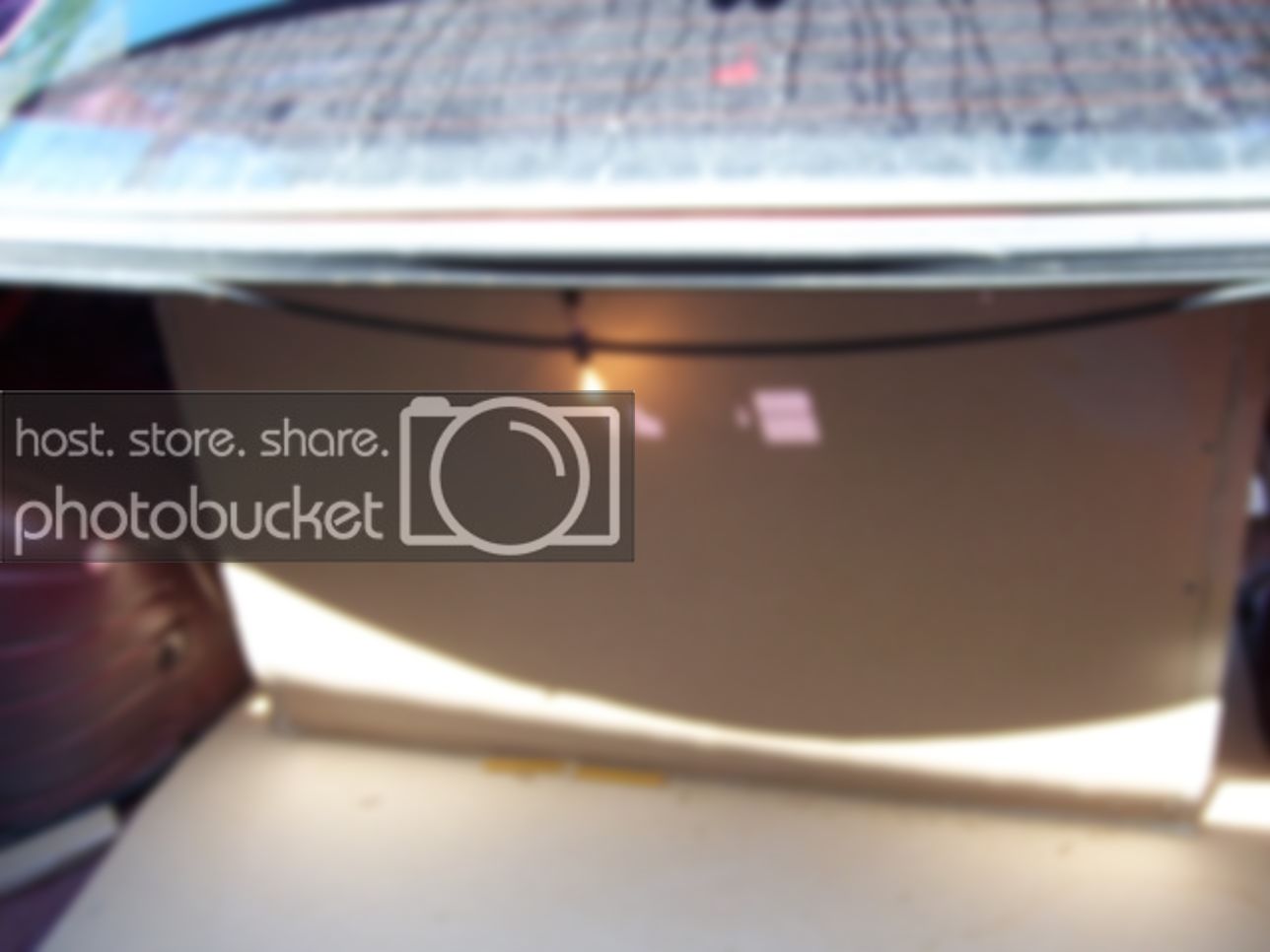

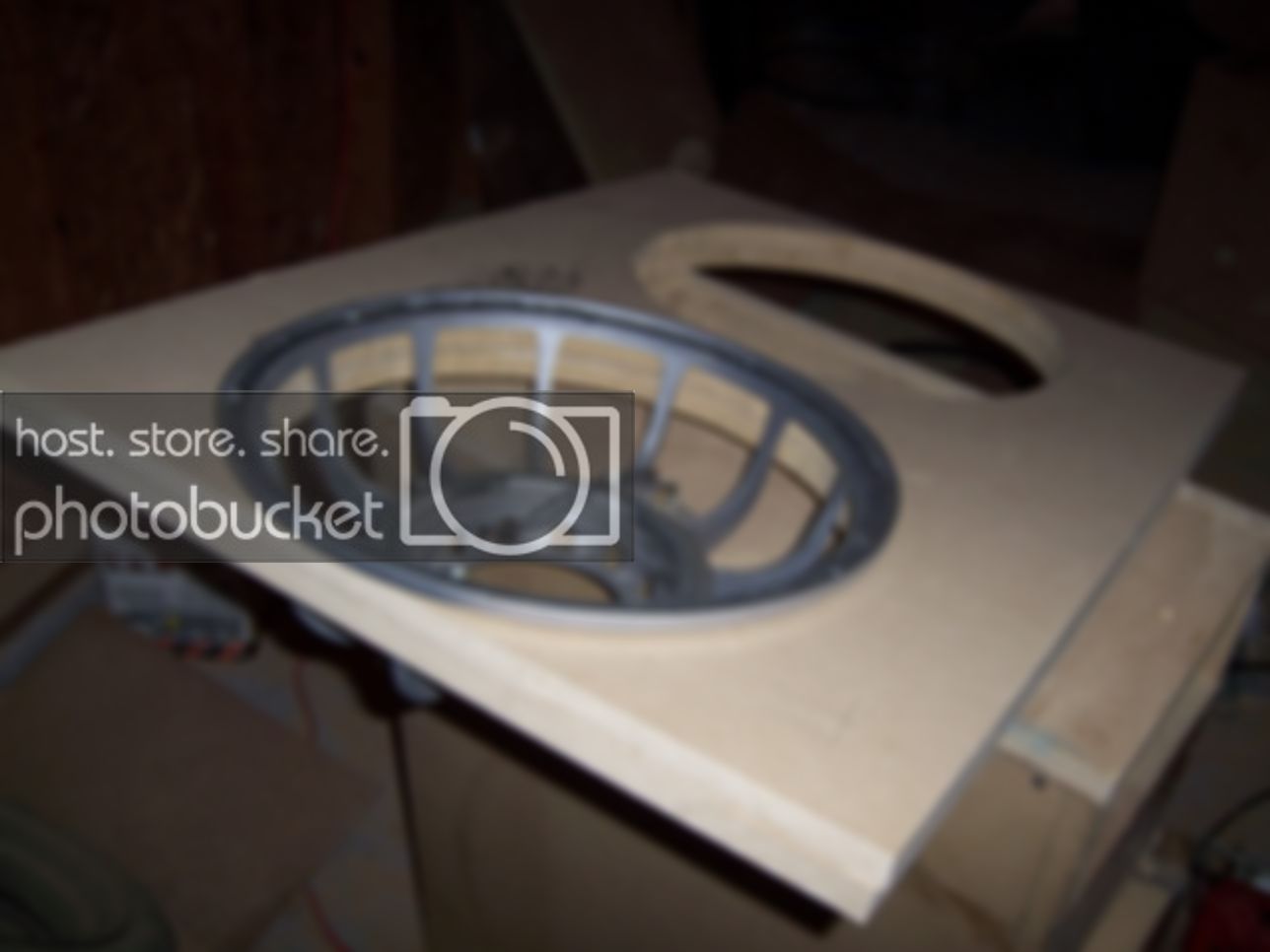

Another test fit of the top
I probably did more testing than anything, the whole time keeping the big picture in mind......its ugly as all hell, but its gonna be **** loud.

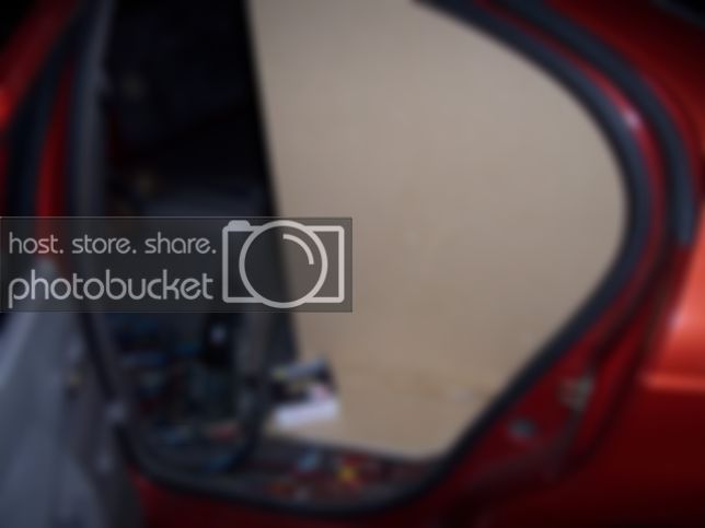

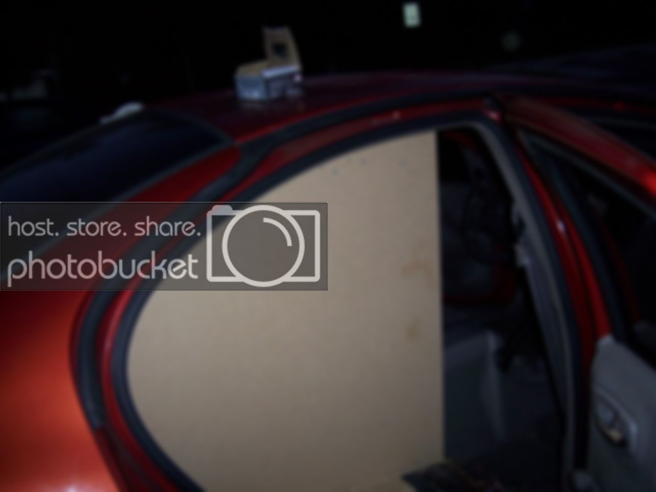

A night shot of the side..

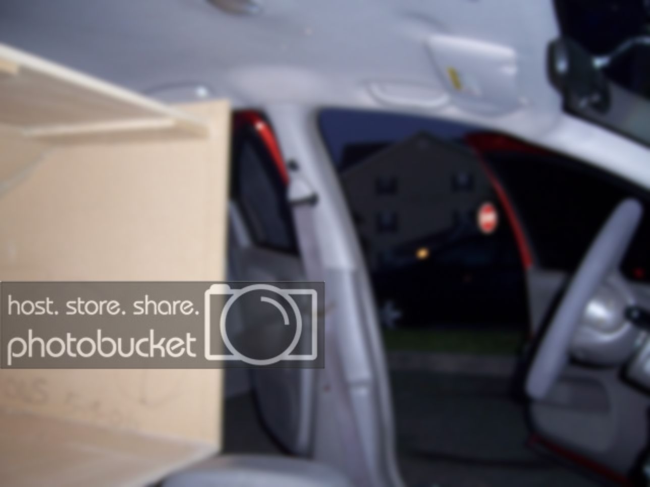

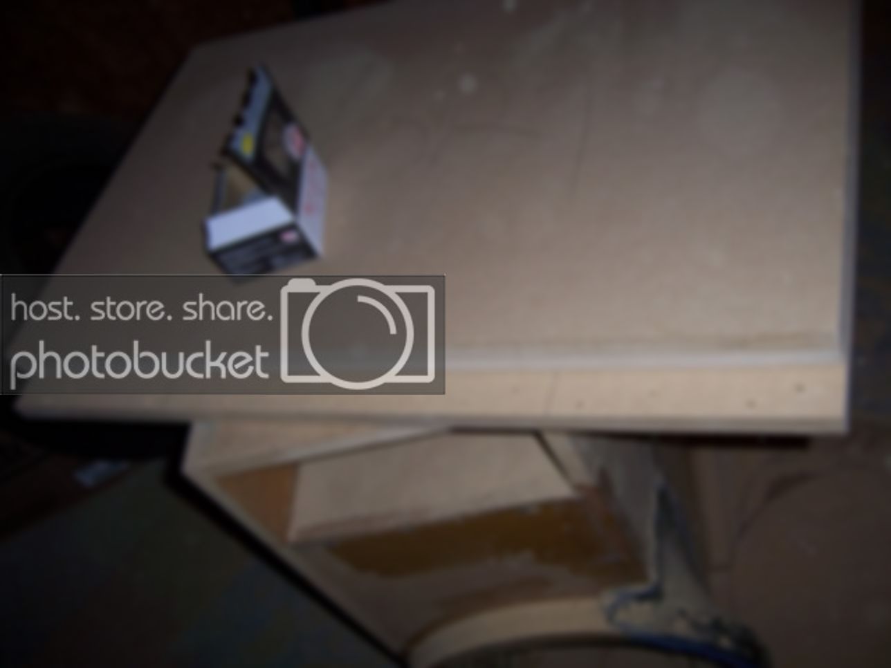

something i advise that you never ever ever do

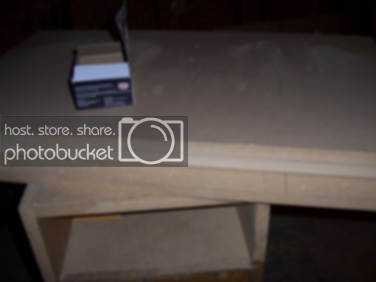

Put the top piece in without screws.
not the top, but the angles top. I was under the impression, that glue would hold it here. boy, oh boy i was wrong. I had to sut the top at a 30 degree angle, and it was deinately the most difficult part, and it took near 4 hours to get it cut right. I would have to say again, that it as the most difficult part. I was able to squeeze a bit more airspace.....which is always a good thing.

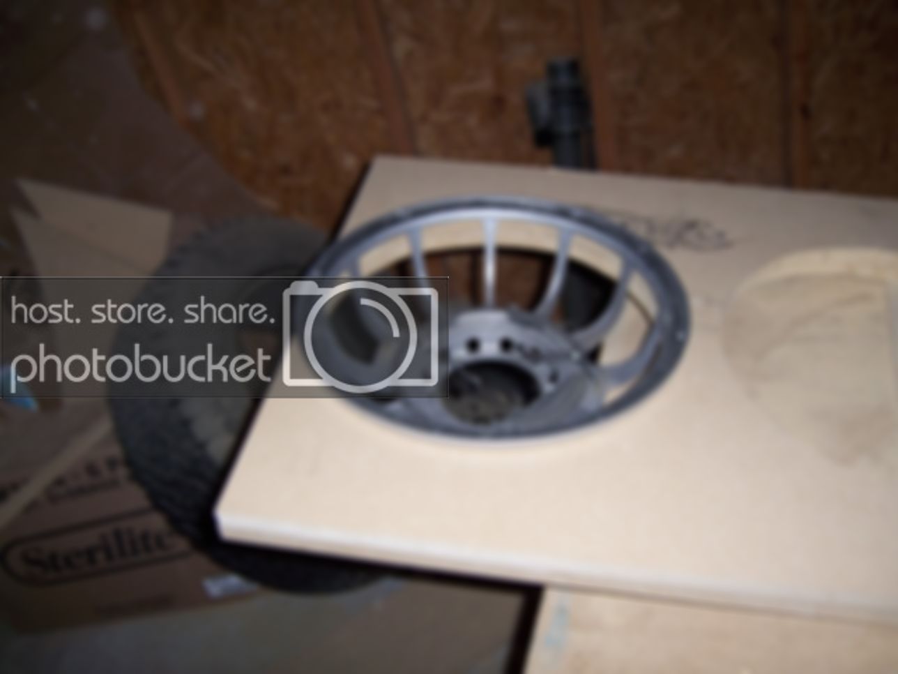

thats a test just to make sure they fit. they fit.
gotta love spare baskets
and another angle of the test fit..
A double test fit

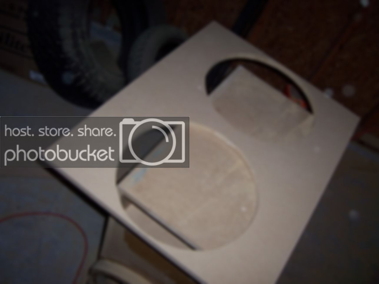

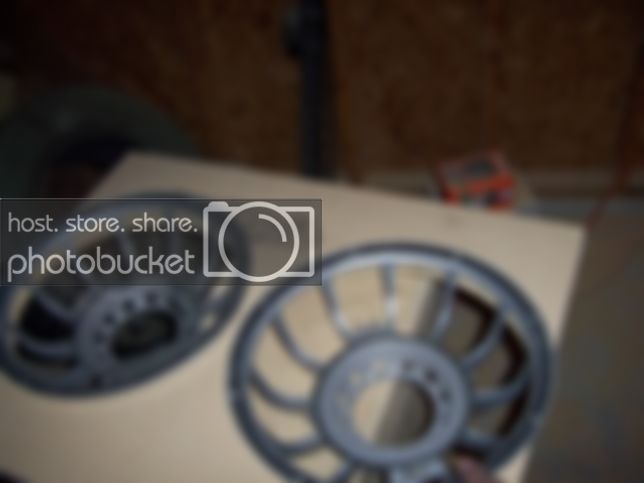

really making use of those spare baskets. Wishing i had spare 12 baskets too.
the one on the right, it looks like it doesnt fit......thats because it didnt, but it did after sanding down the ring a bit.

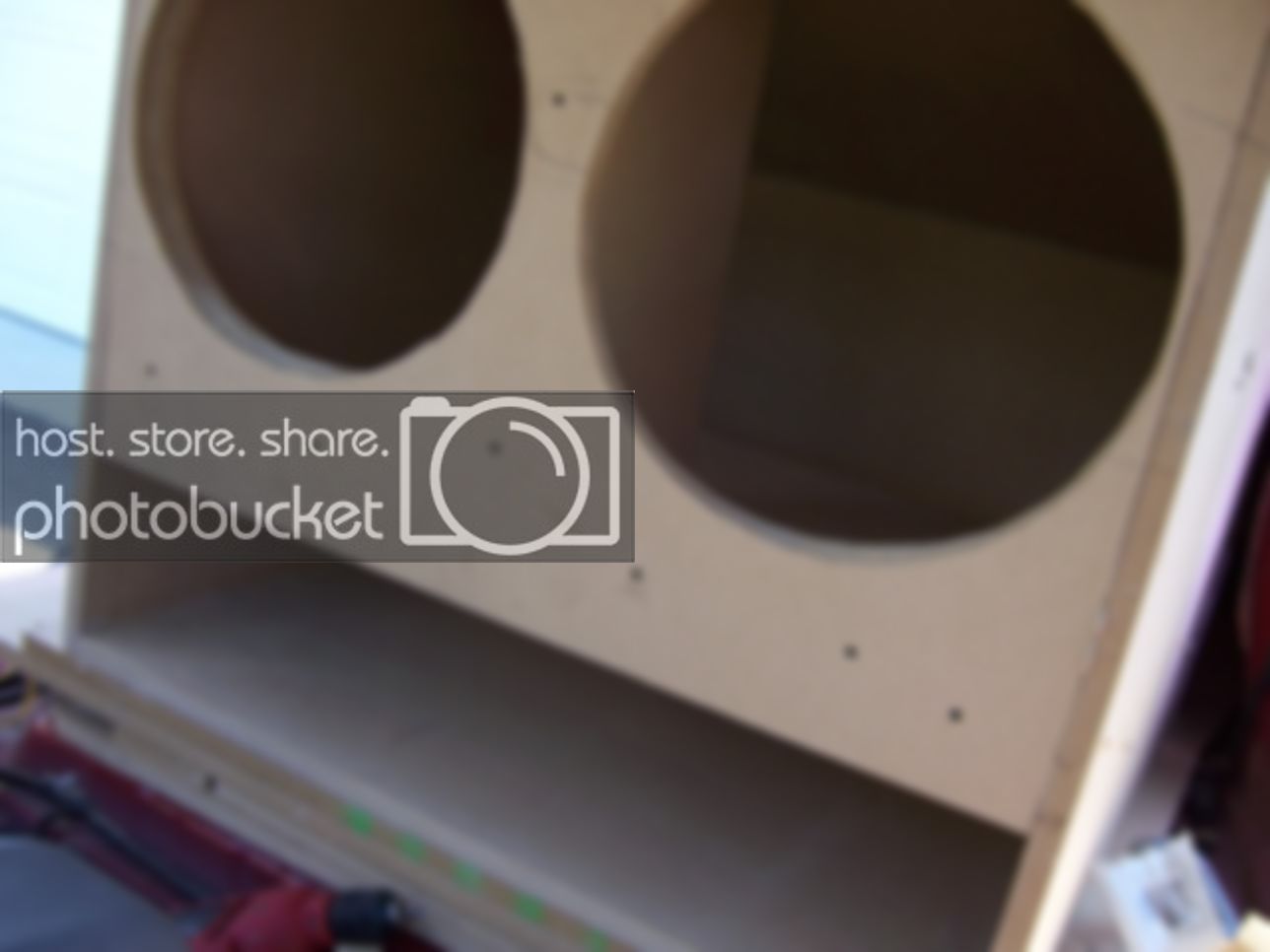

Here is a decent shot of the port. Port is Double baffled. I actually connected the double port baffle to the double front baffle, before i doubled the front up. that ay i didnt have to screw through 2 baffles, and expect enough of the screw to get inside the port baffle, to actually hold the two together.
another angle

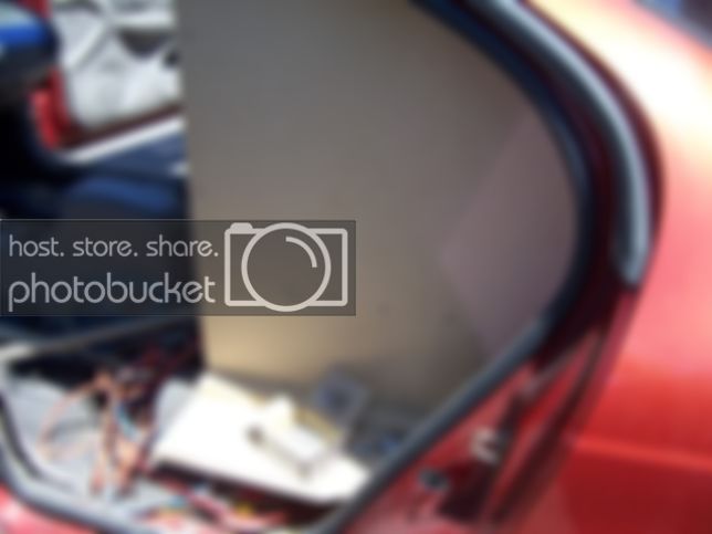

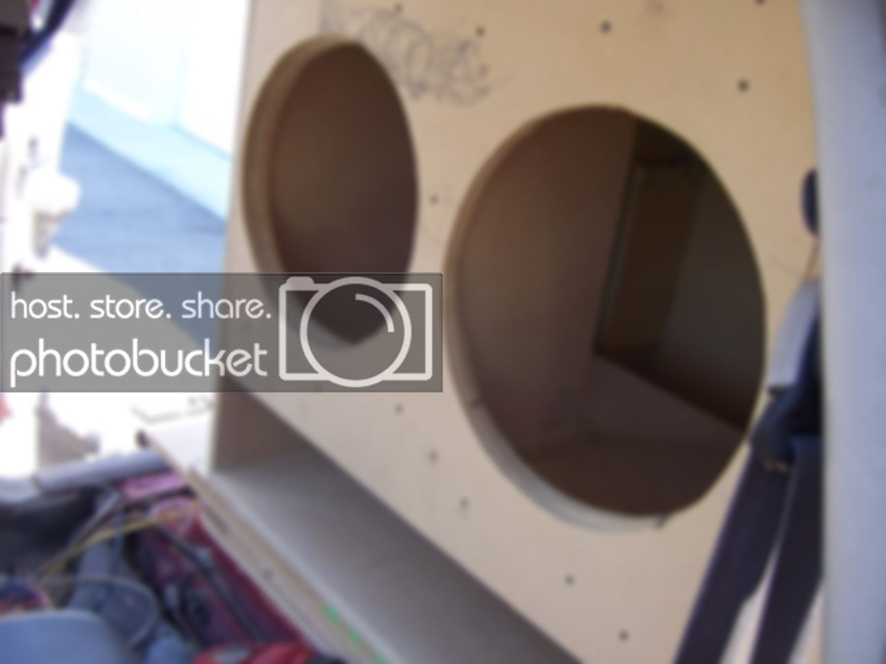

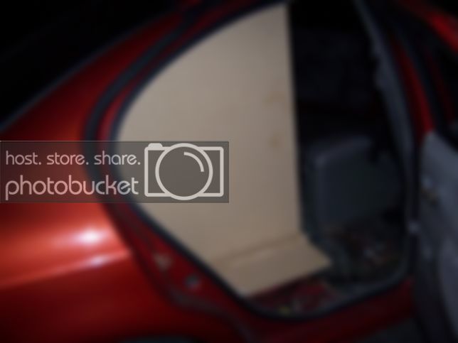

Night shots of the side again. I took lots of pics of the side for whatever reason
and the moneyshot.

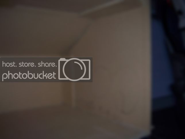

thats both baffles, and both ports, sitting in the box, but not attached in any way. I actually screwed screws through the box from the inside, at the top of where the port would "sit", in an attempt to add "runner" lines for the port, since i did the project solo, i neded as much help as i could get, and that worked out quite well.

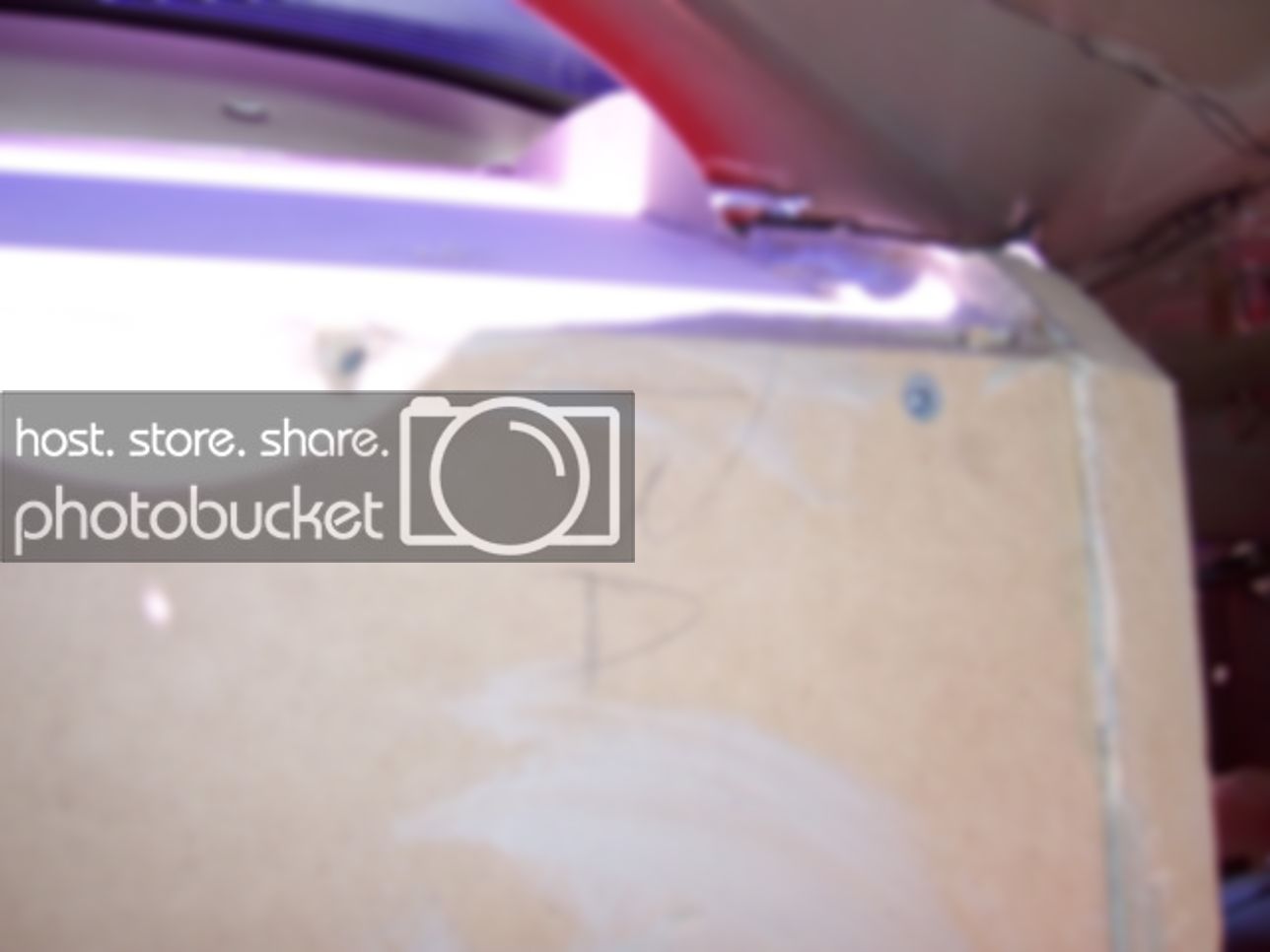

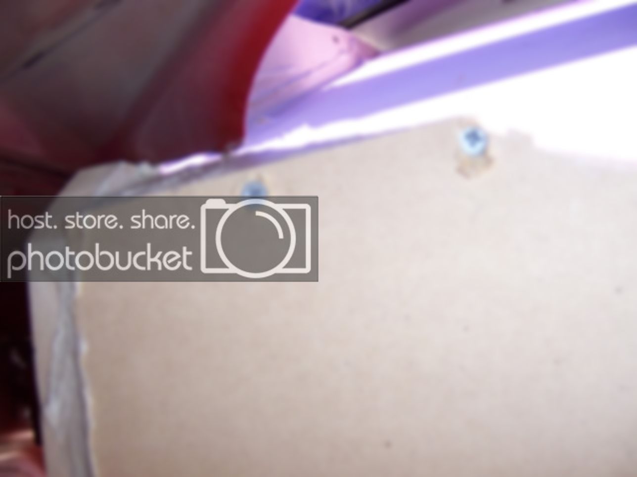

see the parts where it is touching the metal?
it makes a dang creaking noise while i drive and it too **** annoying, point being, its the onle mistake i made. I didnt cut enough of the back deck out.
sok though, Soon wnough, i will have a dremel to get the rest out. I just cant reach it with an angle gringer, without cuttong about another 3-4 inches out on each side, and thats not necessary.

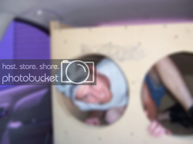

These are just fun shots, but this is my roommate, and he is 6'1"
in one hole, and out the other....I got it on Video.
