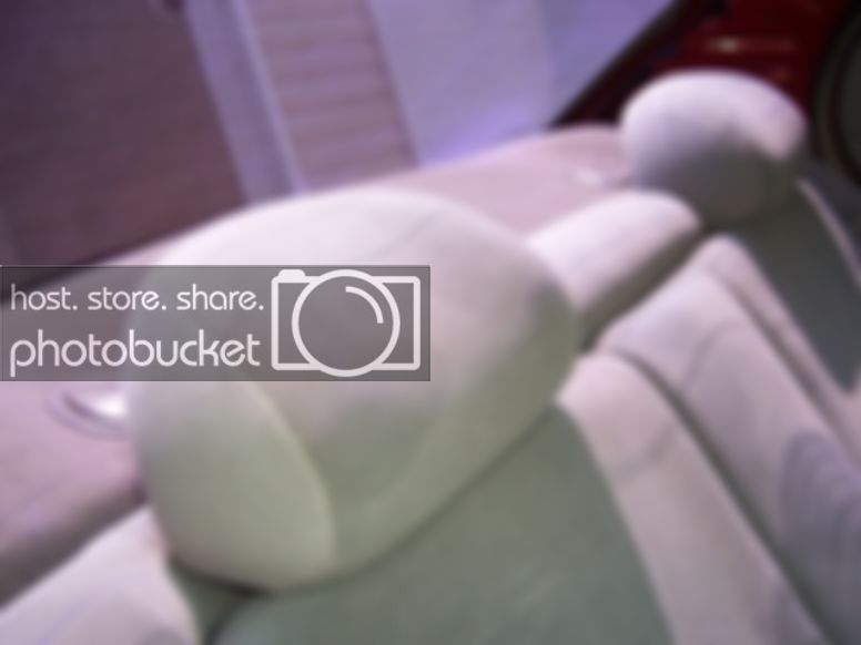

Speaking of going back stock........car rides the same. here is a pic of everything back in, seats clipped and bolted in place after the back deck was taken out as well.

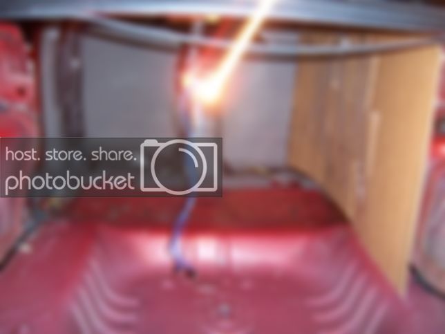

Now i knew the side was going to be hard...and getting measurements were next to impossible. but i did know what was important....total height, at the front of the box, and at the rear of the enclosure. Instead of just making a rectangle, i wanted to take advantage of the fact that i have 39 inches of depth to work with, as opposed to 17, if it did not extend into the trunk. I gained soooo much space, as well as stability, and mointing points (to the car) by removing the rear deck, so all in all, it was pretty much a must.

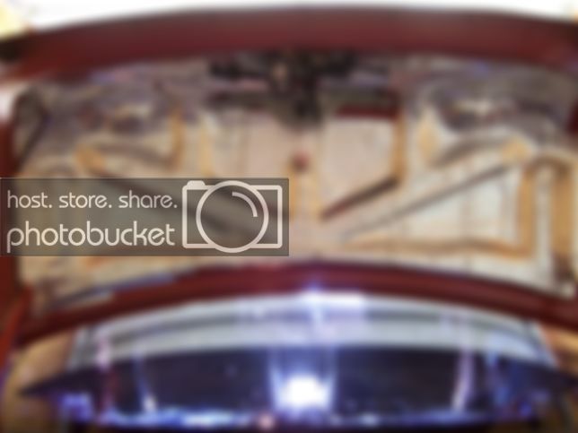

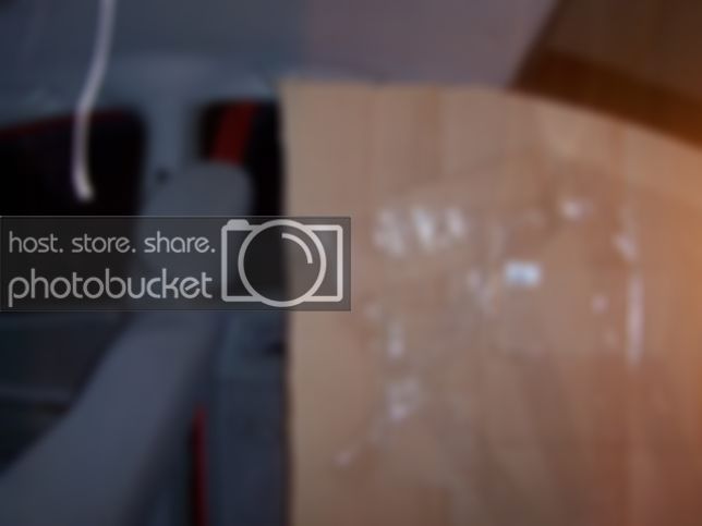

Here is a shot of the first time i implemented cardboard into building anything at all.....and i really didnt think it was going to workk, but it worked out quite nicely.
and another
And another

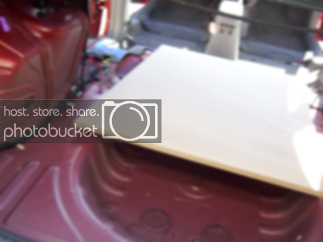

The original bottom, which is indeed the bottom of the enclosure, but it would have killed me had i not replaced it with something much larger, and more sturdy

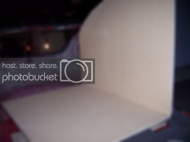

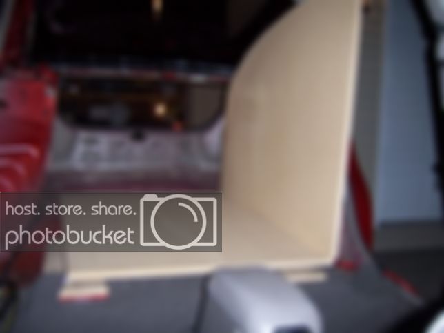

Testing of putting the side in

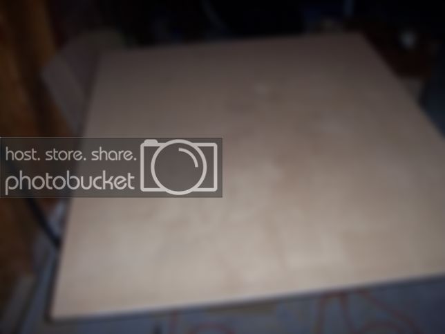

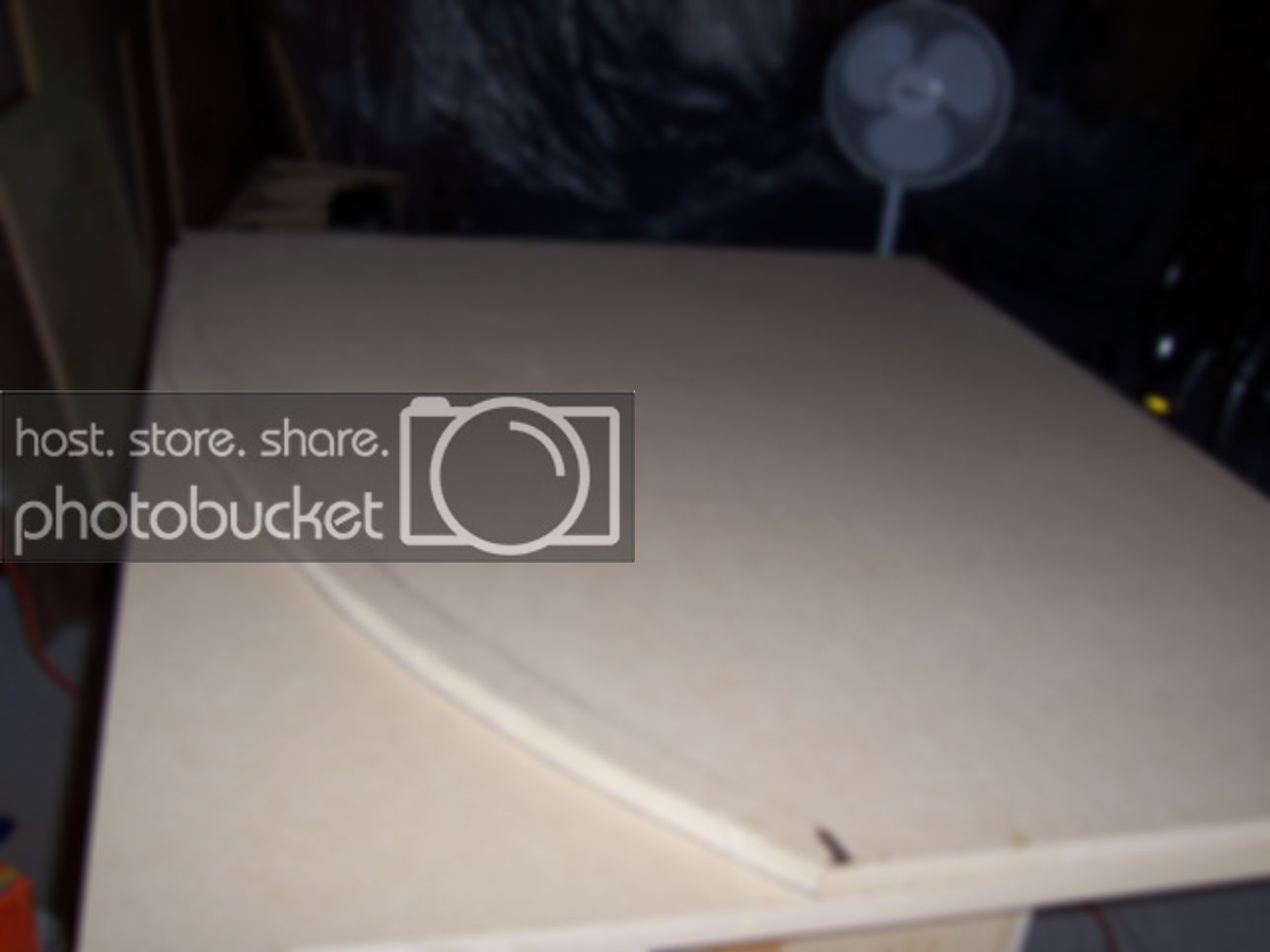

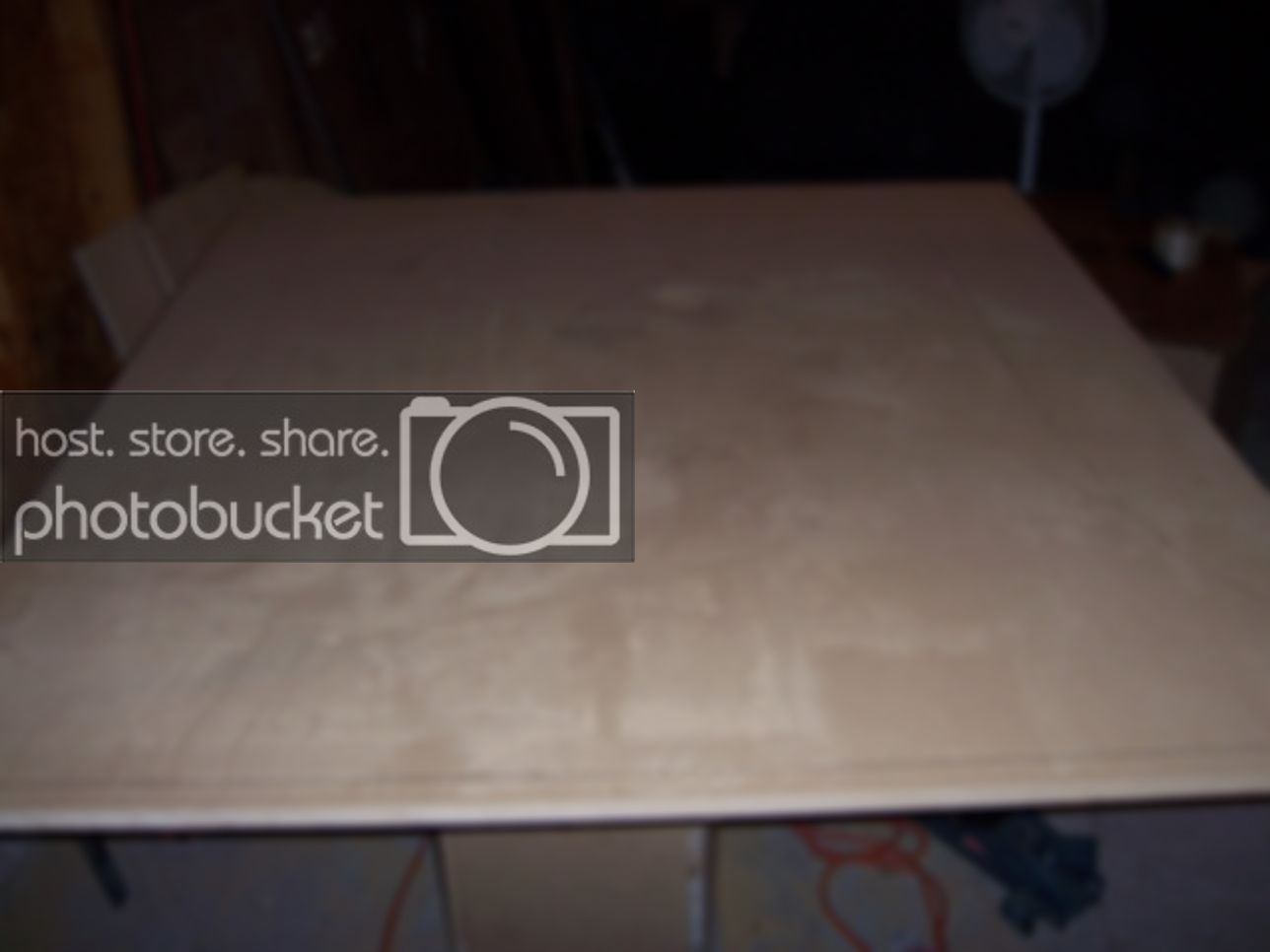

the new and improver larger bottom piece.....it started out 57x36, and pretty much stayed that way. this is the piece that gets bolted to the car inside the trunk, with lots of mounting hardware.
If you can see the lines there, thats the countour that i cut it as to fit my car.

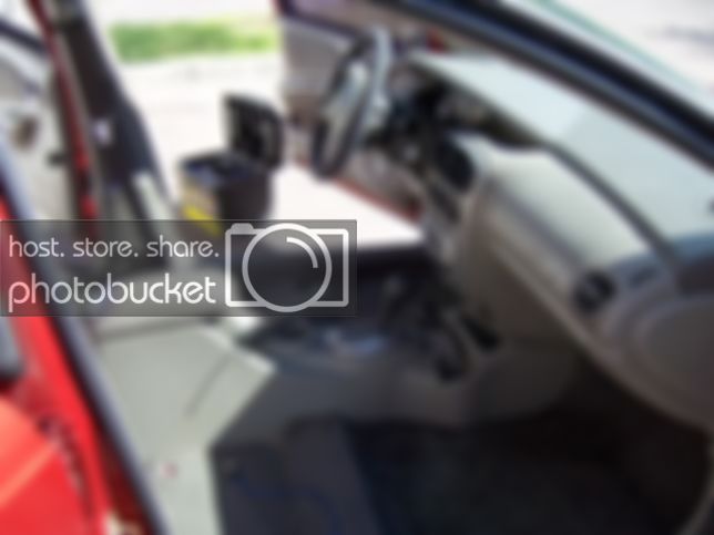

Front seats had to be taken out, in order to have any room to work with, whatsoever

heres the first side piece, I cut it using the cardboard template, but as you see the second line on there, i had to trim it down a little, to allow for the second, unplanned bottom sheet.
traced the second one from the first, as it makes things much easier.

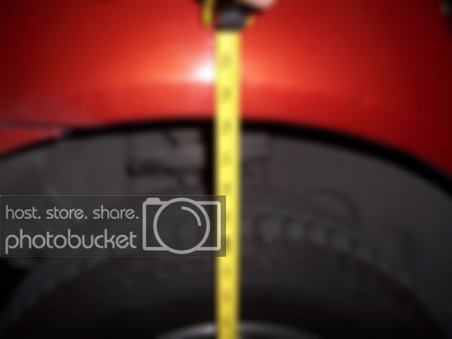

Original ride height, just over 28.25 inches
