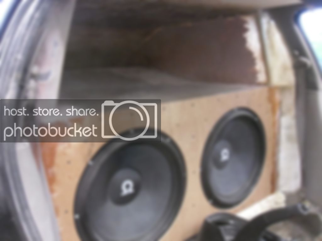

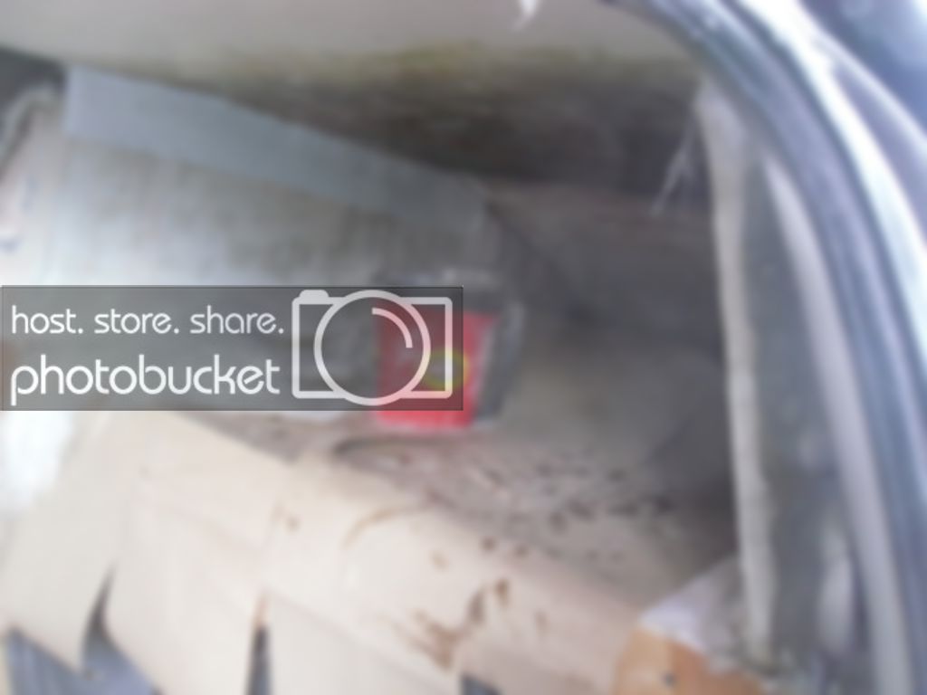

More layers onto the top..

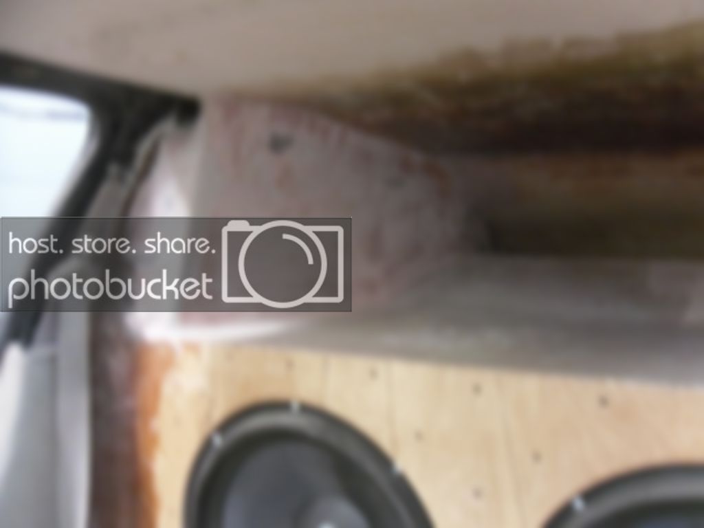

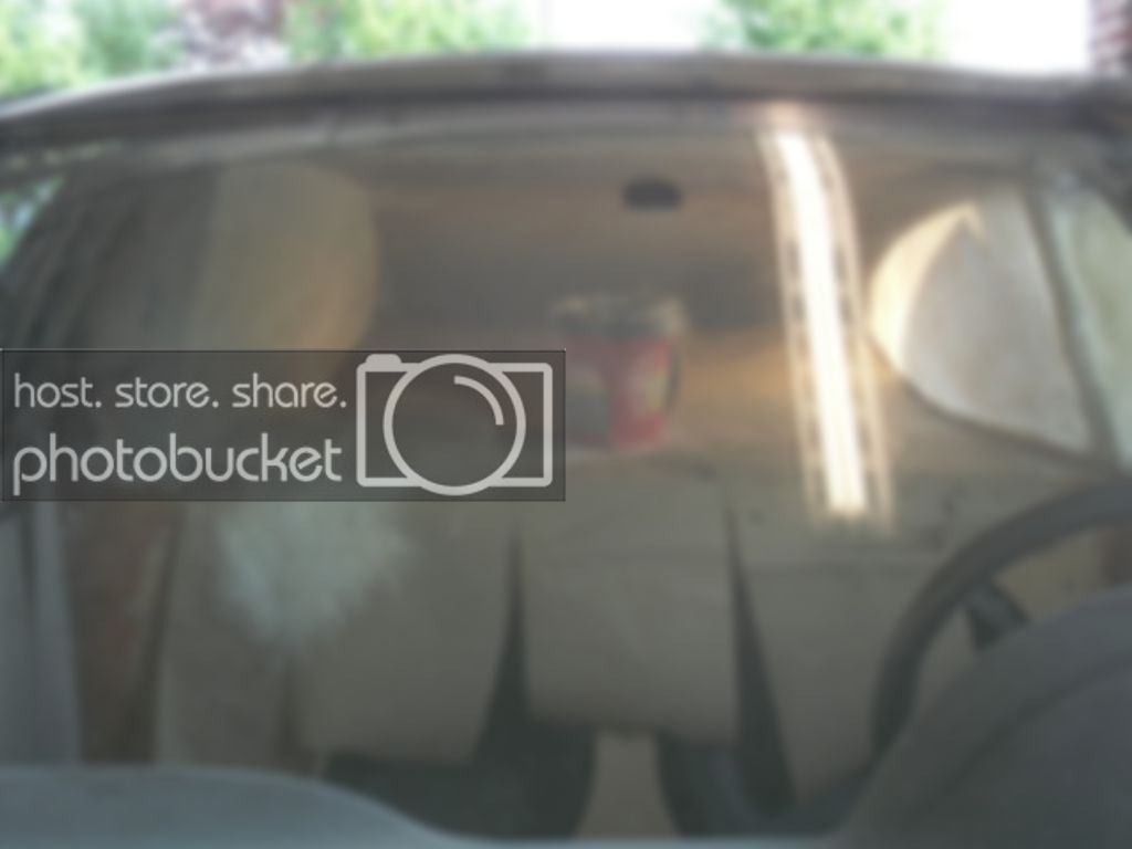

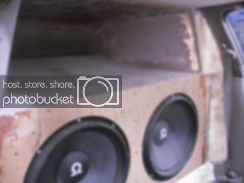

And I got some more layers put on the drivers side front of the horn/seal plus more sanding/body filling...

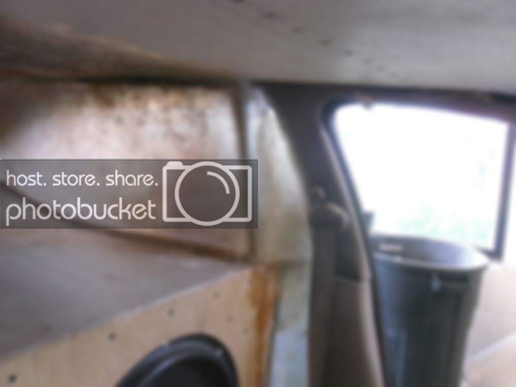

Filler on the side...
A bit of sanding and filling...didnt bring the filler upto the front because the glass was still curing at the final curve over to the seal..
