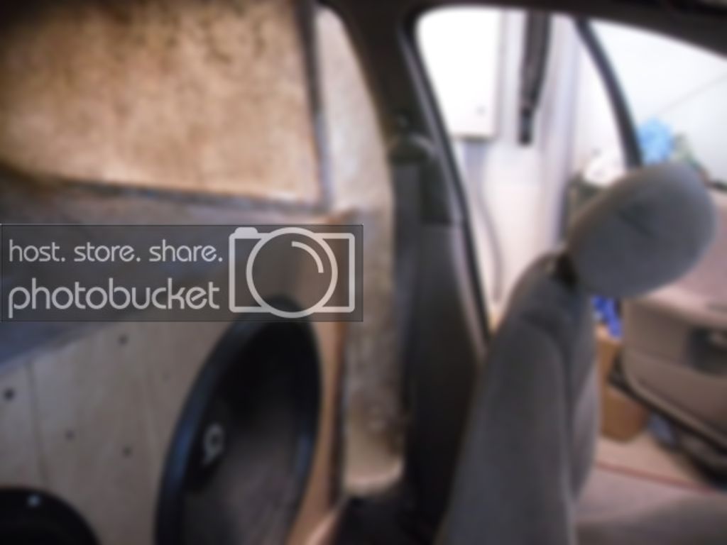

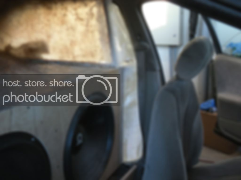

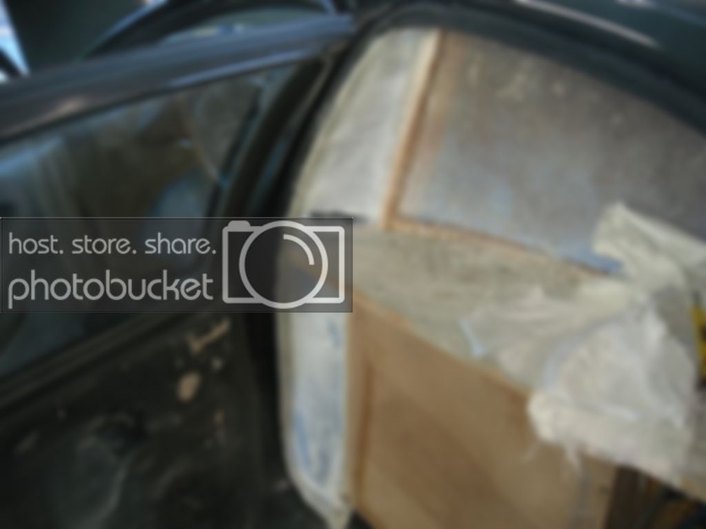

Got the other seal/mouth of the horn started up today...
^One layer of mat over the cloth to get it rigid for more layers. More when it happens...

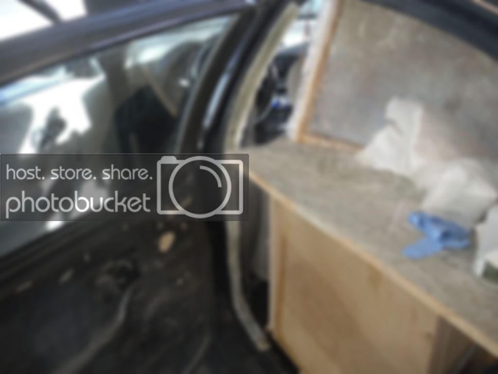

Yea, theyre rounded. And I have 2 more gallons to run through just building up the sides and ceiling //content.invisioncic.com/y282845/emoticons/smile.gif.1ebc41e1811405b213edfc4622c41e27.gif theyre going to be very strong and I probably will get small ropes to run along points to put curves in the glass on the backsides for more strength. And then I plan on deadening the backsides with spectrum but havent finalized that thought yet

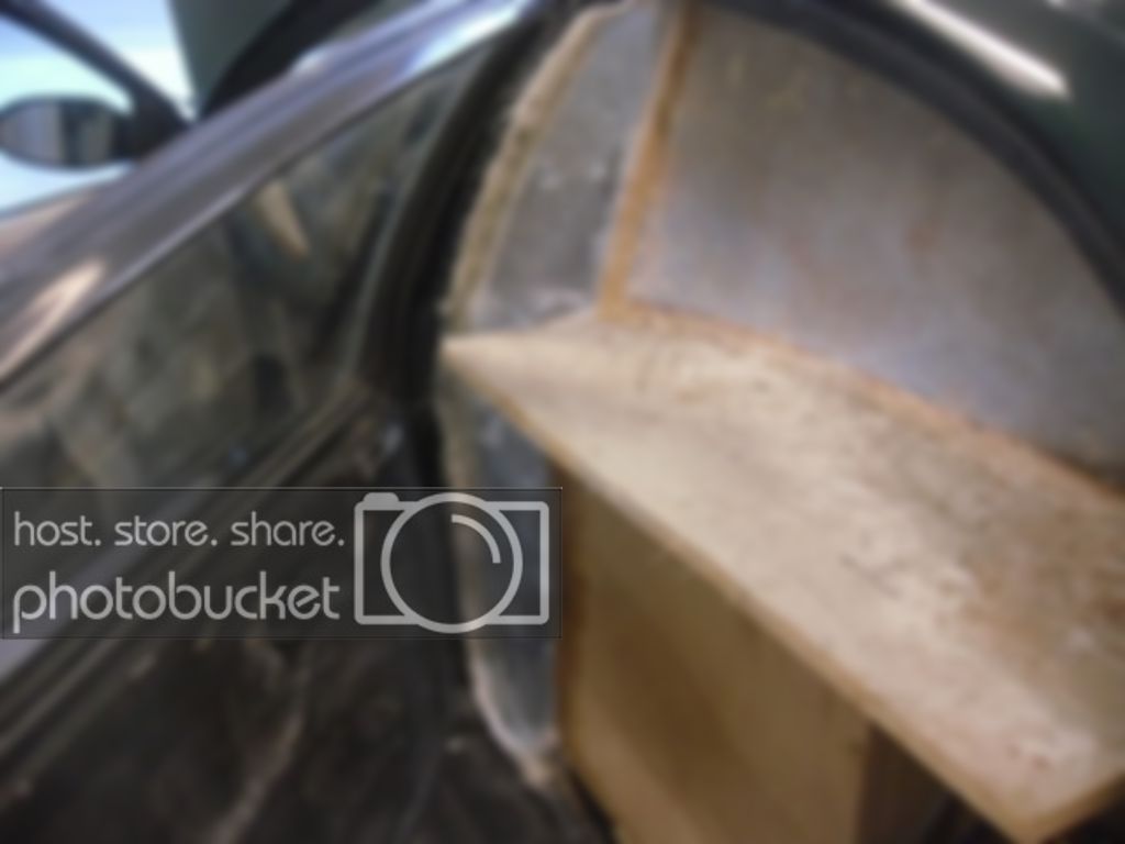

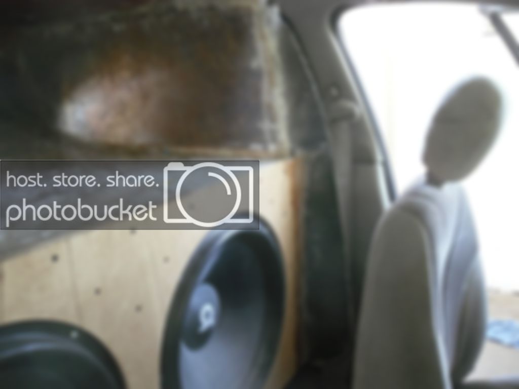

Any pics of how your gonna seal it to the ceiling???
The top continues all the way to the windshield...it is the ceiling //content.invisioncic.com/y282845/emoticons/wink.gif.608e3ea05f1a9f98611af0861652f8fb.gif lol

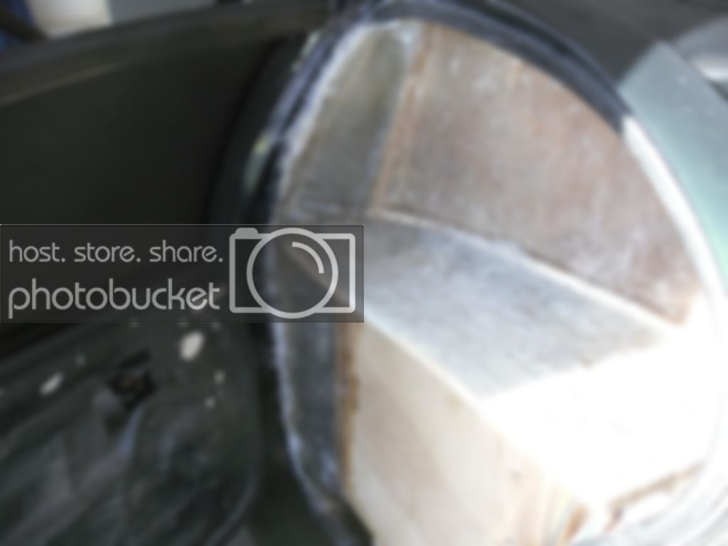

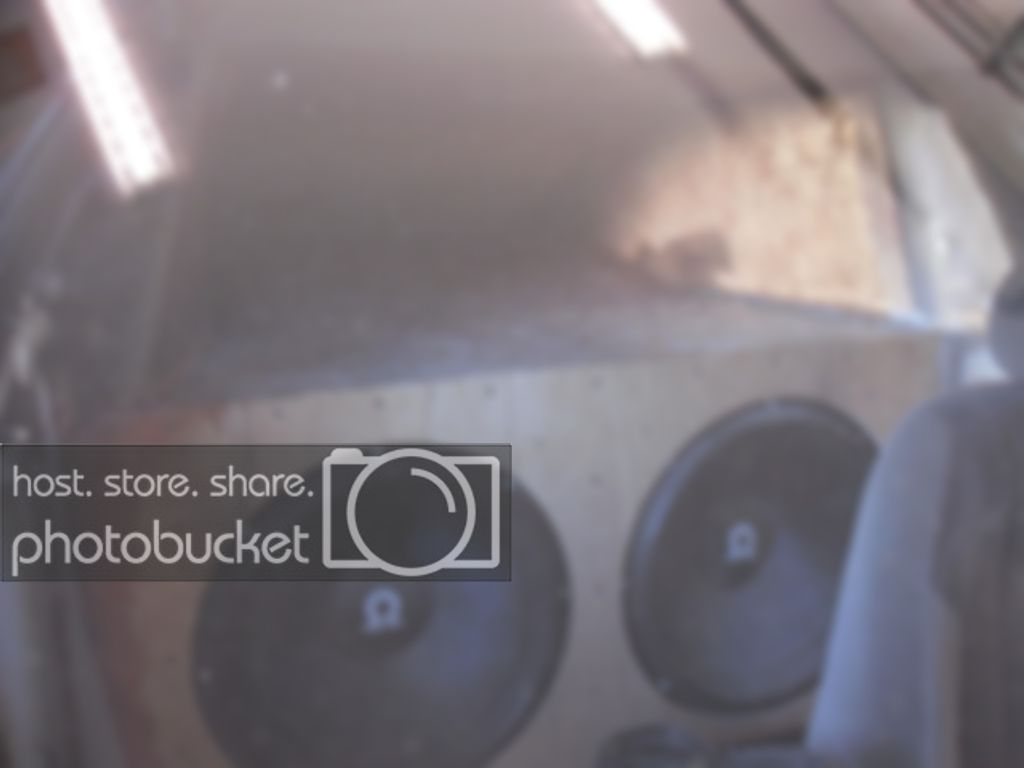

And today I got the other rear window blacked-out and more layers on the drivers side seal/front of the horn...
