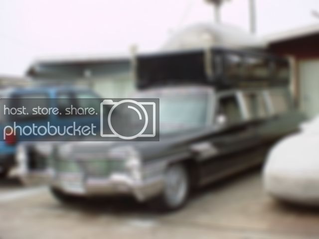

'Twas in looks, a giant coffin made of a bubble solar roof 4'x10', there was neon lights under all the side bubbles. Roof was completely cut out so you could stand, it had even once had a stripper pole. Skulls, arrows,text that said "fantasy zone" by the side entry. Was originally built and rented as a disco in back of a hearse limo. Chasing leds on parquet floors, etc. Laying on the floor in back and looking up it was just like laying in a coffin, inside were mirrors and velvet. Fog machine, lasers, bubble machine, a rolling party. Stupid me quit drinking within the first year I got it and all of a sudden it wasn't so fun driving around with a car load of drunk friends! Kept it 4 years. Got pulled over a lot by curious cops, some recognized its pimp potential and when my license was suspended for child support arrears, one who pulled me over hoped to seize it from me. He used to drive by my house daily and park up the street if he saw me washing or wrenching it. Funny, his beat was 6 miles away. Many people got just stupid around it, one guy followed me about 100 miles on a trip home from Vegas, staying in my blind spot, just staring.

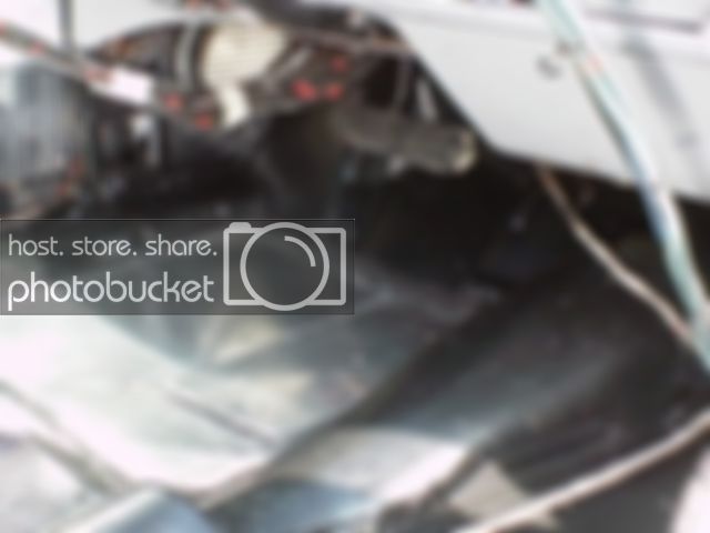

Had two sound systems , front setup would have been very competetive in IASCA pro 601+ SQ in the day. Spent 2 months on the mids in the kicks alone, 8s where the cowl vent air enters with birch ply pre-glassed then rivited with aluminum extrusion inside, glassed together again then fully lined with modeling clay then coated with sikaflex to keep the clay in place. Veritas aluminum horns on piano hinges under the dash attached to the now unused vent sliders for angle/height adjustment. what made it was the sheer size of the front cabin and speaker placement, the 8's were same distance to listener as the horn driver outlet almost to the inch.
You can see the 8's up in the kicks, I had to cut out the old rusted floors here.
