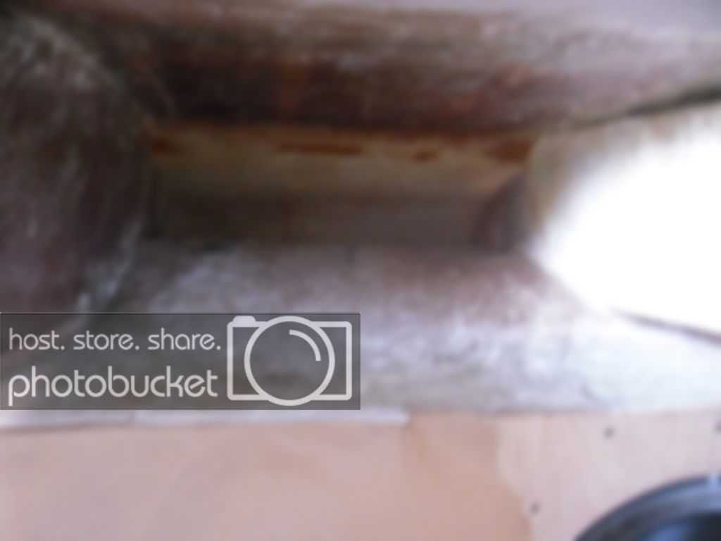

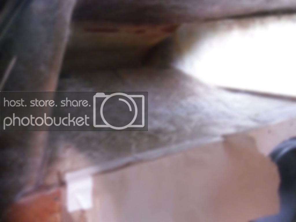

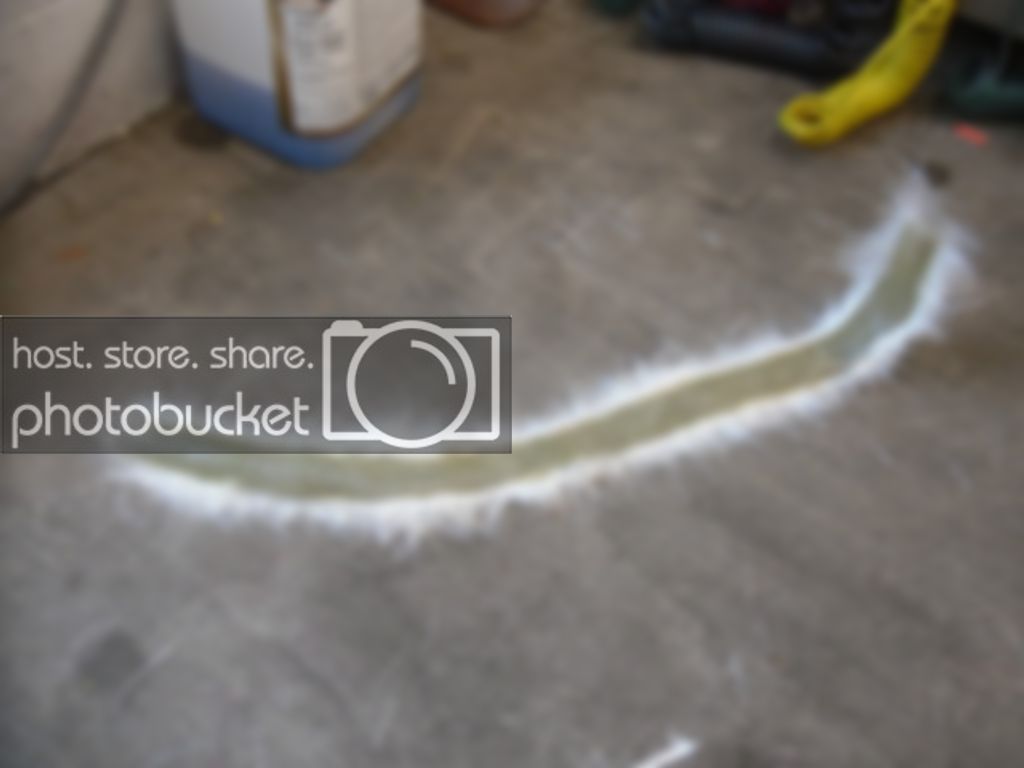

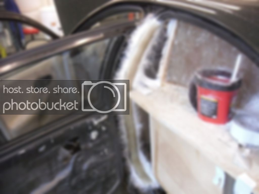

And I got a bit of work done today. I got the passenger-side of the horn built up a bit near the end of the flare to smooth it out. I also got the driver-side seal piece molded up..
Also are you building these seal pieces to simply mould right into the horn with glass?? Like this in the pic?? Im curious how your gonna tuck it into the door seal or something?? Just curious as I have a wall build coming up and that seams like a good way to seal the sides
Go back and check out the other side's seal...thats how I plan on doing it lol. I attached it to the cars rubber seal with a silicone adhesive and then fiberglassed over to it to form the seal, like you discribed (i think, minus the tucking into the seal part)
hmm just glued the fiberglass right to the door seal... I would just be worried about the door sealing but you probly already made sure it cleared, thanks for answerring, Probly wont work in my situation though
