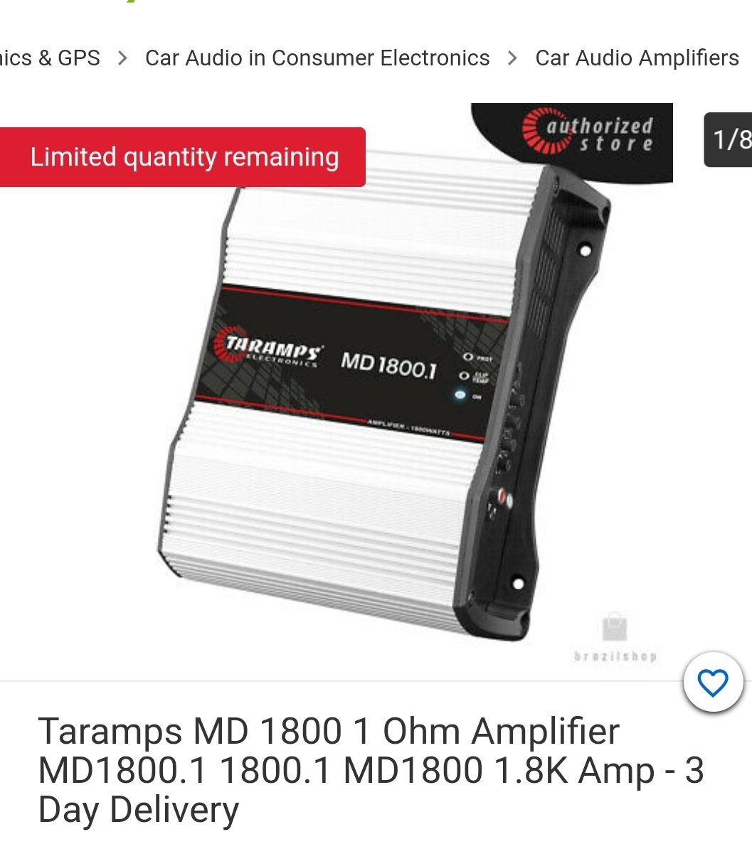

This should work on your stock electrical.
