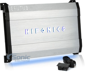

This is your amp correct? Shows a single 60 amp fuse and fuse rating of 60 amps. That's not much at all for a stock electrical system plus on music it will draw much less than 60 amps.
Weird. But you will never see a 120 amp draw on music. If you played a 40hz sine wave at 1 a ohm resistive load at 14.4 volts you might. But on music you never will.
Even if wiring to 1 ohm were to be too much power its as simple as turning the gain down.
So I wired it to one ohm and it has come to life now, and according to my car it never drops below 14.3 volts, I have the gain less than halfway and bass boost off and it sounds great
