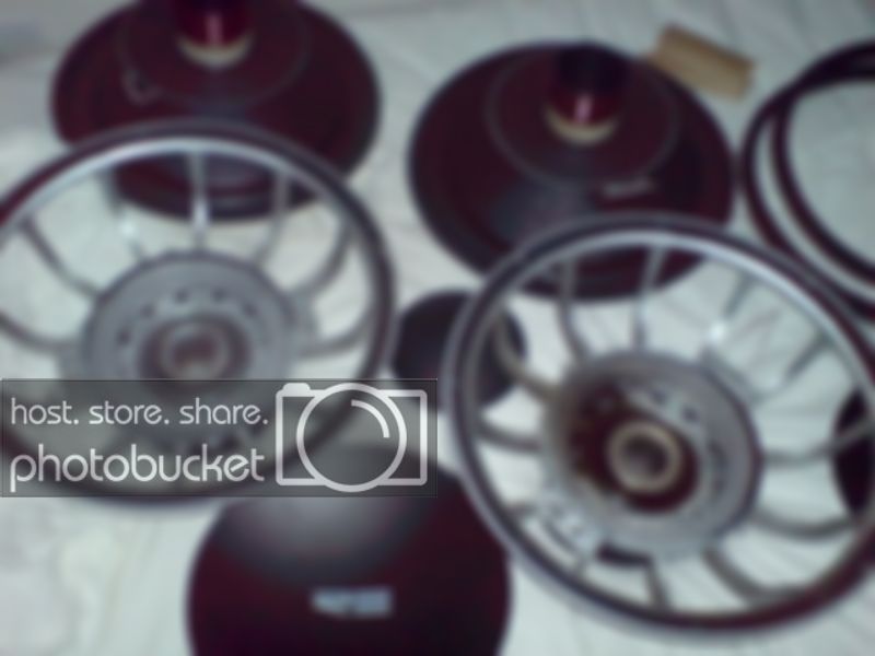

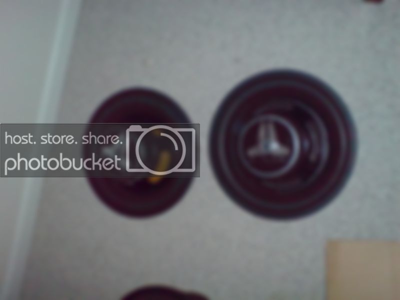

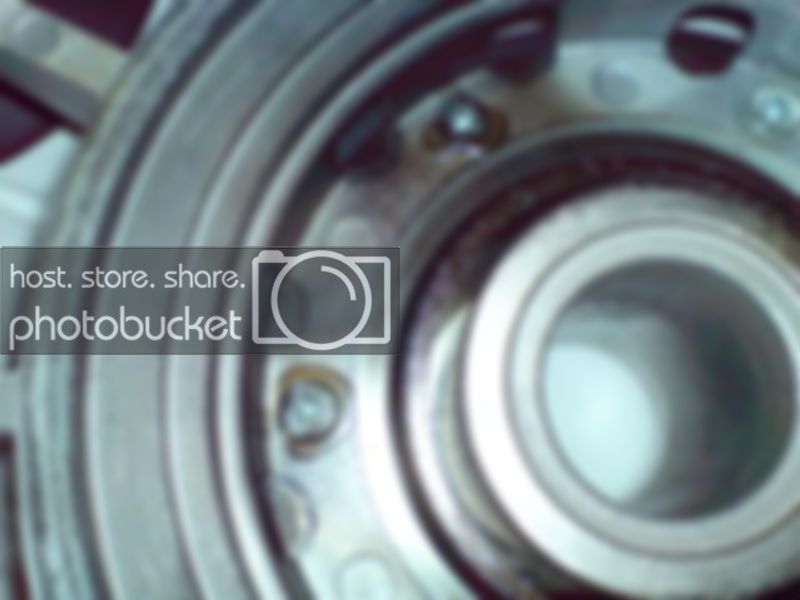

more carnage pics...
they actually make the room stink like vc just sitting in there...
here's the recones i just got from teampsi...
i'm glad i could save the inverted dustcaps off the old ones since he didn't send any with the recone kit... i'll start on the rebuild friday...

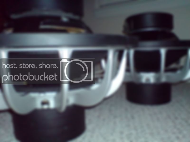

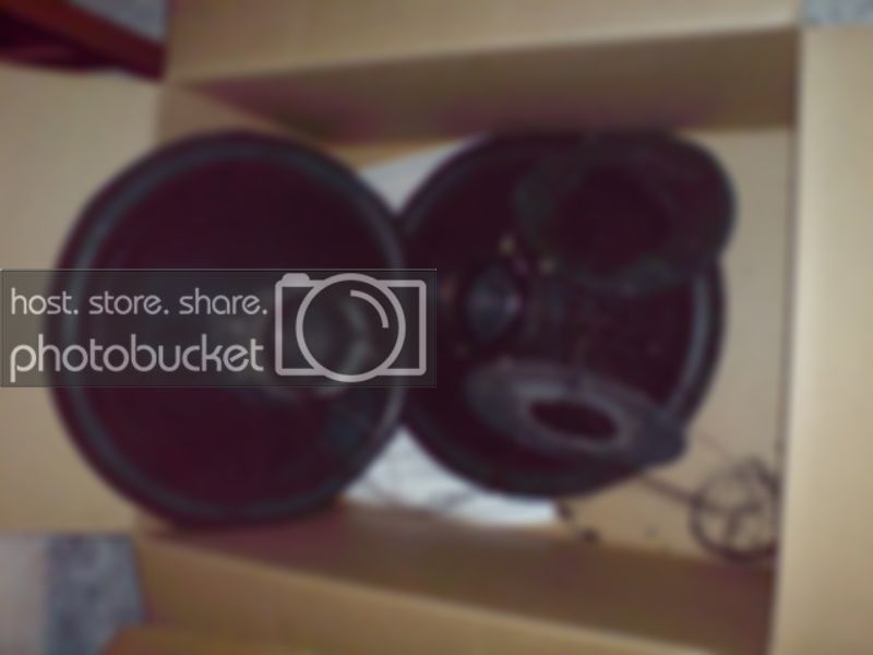

well for those watching i got them all glued up last week...
old 10w6s are perfect weights until the epoxy dries...
oops... i didn't line that up as well as i could have... but the epoxy cures within a couple minutes and i didn't have any extra //content.invisioncic.com/y282845/emoticons/crap.gif.7f4dd41e3e9b23fbd170a1ee6f65cecc.gif not a big deal though, the tinsels are plenty long enough...

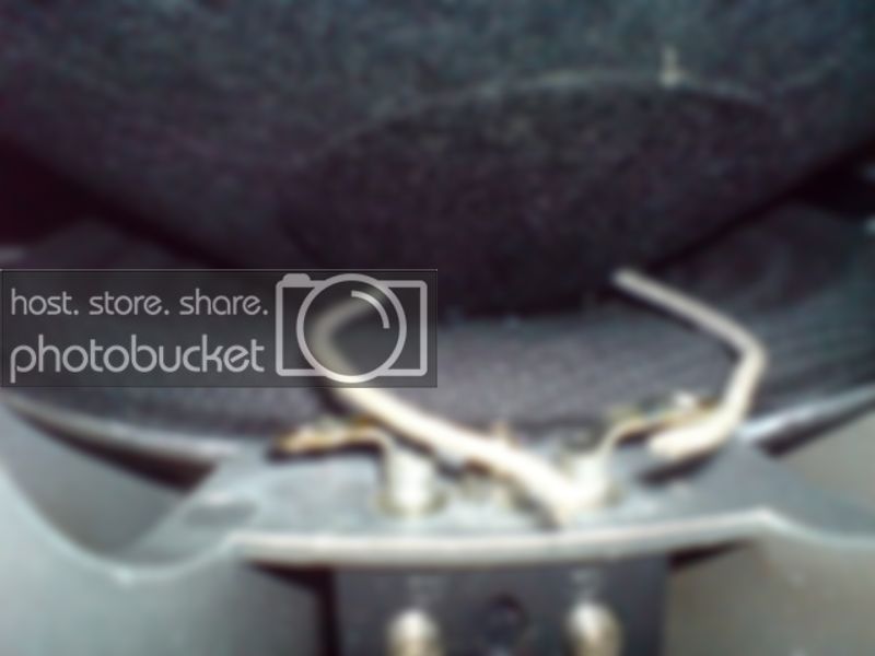

i had a little bit of trouble soldering the leads since i didn't have any flux but i got r dun...

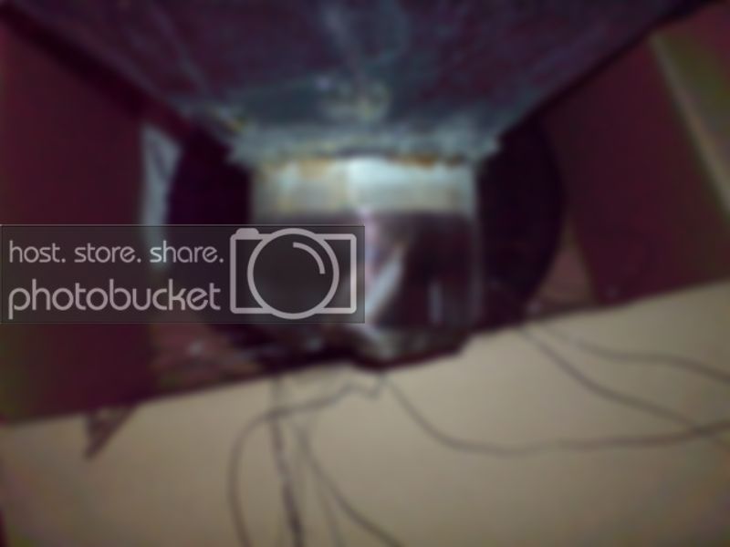

one issue i have is that teampsi didn't include the voice coil caps to install inverted dustcaps with my recone kits. my question is, do you need them? or is the inverted dustcap not rigid enough for all the back pressure created through the pole vent??
