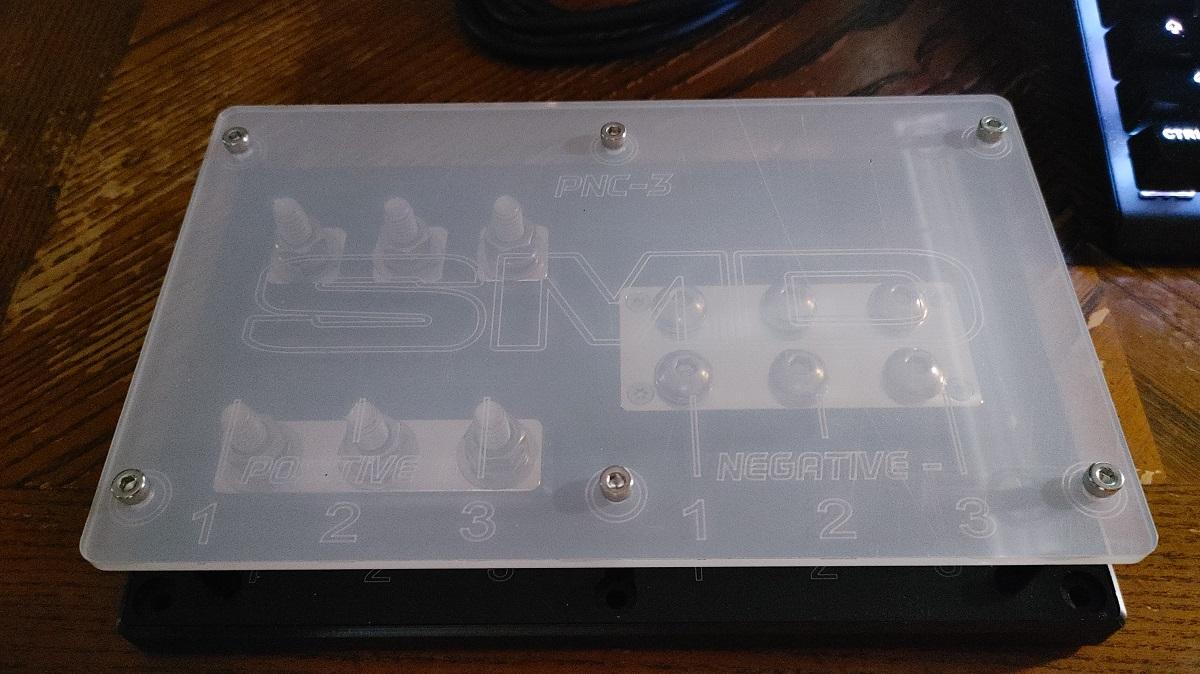

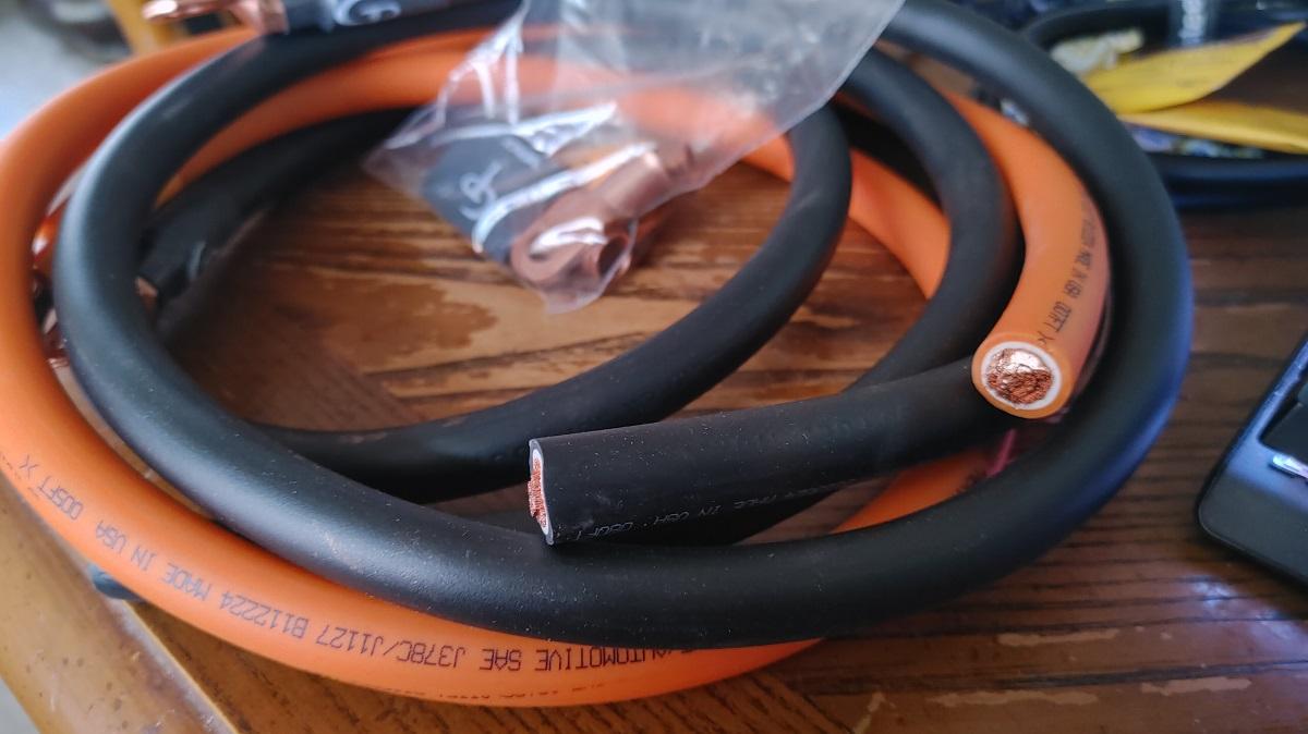

I also just purchased the SMD 3 slot fuse distribution block with grounding block, 3 pack of 200a ANL fuses, 3 pack of 80a ANL fuses, 3 pack of 60a ANL fuses. This will cover all three amps. I also ordered the GP audio Big 3 in Orange and black. OFC of course.

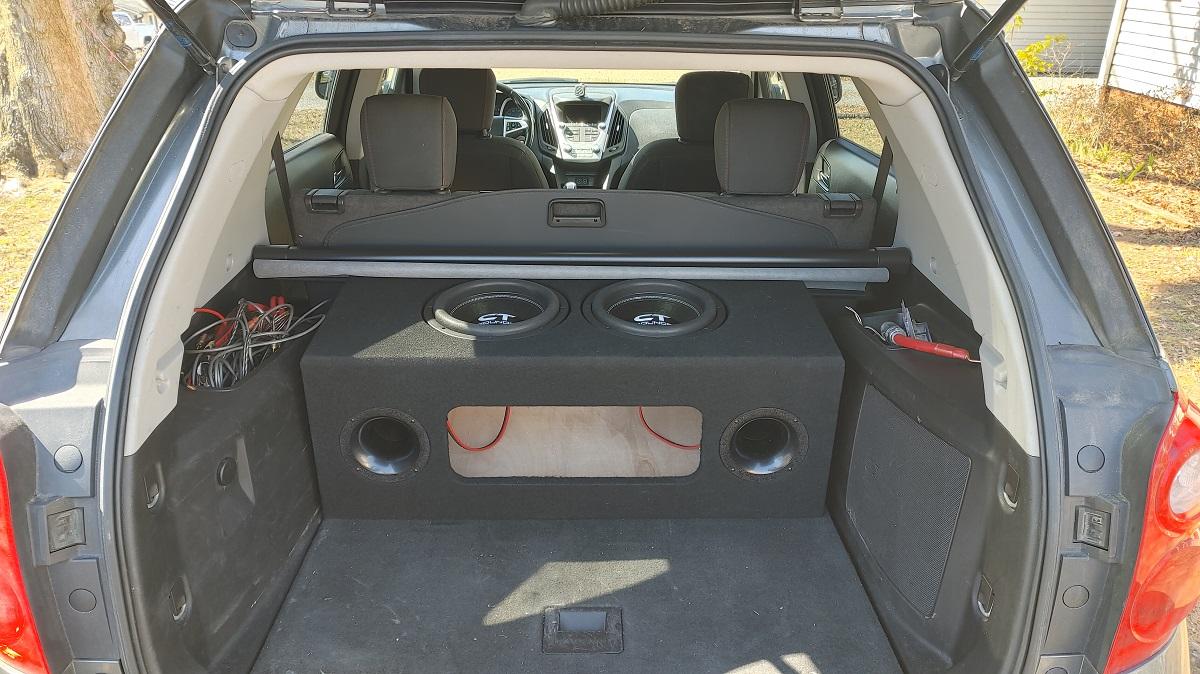

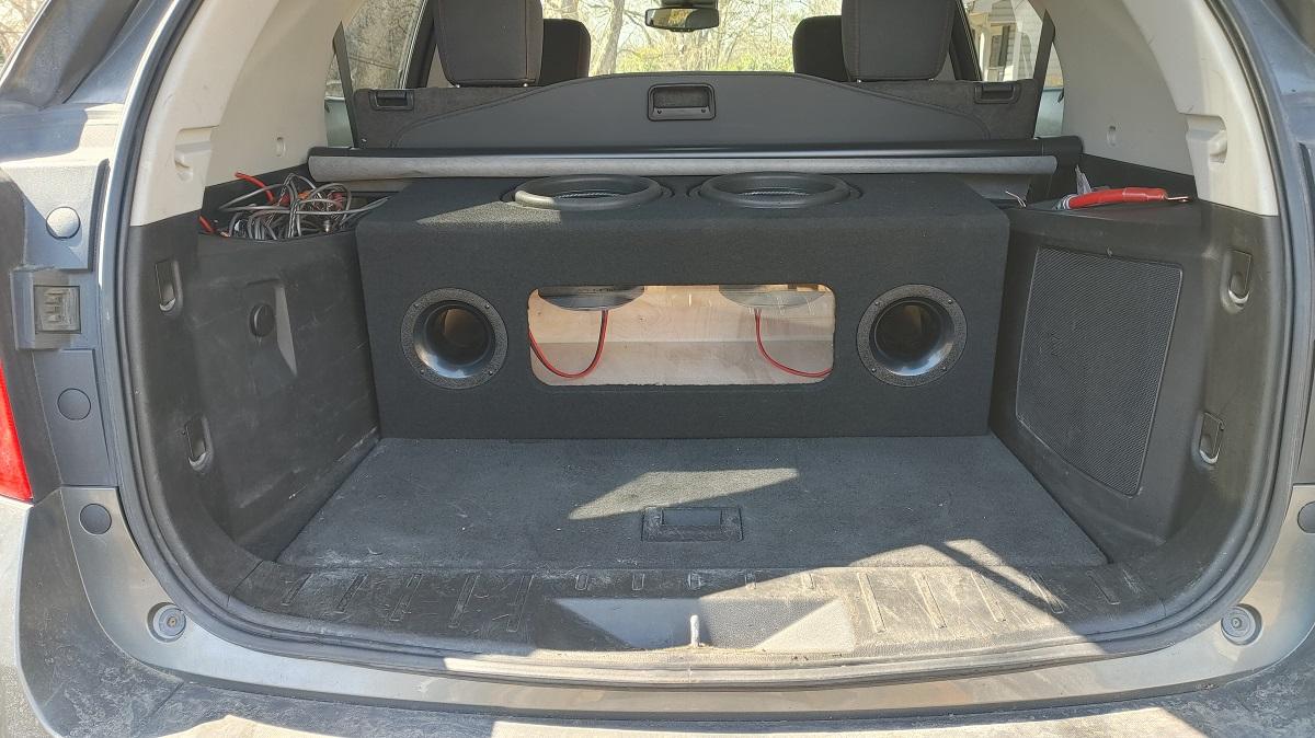

Thank you to Tyler @ Concept Enclosures. They had a model of enclosure that I liked with the right tuning and dimensions to fit the Equinox cargo area. I wanted subs up and ports to the rear. This is the enclosure they offered so I asked them to make the openings for the subs fit the Tropo XL 10's. We came to a good price and it got here quickly. I am MORE than pleased.
