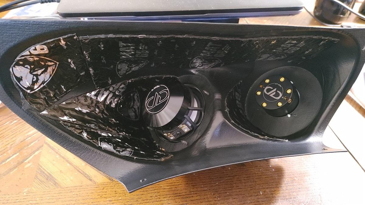

It is still cold outside here in Concord, NC and my MAT 66 is not even remotely sticky. I prepped the inside of the A-Pillar pods with rubbing alcohol (91%) and dried them. The only way to get the MAT 66 to adhere was by heating the deadener in the oven. Onward!
They are deadened. No vibrations or resonation that I can feel.

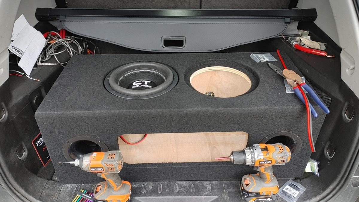

I have them both installed and wired @ 2ohms each sub so the amp will see 1 ohm. I would have taken a few more pics but the parents asked me to go to supper with them. Chineeeeese buffet. Oh, I pre-drilled pilot holes before screwing down the subs with #8x3/4 screws.
