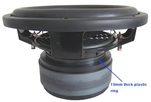

I found the only way to kill this sub within reason - bottoming it out. So, we are going to re-prototype with a few changes to make this a near impossibility (and a few other minor things):
1) Adding 10mm to magnet stack
2) Moving vent holes closer to the pole by 5mm
3) Making the coil 5mm taller and increasing pole extension as well
4) Creating a plastic spacer ring under the basket
This makes total x-mech 33.75mm vs 26.25mm now.

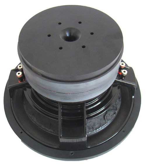

Are you going to dress up the magnet a bit before production or leave it raw as is? //content.invisioncic.com/y282845/emoticons/confused.gif.e820e0216602db4765798ac39d28caa9.gif
Raw most likely - I suppose I could make a magnet boot but 99% of people will never see the back of the woofer again after installed.

Just these things:
1) Adding 10mm to magnet stack (for more x-mech primarily, FEA shows very slight increase in motor strength)
2) Moving vent holes closer to the pole by 5mm (if the magnets are slightly off by even 1-2mm at current spacing they can block air flow, accounting for production tolerance)
3) Making the coil 5mm taller and increasing pole extension as well (since I have so much rearward x-mech I want to make it harder to jump the coil forward too)
4) Creating a plastic spacer ring under the basket (the pole was getting too close to the dust cap, it could potentially smack the cap with increased x-mech) - this is also why I used a bubble cap in the first place.
Thanks for the comments //content.invisioncic.com/y282845/emoticons/smile.gif.1ebc41e1811405b213edfc4622c41e27.gif I am pretty excited about it - the cap will be exactly the same except with "Sundown Audio" on it.
