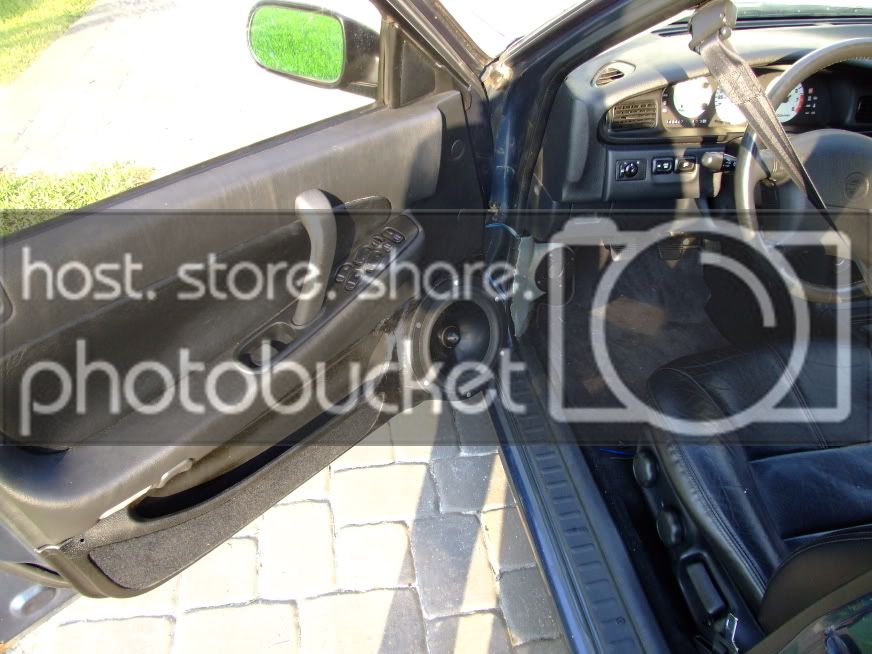

Teh Teebone door pod worklog
mounted the props to the baffle. used a lot of hot glue. these *****es aren't going anywhere
mounted the baffle to my mold
did a test fit with my speaker. all that is holding it up is hot glue and it doesn't even wobble with the speaker in.

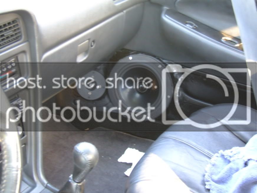

so I have a quick question on positioning....if you do BOTH door pods AND kicks, and your using components...would it sound alright to put all 4 tweets on the dash? If not,...where would you reccomend placing them?
your running 4 tweets? i was originally gonna run some xxx mids in the doors, some midranges and tweet in kicks but scaled back and i'm just gonna run a set of comps

mounted pod to the material
stretched the material. this is where i ****. got some wrinkles but hopefully with some sanding and bondo, i can smooth it out. not to worried about inside the circle
excess cut away
very good so far the only thing i think could improve is the speaker baffle, what did you use to cut it out? i don't think i've ever seen this exact technique used but it looks like it's working quite well for you.
i freehand it with a jigsaw //content.invisioncic.com/y282845/emoticons/smile.gif.1ebc41e1811405b213edfc4622c41e27.gif
yes...4 tweets...2 sets of comps...i think all 4 tweets up on dash will sound better though...but the other 2 are in the kick...dont want to take em out.
lookin good man...keep at it. I want to try some in the near future
id love to hear how you t/a that and how much distortion it has.
suggestion-take the tweets out of the kick and leave the 2 on the dash or vis a versa and see how much better it sounds
