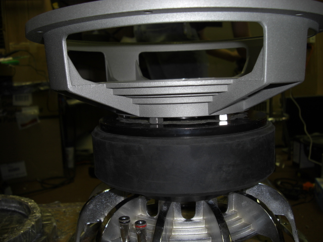

speaking of tc9 motors haha. here is my lil fun project.... camera phone FTL
black tc9 motor on an 18" basket. going to be getting a re-cone from David next week.
basket will be painted a dark red
edit: haha 4 got i plan on giving it around 1200-1300 daily. we will c! lol

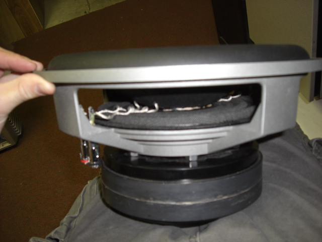

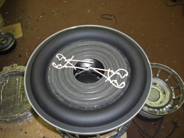

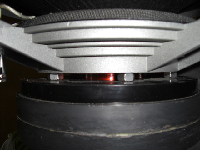

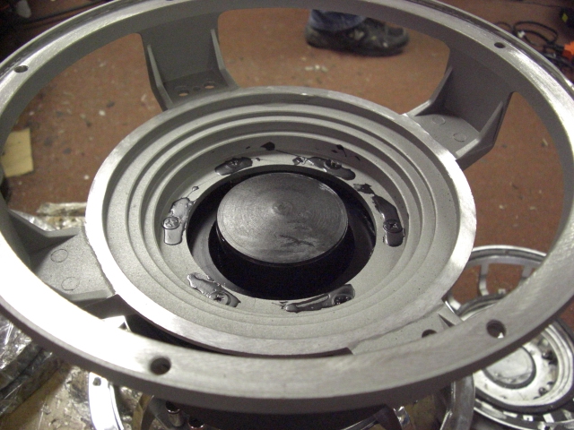

* Plastic plug w/ dome shape - I have some aluminum ones I am working on
* Stainless steel nuts for spacers
* Cone w/ rubber surround and dual medium spiders for a low Fs

All done!
I broke it in for 2 minutes or so to measure specs. It will break in quite a bit more over time - I predict the Fs will hit the high 20s and Qts will get at or near 0.40 or so.
RE: 3.58 (series)
Fs: 34.2 Hz
Qes: 0.53
Qms: 6.22
Qts: 0.49
Le: 3.5 mH
VAS: 26.7 L
BL: 18.45 N/A
Cms: 91 uM/N
Mms: 236 grams
(BL^2 / RE = 95)
Very nice numbers. I was surprised by the low compliance number, I wasn't expecting it to be so stiff. You were probably shooting for a small Vas though I assume. I'll bet that's going to sound great.
