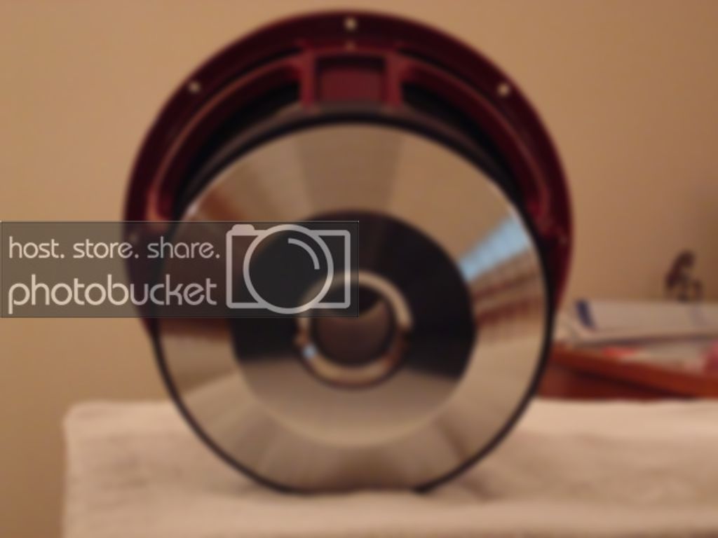

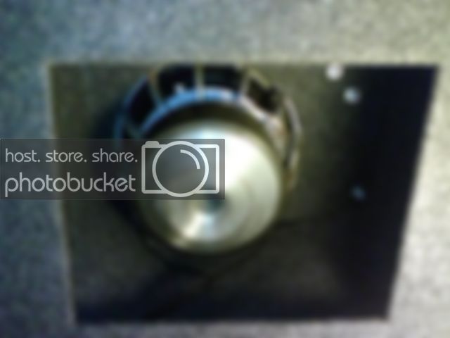

So I have a 3HP with an 8 layer aluminum flatwind which is 75mm tall. You're saying if I plug the large pole vent I should see an increase in thermal power handling translating into a lack of thermal compression if I decide to do a burping setup?
And if I just plug it and don't do any burping, wouldn't that sound like as$ for listening music?
I am building a TC-9 now with a pole plug and an 8-layer FW coil //content.invisioncic.com/y282845/emoticons/smile.gif.1ebc41e1811405b213edfc4622c41e27.gif
i may have to buy another tc-9 from mr. fuller now //content.invisioncic.com/y282845/emoticons/veryhappy.gif.fec4fed33b4a1279cf10bdd45a039dae.gif
it wont have the same effiency but with severals spiders ur fs goes up anyway. fill ur pole vent with coldroll and ur Bl will go up as well.
i expect pix jake!
i have never used a 8layer coil before i normally mess with subs with a tight gap. tighest gap frankin sub i have built i blew at a show last sunday. top plate measures 2.208" coil was 2.155. i beat it hard daily for a month then friday did 50+ burps getting it louder. then sunday it was cold not even 50f outside i did a full tilt burp with it cold and it rubbed hard,lol.
yum
Well with basket spacing, a pole plug and aluminum flatwound coil I don't see 1500 watts rms being that far of a stretch and 2000 watt burps I have no pole plug no basket spacing and a copper round coil and I run 1200 watts rms.
i'm gonna see how it likes 3k,lol. i built se 10" that will handle 1500rms daily and 2500 burps. it sounded better and was 2dbs louder than stock.
the 10" i killed at the last show i gave it 3k allllll day and it never even smelled. i also had a alu cone and dust cap and the dustcap i made to glue to te cone and former for better cooling.
