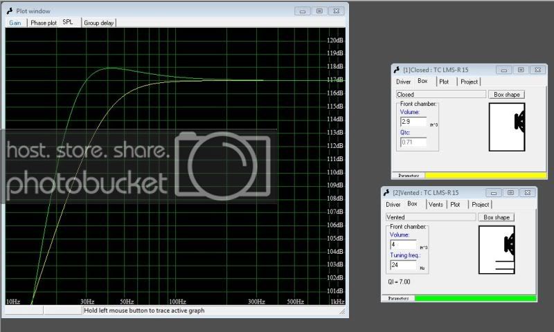

Here's a sealed box at the butterworth config, vs the box plan I have in mind. The difference is quite profound. ~5.5 db. difference at 30 hz. and ~4 db. at 20hz.
I may end up building another box tuned higher eventually, but I'm starting very low since my car is tiny. I know the larger the car the more cabin gain you'll get. I don't have that luxury.
looks peaky, just like a ported box should. Doubt if that 4db gain at 20hz is really usable though. Looks cool though, hope you enjoy it. TC does make some good subs even with a wackass owner.
Explain why it isn't "usable". I've learned a few things about car audio in the past but I've never been schooled in the art of analyzing winisd graphs.
It was my understanding if the curve is higher on sub X vs sub Y at any given frequency, it then sub X will always outperform sub Y at that frequency.
